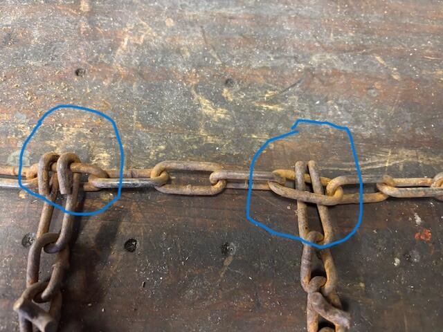

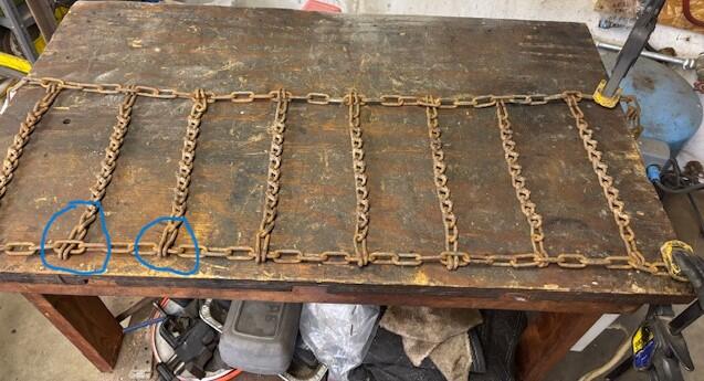

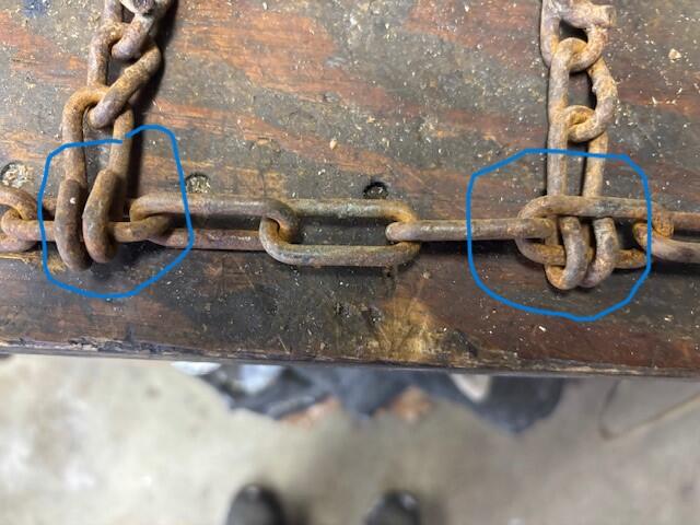

56servi 59 #1 Posted December 13, 2025 I am trying to install a set of used tire chains on my 23" turf tires. the cross chains do not hookup to the side chains the same on some of the crosses. I have tried looping the end of the chain back thru the cross chain that is different but did not work. On the closeup pictures the open end of the cross hooks are both facing up Hope the pictures show what I am talking about Share this post Link to post Share on other sites
gwest_ca-(File Mod) 11,981 #2 Posted December 13, 2025 The end hook on the right in the first picture is correct but rotate the side chain 1/2 revolution. That puts the hook on the side of the link closest to the crosser/tread. Ends of the hooks should be away from the tire sidewall. If you can get the end hook on the crosser fixed in a vise you should be able to pry the hook ends open enough to remove it from the side chain link. Install it correctly and squeeze together using the vice. They do not need to be squeezed tight - just enough to keep it on there. 3 Share this post Link to post Share on other sites

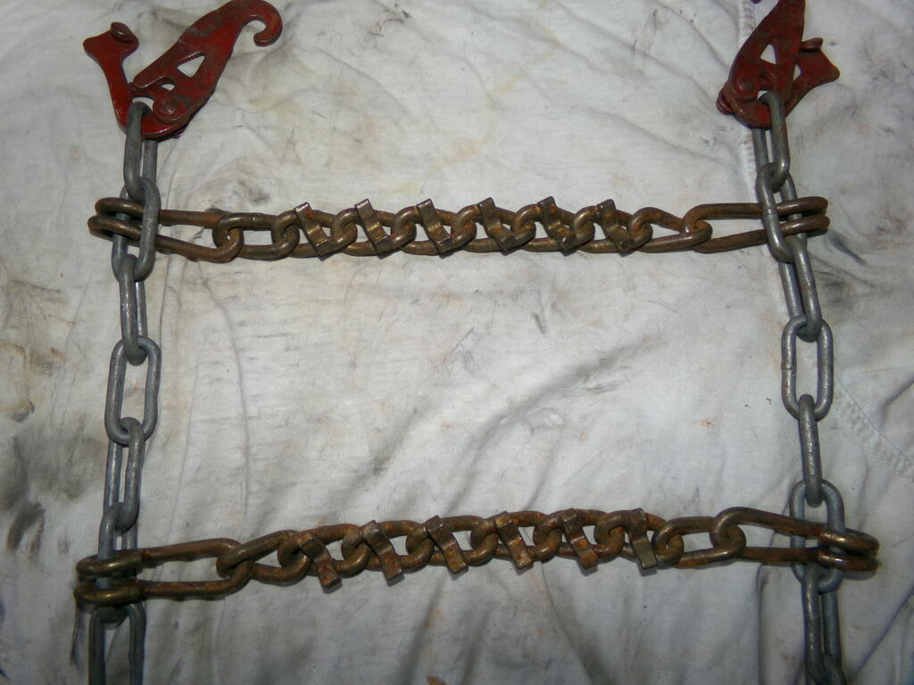

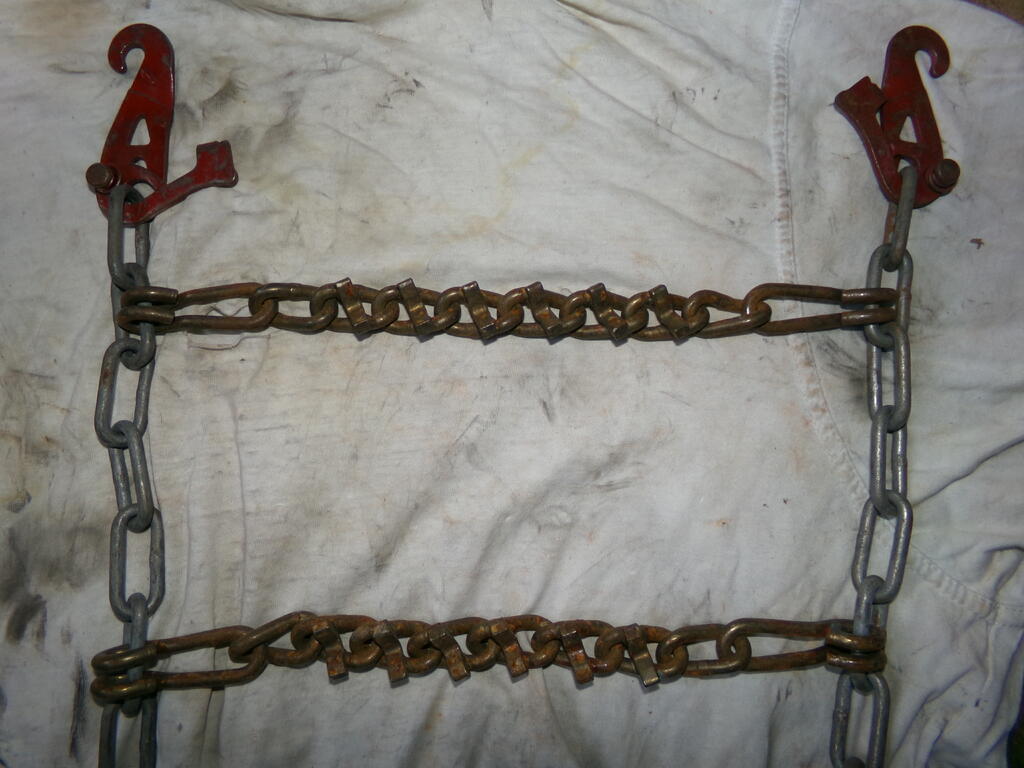

Ed Kennell 44,667 #3 Posted December 13, 2025 They will untangle. Start at one end and pass the short end thru to get cross chain #1 and #2 laying correct. Then continue with #3,4,5, etc. untill they are all laying correctly. Here is a correctly laying chain. And by passing the red hooks thru #1 and #2 cross chains, you get this. The same as your picture. The cross chains appear to lay correctly, but the twist is in the side chains. 3 4 Share this post Link to post Share on other sites

56servi 59 #5 Posted December 14, 2025 Is this what you’re saying to do. Loop red connector under chain and back out Share this post Link to post Share on other sites
Ed Kennell 44,667 #6 Posted December 14, 2025 23 minutes ago, GeneB said: Is this what you’re saying to do. Loop red connector under chain and back out Yes, that would correct the twisted side chains in my pic. I did the reverse to create that picture. It may help to hook the two chain ends together when you do this. If you pass only one side thru, you get a twist in that side chain and a twist in the cross chain. If you pass both sides thru the cross chain is not twisted but both side chains are. If you can't get them untangled, come to the Big Show in Pa. in June and I will fix them. Or sell you a new set for $20. Or, buy a chain plier like this. 1 Share this post Link to post Share on other sites
56servi 59 #7 Posted December 14, 2025 Going to try and untangle them tomorrow. Will post results thanks everyone for the help 1 Share this post Link to post Share on other sites
