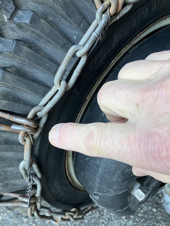

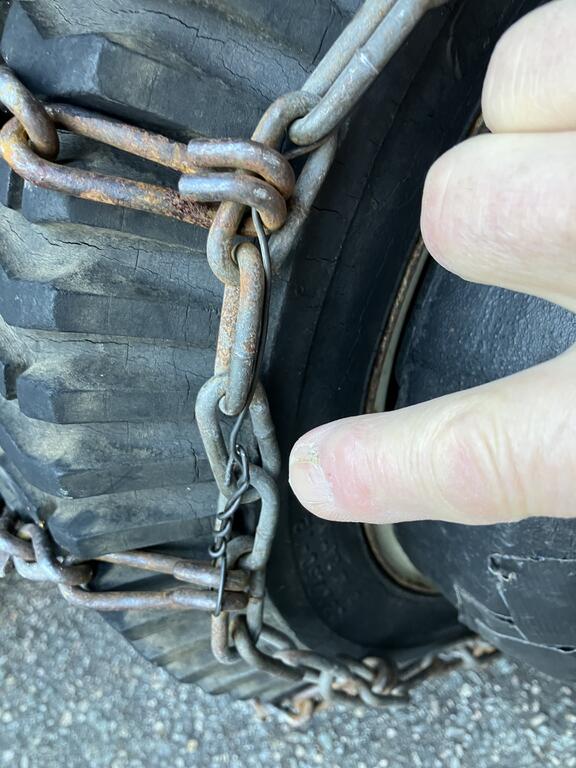

I used to work on Valves for aircraft and we used to do a lot of wire lock or lock wiring. So I had an idea to do this to the chains for the rear tires when you plow snow. I have to say it’s a lot easier. You have to get the wire as tight as you can. So far so good we had a storm last Saturday. It was at frozen big chunky stuff which turned into a ball. They worked well and they’re easily removable and installed a lot easier. I just thought I’d bring it up.There for link I had them why not use them. You don’t have to use the twister that people use when they do lock wiring. You can just use some vice grips. Give it a good snap when you’re making the first twist this will tighten everything up a lot better. I was using mechanic six gauge I believe they call it. Mechanics wire. Enjoy your day.
