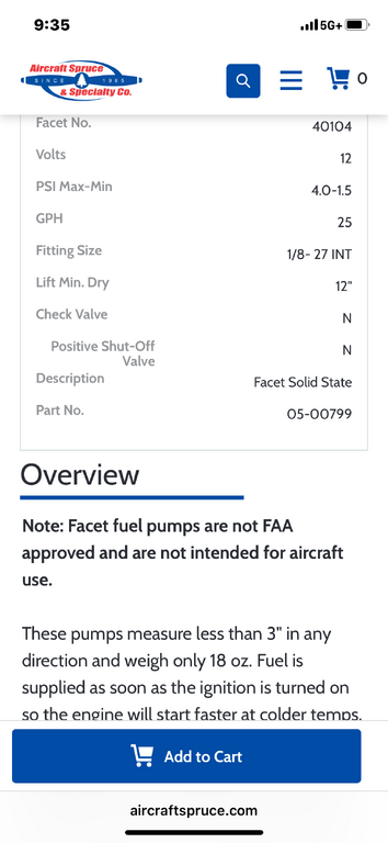

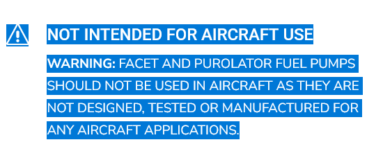

lynnmor 8,970 #29 Posted December 13, 2025 1 hour ago, Retired Wrencher said: These bar nun. Aviation class fuel pumps. I say good enough for aviation good enough for tractors. From the manufacturers website: 2 Share this post Link to post Share on other sites

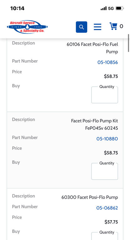

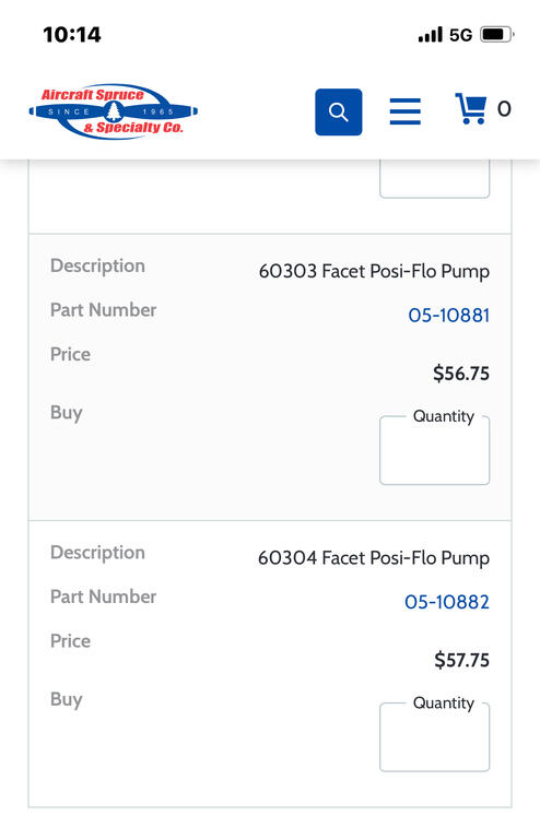

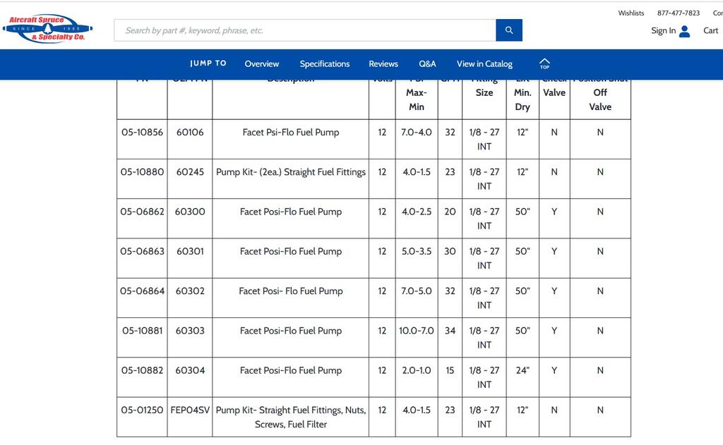

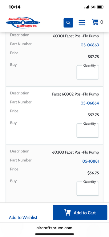

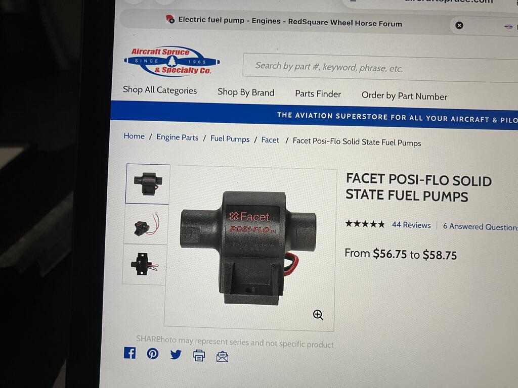

FLtractor 196 #31 Posted December 13, 2025 (edited) 3 hours ago, Retired Wrencher said: These bar nun. Aviation class fuel pumps. I say good enough for aviation good enough for tractors. Do you happen to have a parts number of exactly Which one would work with 856? They have 5 or 6 of these posi flow facet pumps on their website, not sure what specifics I would need for my tractor needs and what to look for Edited December 13, 2025 by FLtractor Share this post Link to post Share on other sites
pfrederi 20,992 #32 Posted December 13, 2025 42 minutes ago, FLtractor said: Do you happen to have a parts number of exactly Which one would work with 856? They also make a metal version https://www.aircraftspruce.com/catalog/pnpages/40163.php?gad_source=1&gad_campaignid=21281126779&gbraid=0AAAAADkVbL__TS7MQ04Lfqo3rPO-rAnCH&gclid=EAIaIQobChMIrtWyjuS6kQMVAVxHAR0hdh4XEAAYASAAEgLK8PD_BwE I have 3 or 4 of the black posi-flo pumps. never an issue over several years now. I am sure the metal one you found would work well also. i buy them because they designed and Manufactured in the USA actually Elmira, New York. 2 Share this post Link to post Share on other sites
FLtractor 196 #33 Posted December 13, 2025 32 minutes ago, pfrederi said: I have 3 or 4 of the black posi-flo pumps. never an issue over several years now. I am sure the metal one you found would work well also. i buy them because they designed and Manufactured in the USA actually Elmira, New York. Do you happen to know which one I need? These are all black plastic posi flo Share this post Link to post Share on other sites
pfrederi 20,992 #34 Posted December 13, 2025 I use the 60245 because it comes with fittings. Never had a problem with the 4 psi. Others prefer 60304 as it is lower pressure. Share this post Link to post Share on other sites
sqrlgtr 3,598 #35 Posted December 13, 2025 The plastic is what made me pick all metal one. the plastic one is probaly just as good or better but to each his own. Just remember you dont need very much pressure and consider your choice wisely . Share this post Link to post Share on other sites

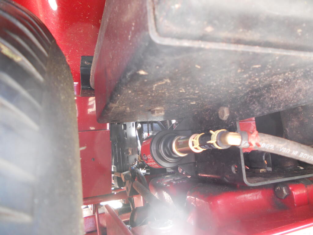

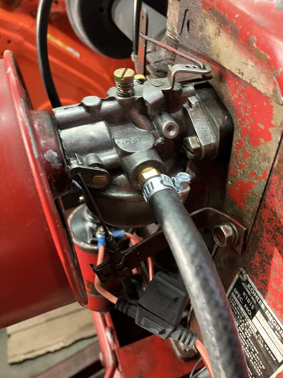

Retired Wrencher 6,902 #36 Posted December 14, 2025 (edited) 20 hours ago, FLtractor said: Do you happen to have a parts number of exactly Which one would work with 856? They have 5 or 6 of these posi flow facet pumps on their website, not sure what specifics I would need for my tractor needs and what to look for #60304 p/n this has 1.0 to 2.0 PSI. Here is a pick of it on the 856. I am sorry I some how lost the mounting picture that is on the bottom of the frame mounted low on the frame so it pumps up. It’s in winter storage right now so I can’t take a pic of it. I just made brackets for it to hold it down to the right side of the frame. as you’re looking at the front of the hood. I hope this helps. I have a 1056 also I can take a pick of that to give you a general idea what I’m talking about. Electrical hook up. If your motor is running right when you turn the key, it usually starts right up hardly any hesitation. Since we both only have an 8 hp I think this fits pretty good. Feel free to ask more questions.. Edited December 14, 2025 by Retired Wrencher Share this post Link to post Share on other sites
FLtractor 196 #37 Posted December 14, 2025 6 hours ago, Retired Wrencher said: #60304 p/n this has 1.0 to 2.0 PSI. Here is a pick of it on the 856. I am sorry I some how lost the mounting picture that is on the bottom of the frame mounted low on the frame so it pumps up. It’s in winter storage right now so I can’t take a pic of it. I just made brackets for it to hold it down to the right side of the frame. as you’re looking at the front of the hood. I hope this helps. I have a 1056 also I can take a pick of that to give you a general idea what I’m talking about. Electrical hook up. If your motor is running right when you turn the key, it usually starts right up hardly any hesitation. Since we both only have an 8 hp I think this fits pretty good. Feel free to ask more questions.. Thank you for the carb pictures, would you have a couple pictures of how the facet posi flow 1-2 psi fuel pump is mounted with brackets you made to see that and how the fuel line runs to carb? Share this post Link to post Share on other sites
Retired Wrencher 6,902 #38 Posted December 15, 2025 I am sorry I do not. Somehow that picture that you’re looking for got deleted.Also I can’t till spring. Where the hood mount that swivels open and closes, there should be a couple holes in a frame or you can mount it right there.Because that’s where I put mine. According to the instructions, they want down a low so we can pump up. That’s the best I can do for you right now. But the keyword is low on the frame. Share this post Link to post Share on other sites
