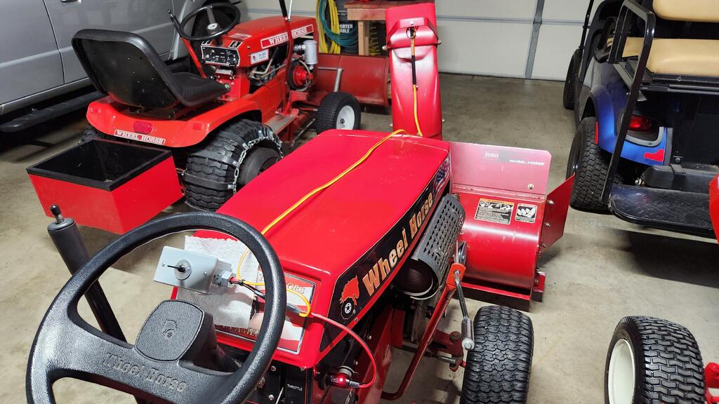

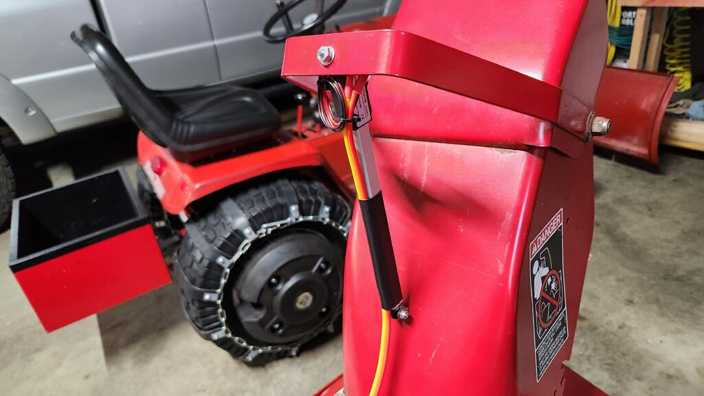

Racinbob 12,694 #1 Posted December 10, 2025 For the little town of Knox local we have already exceeded half the normal snowfall for the season. Several springs ago I picked up this tall chute from a member in PA. The only use it's had was just when I wanted to play with it. That is until this year. A recent snowfall of 10+" of very heavy wet stuff won the battle with the Reborn B-80 blade tractor. I fired up the 05 with the blower and it did the trick. But I was on and off the seat multiple times to adjust the chute deflector. I just eliminated that problem this morning. I didn't want anything 'permanent' on the tractor. The 6" stroke proved to be perfect mounted like this. I did a little video but I can't get it to transfer to YouTube. 5 11 Share this post Link to post Share on other sites

ri702bill 11,146 #3 Posted December 10, 2025 The key is having the control accessible and usable with heavy gloves on.... looks like you got it covered. 4 Share this post Link to post Share on other sites
