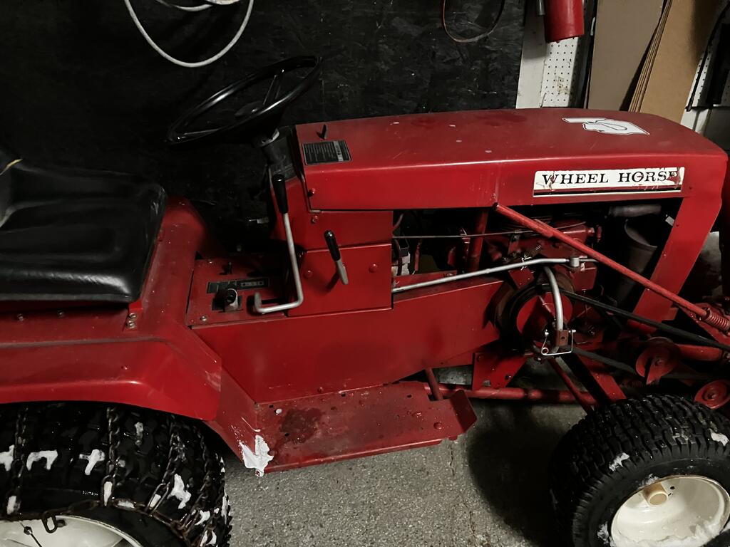

lumbert scott 25 #4 Posted December 9, 2025 (edited) Ok. Drive belt is good, I wanna say it's an early 80's tractor. I can't find the model number on it It kinda wants to move but not really . i did add a picture of it, hopefully it helps It will lift the blower tho. Edited December 9, 2025 by lumbert scott 1 Share this post Link to post Share on other sites

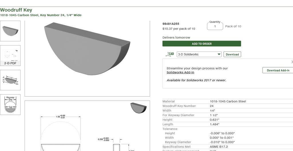

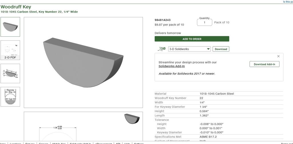

pfrederi 20,047 #9 Posted December 9, 2025 (edited) 9 minutes ago, lumbert scott said: Ok, Found the problem,Keyway must have let loose, axle spins in the hub. Now to track down a key .Thanks again It will be either a #22 or #24 woodruff key. WH used both Edited December 9, 2025 by pfrederi 2 Share this post Link to post Share on other sites

gwest_ca-(File Mod) 12,060 #14 Posted December 9, 2025 Looks like a 1978 or 1979 model. Fuel tank under the seat. Engine horse power with hydro transmission will identify the model number. 3 Share this post Link to post Share on other sites
