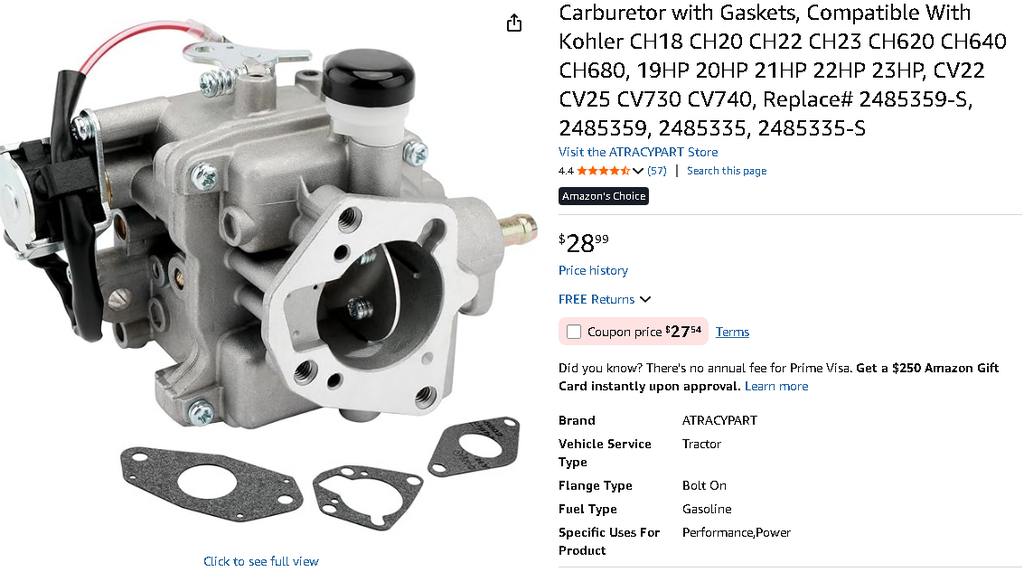

JoeM 10,099 #3 Posted December 8, 2025 @Boyd Walker, I'm putting this one on a 522xi today, Looks pretty good out of the box, I will let you know how it goes. 1 Share this post Link to post Share on other sites
JoeM 10,099 #4 Posted December 8, 2025 Worked good, bolted up, linkage fit nice and ran. 1 Share this post Link to post Share on other sites
ri702bill 12,496 #5 Posted December 8, 2025 1 hour ago, JoeM said: Worked good, bolted up, linkage fit nice and ran. Offshore Import to the rescue!!! Share this post Link to post Share on other sites
JoeM 10,099 #6 Posted December 8, 2025 1 hour ago, ri702bill said: Offshore Import to the rescue!!! And I am not sure the OE isn't the same 1 Share this post Link to post Share on other sites
ri702bill 12,496 #7 Posted December 8, 2025 26 minutes ago, JoeM said: And I am not sure the OE isn't the same But 29 bucks is a lot easier to swallow than the Toro price... 1 Share this post Link to post Share on other sites
