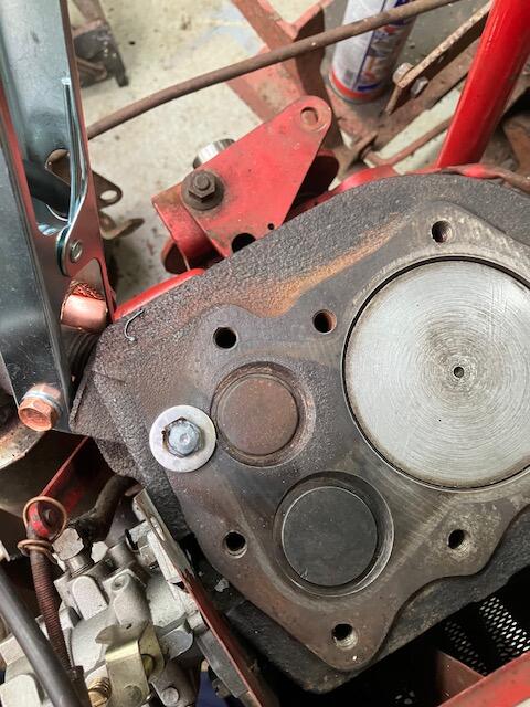

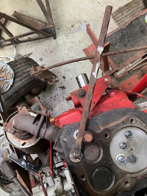

andrewLL 30 #1 Posted December 7, 2025 Hi, hoping some one can suggest best way forward. I have not been able to start my tractor this year ( K301 engine). It was put away in October 24 working fine, but in June this year it would not start. I have done all the obvious things, cleaned carburettor, checked points, checked valve clearances, put fresh fuel in and flushed out all the old fuel, checked there is a spark. Using a squirt of easy start didn’t help either. I have now brought the engine back home to try and sort it, the tractor lives in France, but need to get it done before the spring. The tractor is a 1972 Raider and I assume the engine is original and I have never done anything to it other than service items. I thought it would be sensible to remove the head and see what the inside looked like but unfortunately one of the bolts has sheared. What is the best way of removing the remainder of the bolt? Because it was tight I used wd40 over a number of days and also heated the engine block with a blow torch. In the end it broke. I am reluctant to drill it and screw in an extractor because it is clearly stuck and there is a risk of breaking the extractor making the situation even worse. What do you all think? Just a thought here, this is a very basic engine, nothing like the Mercedes F1 engine Lando used to win today, would it work without this bolt? It would still have 8 holding the head on. Cheers, Andrew 1 Share this post Link to post Share on other sites
702854boy 495 #2 Posted December 7, 2025 If you have a welder try putting a washer over the stud and then a nut and put a nice big glob of weld in there and maybe the heat will help you get it out and then you'll also have something to grab onto. 5 Share this post Link to post Share on other sites
gwest_ca-(File Mod) 11,998 #3 Posted December 7, 2025 With the welder's ground lead on the block any current has to flow through the stud to get to the block when welding a nut to the stud. Usually resistance between the stud and the block will result in heat being created right where you need it. That is the hottest corner of the head next to the exhaust valve so you need that stud. 4 2 Share this post Link to post Share on other sites

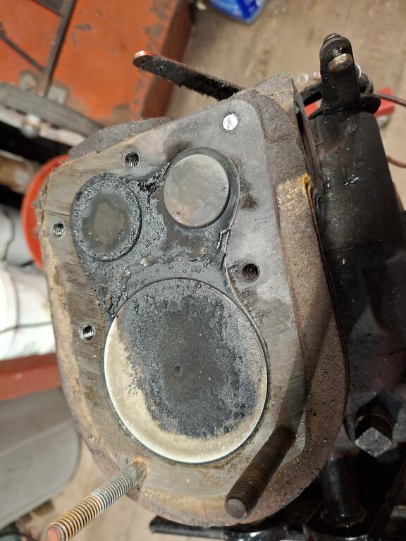

squonk 45,500 #4 Posted December 7, 2025 I had the same thing on a small block. That bolt takes all of the exhaust heat. I tried drilling and that bolt was heat hardened. I took it to a friend of mine who mounted the block on his mill and got it drilled straight and put in a helicoil.If your bolt is stuck like mine was you're not going to get it to turn out. 1 Share this post Link to post Share on other sites
Handy Don 15,933 #5 Posted December 7, 2025 To answer the original question Emphatically YES you need that bolt. Note that manufacturers do not like spending money unnecessarily. If that bolt wasn’t needed, it simply wouldn’t be there in the first place! 3 Share this post Link to post Share on other sites
adsm08 4,195 #6 Posted December 7, 2025 WD40 is neither a penetrant, nor a lubricant, and is not at all appropriate to this task. In my experience the idea of welding a washer and nut over it is probably the best bet, short of a machine shop. 4 Share this post Link to post Share on other sites
Ed Kennell 44,857 #7 Posted December 8, 2025 I have had good results by welding a nut to the broken bolt. Try to get as much penetration in the bolt as possible. 3 2 Share this post Link to post Share on other sites
JoeM 9,616 #8 Posted December 8, 2025 13 hours ago, Ed Kennell said: Try to get as much penetration in the bolt as possible I like welding a flat washer first just for that reason, then the nut to the washer. I would heat quench with penetrating fluid too. Shrinking it a tad. 2 1 Share this post Link to post Share on other sites
rmaynard 16,864 #9 Posted December 8, 2025 With the bolt broken off below the surface, how do you weld a washer to it without damaging the block? If welding does not work for you, any reputable machine shop can get it out. 2 Share this post Link to post Share on other sites
Ed Kennell 44,857 #10 Posted December 8, 2025 37 minutes ago, rmaynard said: how do you weld a washer to it without damaging the block? The washer with a 1/2" hole would be used to help protect the block. A nut with a larger hole would allow the mig wire to reach thru the nut and washer to the broken bolt. The weld would not have much penetration on the cast iron block threads. The nut, washer, and bolt would all be welded together. All the holes should be bottom tapped before assembly. 2 3 Share this post Link to post Share on other sites

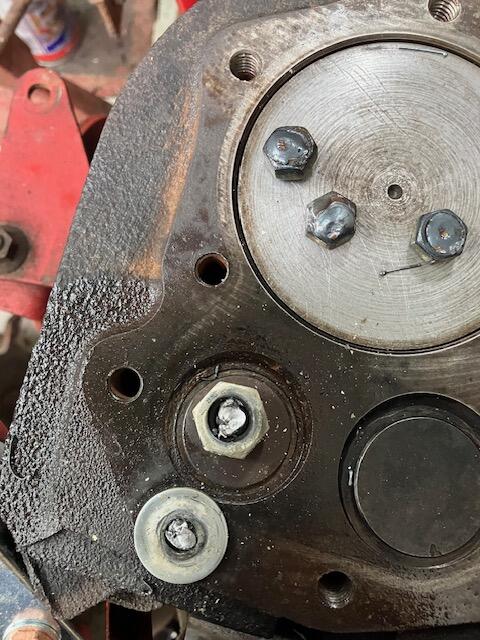

andrewLL 30 #11 Posted December 10, 2025 Thank for all your suggestions. I have recently bought a MIG welder so I will give that a try. Hopefully the heat from welding may help loosen the stud. I will let you know how it goes. Andrew. 4 Share this post Link to post Share on other sites
markseven 93 #12 Posted December 10, 2025 Good luck it'll work. And if it doesn't you can Still drill it out. 2 Share this post Link to post Share on other sites
squonk 45,500 #13 Posted December 11, 2025 This is the bolt sheared on the last 8 I did and after the helicoil. 2 Share this post Link to post Share on other sites

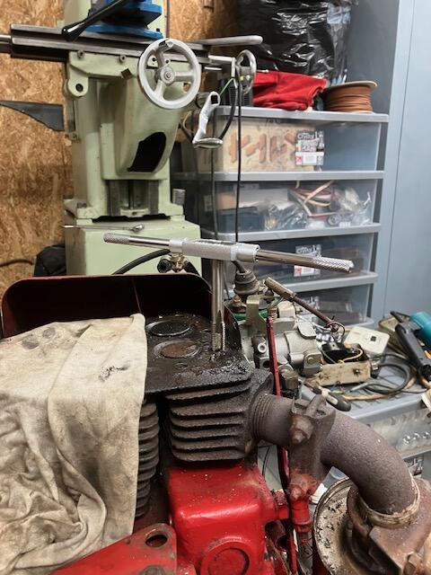

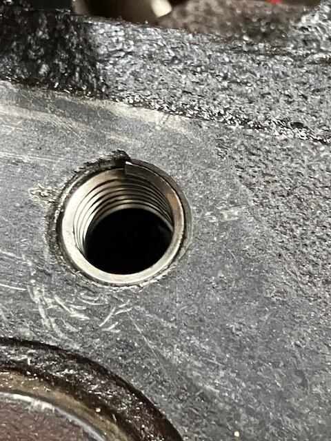

andrewLL 30 #14 Posted December 17, 2025 Thanks for your suggestions, I tried welding a nut on to the remains of the bolt but found that the weld would break with relatively little force. I also tried welding a bar on, but the same thing happened. In the end I drilled the old bolt out and used a helicoil. Something that I had never tried before, but not a difficult job. I’m thinking that whilst the head is off it may be sensible to re grind the valves. I don’t think that this is the reason for it not starting but it can’t do any harm. 3 2 Share this post Link to post Share on other sites
