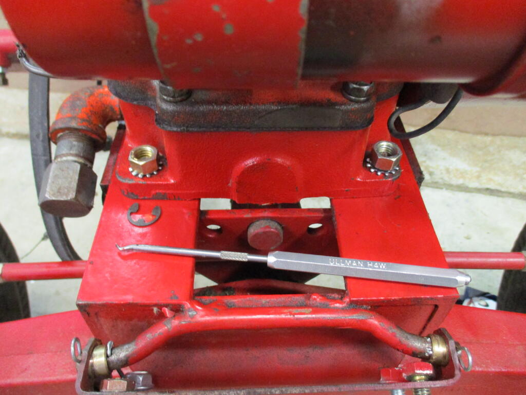

pfrederi 20,134 #1 Posted December 7, 2025 It is very difficult to get the front two mounting bolts hooked up on a K-181 on an 856/commando frame. You can't get good access to the under side of the frame to get the bolt up through or hold a nut if you bring the bolt down from the top. After a half hour of frustration I had a brain fart. With the engine slid back you can work the bolt up from the bottom. So I got two 3/8" E clips slipped them over the bolt on the top side of the frame. Held the bolt in place while I lowered the engine over them. Just catch the lock washer and nut then use a pry bar lift the engine and with a small hook you can pull the E clip off. 9 Share this post Link to post Share on other sites

ri702bill 11,617 #3 Posted December 7, 2025 Paul, I can relate to that... I bought a cheap 9/16" 6 point 3/8" drive socket for that purpose. I ground one side flat parallel to one of the socket flats. I left about .030 wall... I use that socket with an extension to hold the hexnut from below while installing the bolt from above. Your method works fine without the added cost... 2 Share this post Link to post Share on other sites

squonk 45,887 #5 Posted December 7, 2025 I use the push nuts like you see holding brake drums on from the factory. Share this post Link to post Share on other sites

squonk 45,887 #13 Posted December 8, 2025 The last 2 times I put an 8 in the hole, I used a 1/4" dr. 1/2" flex socket stiffened up with electrical tape with an 8" extension to get the bolt in place and hold it before putting on the push nut 2 1 Share this post Link to post Share on other sites
WHX?? 55,829 #14 Posted December 8, 2025 1 hour ago, squonk said: flex socket stiffened up with electrical tape Now that trick really works good 1 Share this post Link to post Share on other sites
pfrederi 20,134 #15 Posted December 8, 2025 Some of you must have much thinner more flexible fingers than I. 3 Share this post Link to post Share on other sites
squonk 45,887 #16 Posted December 8, 2025 Undoing the inner tie rods helps give some more room too. 1 Share this post Link to post Share on other sites
