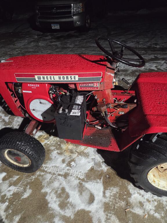

ebinmaine 77,081 #12 Posted December 25, 2025 Wow. Where do you put yer feet?? Neat for that rig with a small feeted driver but wouldn't work on an 8-speed or anything I operate. Share this post Link to post Share on other sites
markseven 93 #13 Posted December 26, 2025 There's still 6 inches underneath battery. 1 1 Share this post Link to post Share on other sites
Treepep 1,037 #14 Posted December 26, 2025 20 hours ago, ebinmaine said: Wow. Where do you put yer feet?? Neat for that rig with a small feeted driver but wouldn't work on an 8-speed or anything I operate. FEET? What about SEAT? 2 Share this post Link to post Share on other sites
ebinmaine 77,081 #15 Posted December 26, 2025 11 minutes ago, Treepep said: FEET? What about SEAT? OK valid point Share this post Link to post Share on other sites
markseven 93 #16 Posted December 26, 2025 Ya ya im looking for one still. 1 Share this post Link to post Share on other sites
