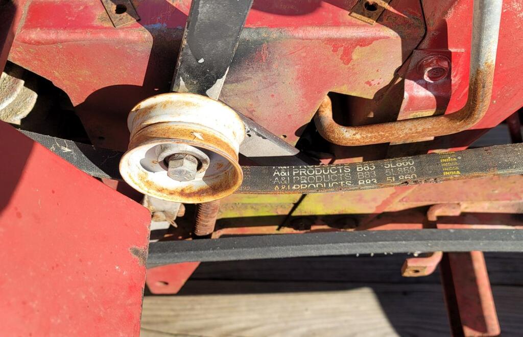

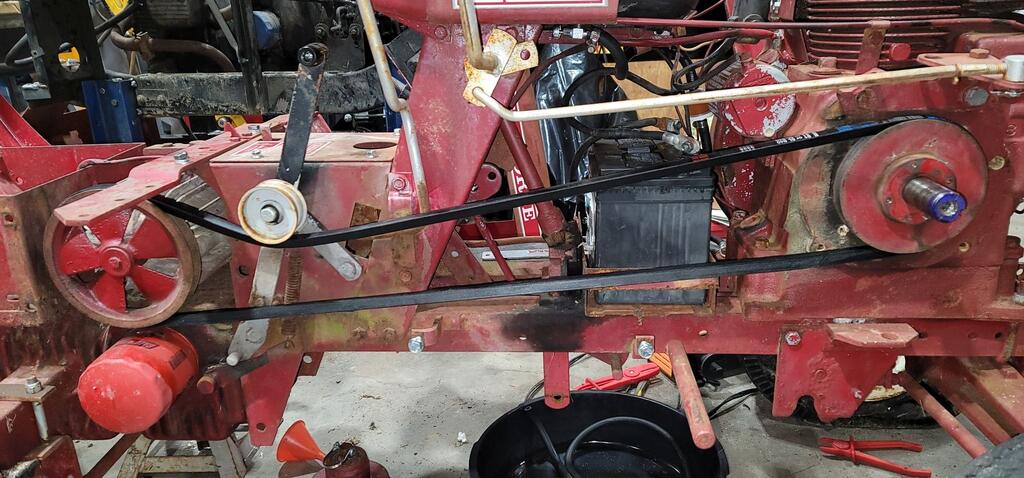

Handy Don 16,603 #81 Posted December 28, 2025 2 hours ago, BradKahler said: That belt is definitely too loose. From length or wear or too-low spring tension I cannot tell. The “kinda” white tensioner/idler pulley should be pressing down on the belt to hold it snug. Confirm that the spring that applies the tension to that pulley is in place functioning. It is a pretty strong spring between the tensioner lever and a hole in a web cast into the transaxle (the web braces the axle housing to the main body) 1 1 Share this post Link to post Share on other sites

BradKahler 307 #84 Posted December 28, 2025 1 hour ago, Handy Don said: That belt is definitely too loose. From length or wear or too-low spring tension I cannot tell. The “kinda” white tensioner/idler pulley should be pressing down on the belt to hold it snug. Confirm that the spring that applies the tension to that pulley is in place functioning. It is a pretty strong spring between the tensioner lever and a hole in a web cast into the transaxle (the web braces the axle housing to the main body) I can confirm the spring is present and definitely strong. Since the belt is too long I'll go ahead and replace it and we'll see what the belt tension looks like. In this application is it necessary to buy a Toro belt, or will a generic 5/8" x 84" belt work? Share this post Link to post Share on other sites

BradKahler 307 #91 Posted December 31, 2025 I should be getting the v-belt later today so I'm hoping that sometime tomorrow I will be able to run the engine with belt attached to see if/how the hydro drive works. I still haven't done anything to try and resolve the engine smoking, that will probably happen this weekend. However, the engine smoking got me to thinking....which is a bad thing About 15 years ago I bought a Struck mini dozer and it came with Kohler K341AQS-71221a engine installed. It's my understanding it came from a mid 70s Cub Cadet. I was told the engine was running when I bought the dozer but I've never tried to run it. The engine is just too big for the dozer so I pulled it and sat it on a shelf. Last night was when I actually remembered I still had the engine. This all leads to my question, other than the oil pan being wrong, is there any reason this K341 wouldn't fit in the B100 chassis? Prior to deciding not to use the engine in the dozer, I bought an oil pan off of ebay (see last picture) to replace the existing oil pan. I'm not 100% certain the oil pan picture matches what I bought, I need to find it because it's buried somewhere in my shop. Thoughts anyone? Share this post Link to post Share on other sites

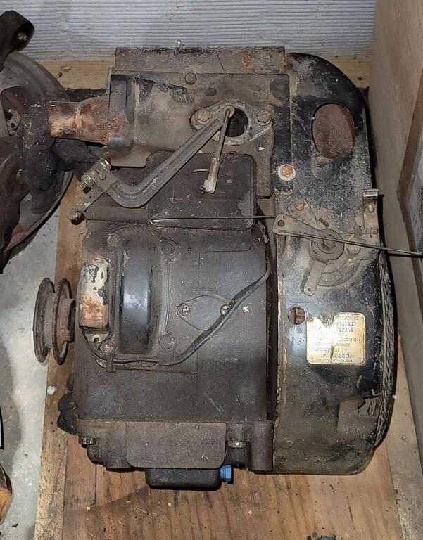

Handy Don 16,603 #92 Posted December 31, 2025 One thing that sets WH Kohler build specs apart is that they included bearings able to handle the axial thrust that comes from the PTO pressing inward toward the block. Many other builds had bearings suitable for only belt- or chain-connected loads. Cubs that I’ve seen had either direct shaft drive or belt connections--nothing causing significant axial load on the engine. Share this post Link to post Share on other sites
BradKahler 307 #93 Posted December 31, 2025 14 minutes ago, Handy Don said: One thing that sets WH Kohler build specs apart is that they included bearings able to handle the axial thrust that comes from the PTO pressing inward toward the block.Many other builds had bearings suitable for only belt- or chain-connected loads. Cubs that I’ve seen had either direct shaft drive or belt connections--nothing causing significant axial load on the engine. That's good information to have. Am I correct in assuming the axial load comes from the PTO pulley being pressed against the friction disk? If I do consider going down this path, there would likely be two reasons for a change. The first is the existing 8hp Kohler needs a rebuild, and second, I could use a strong tractor for pulling. In the near future I'm going to be dealing with a lot of felled trees and a lot of pulled out of the ground fence posts. All of which will need to be moved to a more central location. This sort of work wouldn't make use of a PTO. Thinking about it, I guess another reason for a possible engine change would be because the B100 8-speed that I recently got, sat for an untold number of years with no cover on the open upright exhaust pipe. That engine might be toast as well. It's possible I may have two B100 tractors in need of engines and or engine rebuilds Thanks for the info. 1 Share this post Link to post Share on other sites
Handy Don 16,603 #94 Posted December 31, 2025 50 minutes ago, BradKahler said: Am I correct in assuming the axial load comes from the PTO pulley being pressed against the friction disk? Exactly. WH did, for some models, use an electric clutch PTO which meant no axial load on the engine! Share this post Link to post Share on other sites

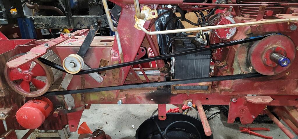

BradKahler 307 #95 Posted December 31, 2025 (edited) 2 hours ago, Handy Don said: Exactly. WH did, for some models, use an electric clutch PTO which meant no axial load on the engine! Maybe the electric clutch is an option if I ever go down the K341 path. The good news..... The belt arrived and I got it installed and after a bunch of cranking I got the engine to start, still smokin like a freight train Now for the bad news.... Once the engine was running I slowly started to move the drive control lever slowly forward. After a little bit I could hear what sounded like gears grinding so I pulled it back, slowed the engine down and tried again. This time shortly after the gears started to grind the engine stalled. At that point I shut things down and came back to the house. At no point did I see the wheel hubs start to turn. You can actually turn the hubs at any time, at least that's what I think happens. I might have to look at that a bit closer. I wouldn't think the hubs should turn if the tow valve is closed (screwed cw until tight). I should add, this all took place with the parking brake NOT pulled up. I'm not sure where to go from here. Edited December 31, 2025 by BradKahler 1 Share this post Link to post Share on other sites

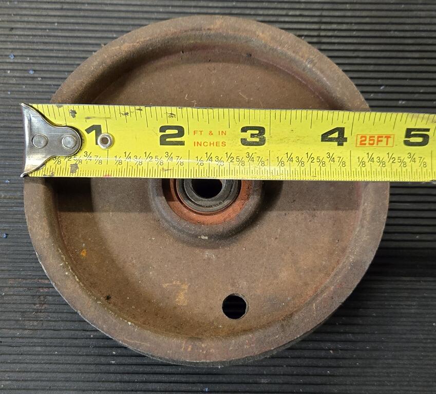

kpinnc 18,242 #96 Posted December 31, 2025 (edited) On 12/28/2025 at 12:50 PM, Bill D said: Maybe someone here knows for sure. I think you'd be better off with a larger pulley. I don't know the part number for your specific model, but every one I've seen is larger (about 4.5 inch diameter) whether for a Sundstrand or Eaton hydro. Edited December 31, 2025 by kpinnc Share this post Link to post Share on other sites
BradKahler 307 #97 Posted December 31, 2025 18 minutes ago, kpinnc said: I think you'd be better off with a larger pulley. I don't know the part number for your specific model, but every one I've seen is larger (about 4.5 inch diameter) whether for a Sundstrand or Eaton hydro. Now that I have the correct size belt (the other was 2" to long), I don't think I could get a pulley that size installed with the new belt. Parking brake is pulled up in this picture. Parking brake is NOT pulled up in this picture. Share this post Link to post Share on other sites
BradKahler 307 #98 Posted January 1 I did some research on the idler pulley and part number 7434 has these specs, OD 3.000" Width 7/8" Flat width 3/4" ID 3/8". Those specs match my pulley. Share this post Link to post Share on other sites

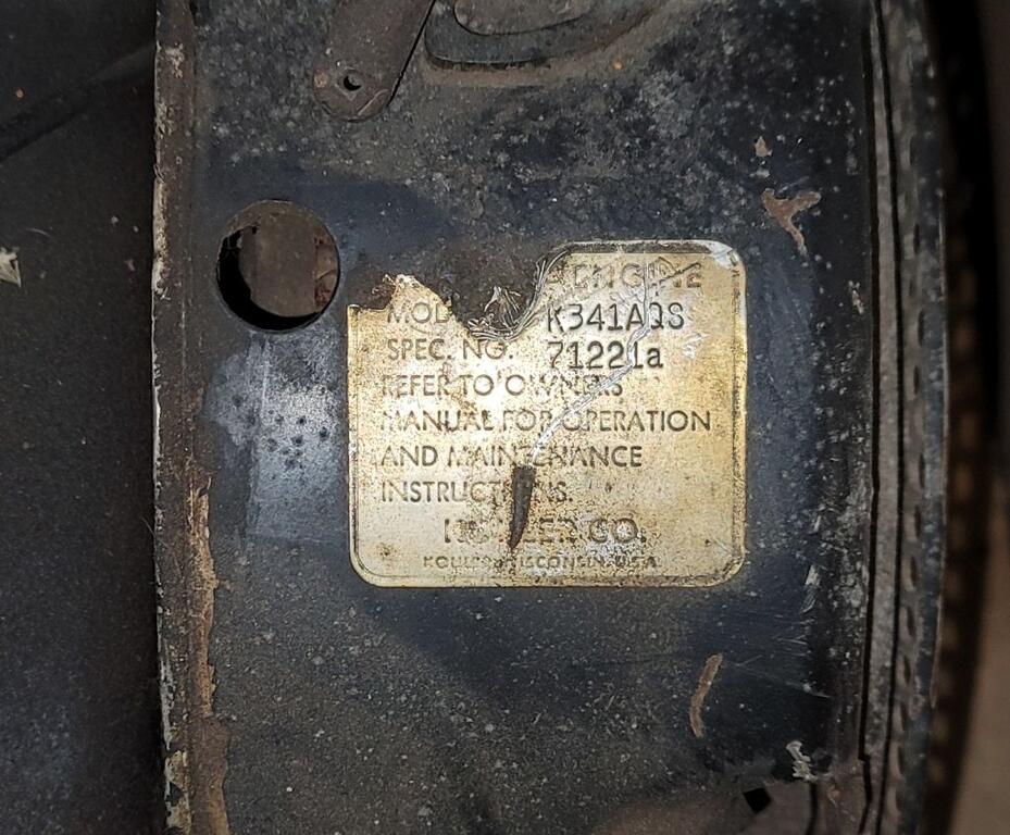

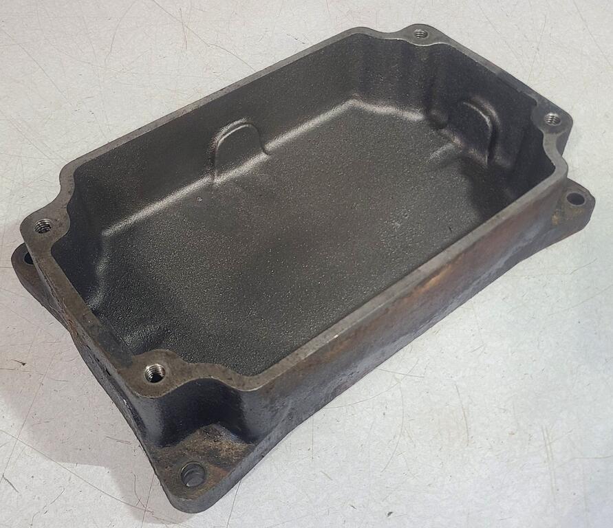

953 nut 66,078 #99 Posted January 1 22 hours ago, BradKahler said: Kohler K341AQS-71221a engine installed. It's my understanding it came from a mid 70s Cub Cadet. 22 hours ago, BradKahler said: I bought an oil pan off of ebay (see last picture) to replace the existing oil pan. I don't think the oil pan shown will be a direct bolt-up to the engine. You have a SMALL BASE engine and a BIG BASE oil pan, not a direct bolt up. Read this thread for better information. 1 Share this post Link to post Share on other sites
BradKahler 307 #100 Posted January 1 32 minutes ago, 953 nut said: I don't think the oil pan shown will be a direct bolt-up to the engine. You have a SMALL BASE engine and a BIG BASE oil pan, not a direct bolt up. Read this thread for better information. Thanks for the info and link. That will help tremendously once I decide which path to take. One thing I should clarify, the pan that I posted is one I grabbed off the web. The one that I bought is buried somewhere in my shop and I am working from memory for something I got 15 years ago. I actually ended up buying two different pans. The first one was from a K321 and once I realized my mistake I bought another pan. Anyway, until I figure out what's wrong with the hydro I probably shouldn't be thinking about engine swaps 1 Share this post Link to post Share on other sites
