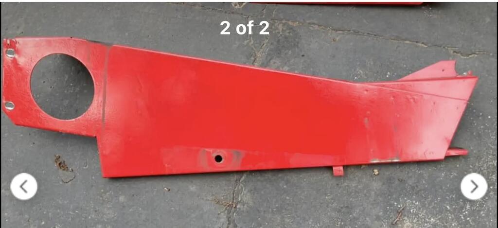

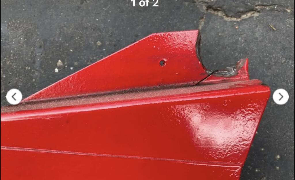

Krice58 164 #1 Posted December 4, 2025 Top mounting hole in my c160 belt guard is blown out and I can’t find a replacement. Anyone have any tips for repair? Just weld a washer in? Any input would be great. Thanks. I’ll include some pictures of my issue. This isn’t my belt guard in the photos but it’s the same issue. 1 Share this post Link to post Share on other sites
ebinmaine 77,584 #2 Posted December 4, 2025 2 minutes ago, Krice58 said: I can’t find a replacement You check with Lincoln at A to Z in pennsylvania? 2 minutes ago, Krice58 said: Just weld a washer in I believe that to be a pretty good idea. Get a fairly thin Fender washer with the correct diameter hole. Use something close to the thickness of your existing sheet metal to make the weld easier. Place, cut, trim, form the fender washer and paste it in place. 4 1 Share this post Link to post Share on other sites
ri702bill 11,421 #3 Posted December 4, 2025 Or .... remove the entire top piece with the 2 holes, replace it with thin gage angle mounted from under the inside, Weld, bond, or screw it together. 4 Share this post Link to post Share on other sites
Ed Kennell 45,074 #4 Posted December 4, 2025 (edited) I used a piece of 1/16" thick angle iron cut to the shape of the broken piece. Cut out the damaged part and welded the new part in place. Oops, Bill types faster. Edited December 4, 2025 by Ed Kennell 4 Share this post Link to post Share on other sites

Krice58 164 #6 Posted December 4, 2025 9 minutes ago, ri702bill said: Or .... remove the entire top piece with the 2 holes, replace it with thin gage angle mounted from under the inside, Weld, bond, or screw it together. Sounds like a good idea. 2 Share this post Link to post Share on other sites
Krice58 164 #7 Posted December 4, 2025 7 minutes ago, Ed Kennell said: I used a piece of 1/16" thick angle iron cut to the shape of the broken piece. Cut out the damaged part and welded the new part in place. Oops, Bill types faster. That may be a better solution than welding to the already rusted and damaged metal. 2 Share this post Link to post Share on other sites

Horsin'round 374 #12 Posted December 5, 2025 There seems to be an abundance of spare parts requiring this repair. I replaced the entire fin with new metal. Layed a big fat ugly bead of weld in the crease, an ground it back slightly concave (the weld). Given the location, it's not really noticeable. 1 Share this post Link to post Share on other sites
