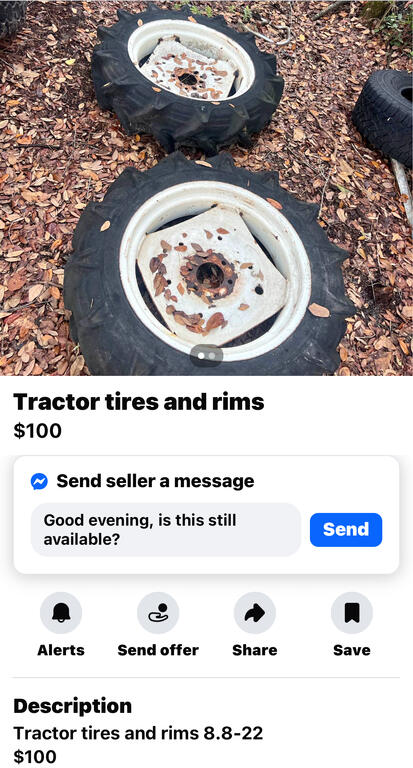

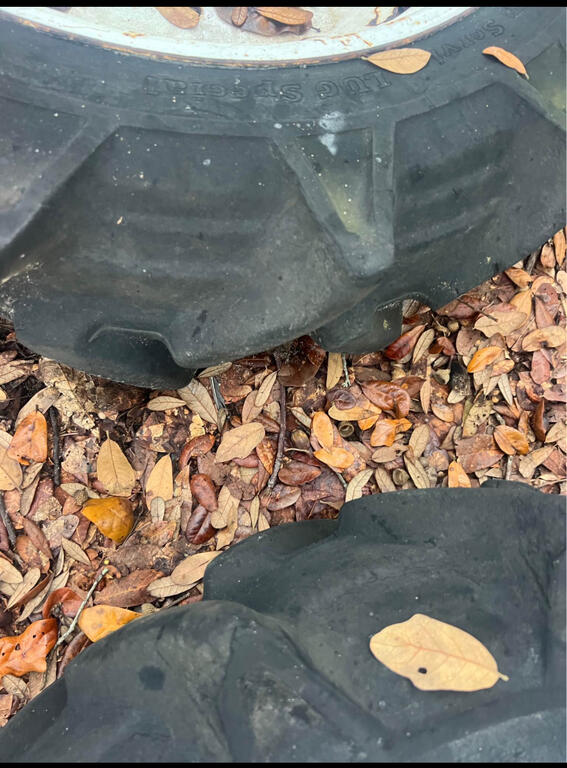

FLtractor 114 #1 Posted December 3, 2025 Will these fit a 856 23x8x12.. worth the $ for what they are? 200 mile roundtrip drive Only pictures from listing. Thank you 1 Share this post Link to post Share on other sites
adsm08 4,183 #2 Posted December 3, 2025 Probably not. They are too narrow to fit the factory wheels, and those look like 6-lugs, the originals for an 856 are 5-lug. Share this post Link to post Share on other sites
ebinmaine 77,244 #3 Posted December 3, 2025 Doesn't seem so. The 8.8- 22 is likely the size. Quite a bit bigger than your own. 22 is the rim size. 3 Share this post Link to post Share on other sites
FLtractor 114 #4 Posted December 3, 2025 3 minutes ago, ebinmaine said: Doesn't seem so. The 8.8- 22 is likely the size. Quite a bit bigger than your own. 22 is the rim size. The add says 8.8-22. Can you tell me what that number means in relation to my 856 rear of 23x8x12? What would or should I go with? 1 Share this post Link to post Share on other sites
FLtractor 114 #5 Posted December 3, 2025 4 minutes ago, ebinmaine said: Doesn't seem so. The 8.8- 22 is likely the size. Quite a bit bigger than your own. 22 is the rim size. Thank you for prompt reply 2 Share this post Link to post Share on other sites
ebinmaine 77,244 #6 Posted December 3, 2025 1 minute ago, FLtractor said: The add says 8.8-22. Can you tell me what that number means in relation to my 856 rear of 23x8x12? What would or should I go with? I'm not positive here.... I believe the 8.8 is the "advertised width" of the tire. The 22 should be the wheel diameter. Many (most?) Garden Tractor tires are on a 12" wheel. The middle number is the width. The first number is the outer diameter of the tire. There are a few tires that don't get even remotely close to the actual size with their advertised size. You may very well find that getting two new tires is far easier and less expensive than shopping for usable used ones. Factor in your own time and fuel. 5 Share this post Link to post Share on other sites

ri702bill 11,226 #8 Posted December 3, 2025 (edited) 13 hours ago, FLtractor said: Will these fit a 856 23x8x12.. That size is not original to a 856. The 6-12 would be Those are from a later tractor like a B or C series - and the wider tires DO give you a wider track and more stability. New same size as what you have tires may be the way to go. Edited December 3, 2025 by ri702bill Share this post Link to post Share on other sites
