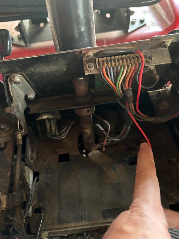

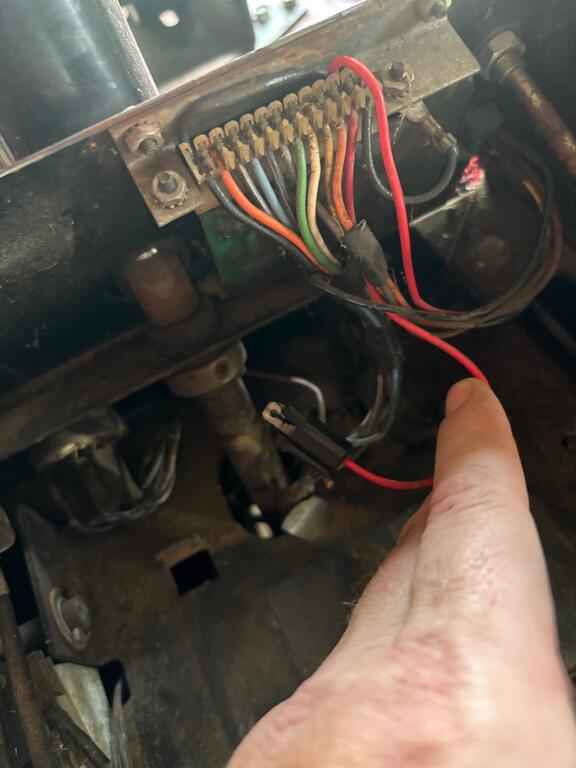

Volant1006 42 #10 Posted December 20, 2025 The last time the tractor ran was in the summer, the last time I cut the grass. That was a few months ago. I took the deck off the other day and when I tried to start it, that's when I started having the issue. I replaced the battery since it was 7+ years old to be safe. Did not resolve the problem. The idiot lights on this tractor never worked ever since I got it 10 years ago, never thought anything of it. I did notice 2 red wires behind the battery that looked like they might have been connected at one point. After hooking up the new battery and the tractor not starting I connected the 2 red wires. When I did the PTO Clutch light lit up (even with the key in the off position). Did not affect the tractor not starting so I disconnected them. Share this post Link to post Share on other sites

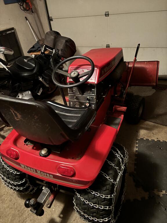

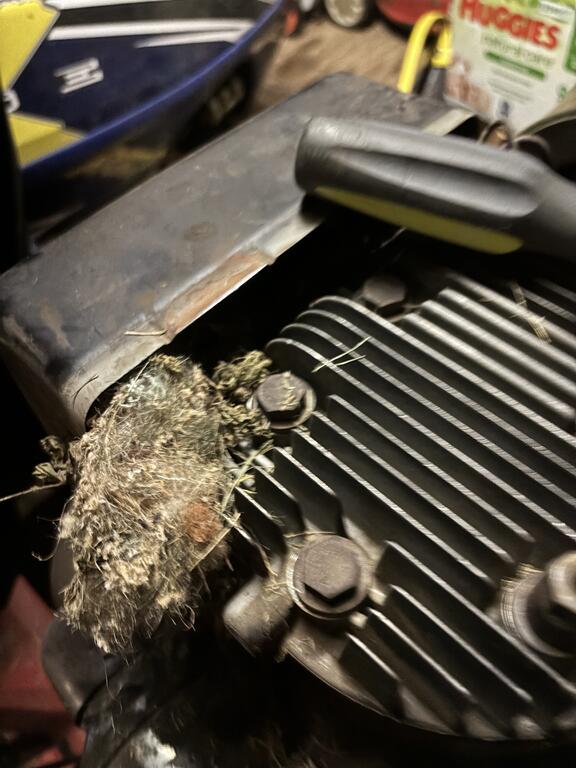

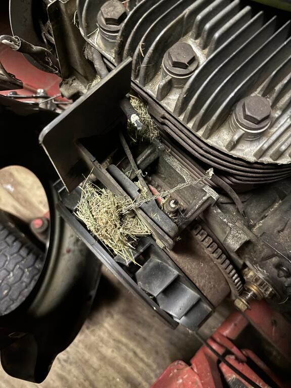

Volant1006 42 #19 Posted January 25 (edited) Figured out the problem. Apparently when a mouse builds a nest under your engine cover and chews through your spark plug wire it's hard to get a spark. After taking some things apart I found a dead mouse and his giant kingdom he build in my engine. He chewed right through the plug wire. Luckily I had my nephew with who had a friend close bye with a new ignition coil. We were able to replace the part, tape up some exposed wires and the horse was purring like a kitten. My shed isn't mouse proof, I feel like I let the tractor down, she deserves better. The 312-8 has been moved to my attached garage and has the blade and chains on waiting to tear through Snowpocalypse 2026! Edited January 25 by Volant1006 5 Share this post Link to post Share on other sites

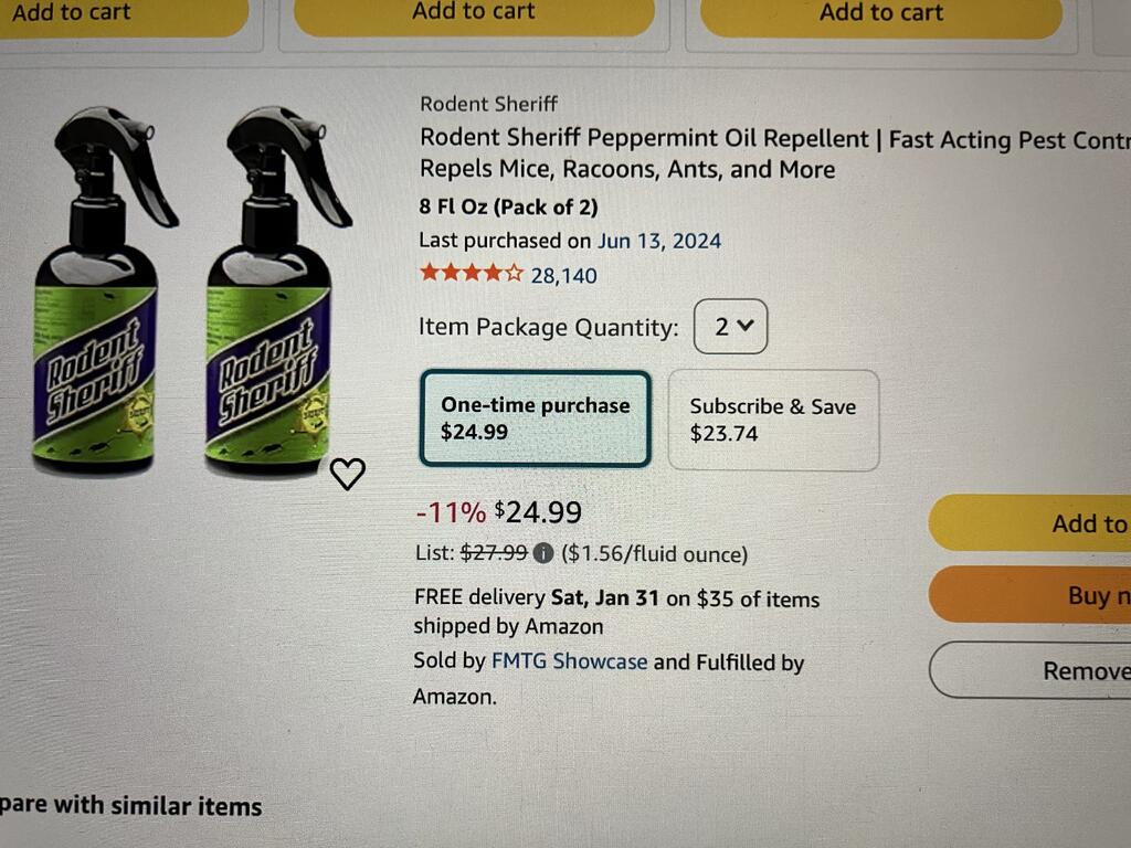

Retired Wrencher 6,901 #20 Posted January 25 I use this on and around engine when in storage. And other areas of the tractor. I even use it for the truck engine apartment. 3 Share this post Link to post Share on other sites
Sparky-(Admin) 26,185 #21 Posted January 25 1 hour ago, Retired Wrencher said: I use this on and around engine when in storage. And other areas of the tractor. I even use it for the truck engine apartment. I do the same. I give a shot or two right into the flywheel screen while it’s running at a low idle so that it gets distributed under the engine shrouds. And of course it also gets on any wiring under the shrouds. 2 1 Share this post Link to post Share on other sites
sqrlgtr 3,584 #22 Posted January 25 (edited) 11 hours ago, Volant1006 said: Apparently when a mouse builds a nest under your engine cover and chews through your spark plug wire it's hard to get a spark. get ya one of these for mousey problems...... Edited January 25 by sqrlgtr 1 1 1 Share this post Link to post Share on other sites
Volant1006 42 #23 Posted January 25 44 minutes ago, sqrlgtr said: My cat's too old. He just lays around on his candy ass all day looking out the window. He used to be an arctic cat going out in the snow, chasing everything. Now he just pony's up by the coal stove and sleeps. Summertime maybe I'll put him in the shed and see what he can comes up with! Definitely gonna try some of that spray though 44 minutes ago, sqrlgtr said: get ya one of these for mousey problems...... 1 Share this post Link to post Share on other sites
