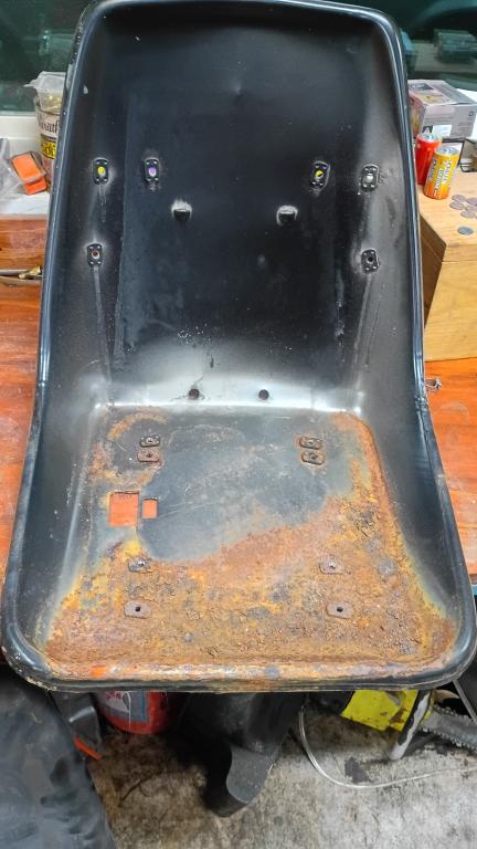

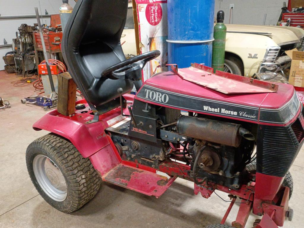

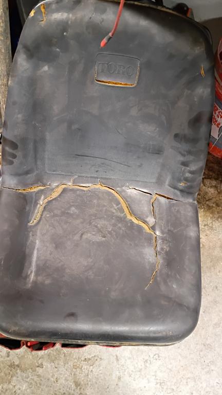

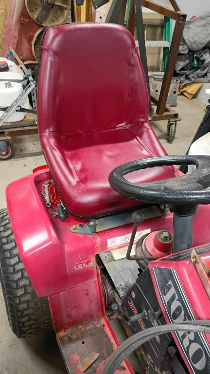

Joe BenHayon 85 #1 Posted November 27, 2025 I acquired this machine as a complete non running tractor from a friend a couple years ago. Sat in the corner biding it's time to be the priority project. Finally pulled it out last month and started working on it. So... Charger on the battery and spun the engine. Sounded good. A little ether in the carb and it fired right up. Cleaned the carb, replaced the fuel line, checked the fuel pump, a little choke and part throttle, purrs like a cougar. 😁 The paint is/was oxidized a bit. Turtle wax rubbing compound brought shine back, but still has that patina that some people like. The seat was beyond repair, so separated from the pan and repainted it and had the foam recovered.. The transmission drive belt was good enough to test drive on, and I am happy to report the hydrostatic drive works like it should. 😁 Now just waiting new belts and test out the 42" rear discharge mower with mulcher . Question: The hourmeter shows 61.xx hours. I know this machine has sat in various garages for at least the last 5 or 6 years. Mechanically, I'm thinking it is right, but given the weathering from being outside, it seems low for a 35yo machine. 6 1 Share this post Link to post Share on other sites

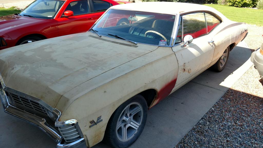

JCM 11,003 #4 Posted November 27, 2025 14 minutes ago, 953 nut said: The '67 Chevy in the background looks interesting too. Turbo-Jet 396 ?? 1 1 1 Share this post Link to post Share on other sites
ebinmaine 77,972 #5 Posted November 27, 2025 3 minutes ago, JCM said: Turbo-Jet 396 ?? You n' ya big blocks. 8 hours ago, Joe BenHayon said: acquired this machine 8 hours ago, Joe BenHayon said: Question: The hourmeter shows 61.xx hours. I know this machine has sat in various garages for at least the last 5 or 6 years. Mechanically, I'm thinking it is right, but given the weathering from being outside, it seems low for a 35yo machine. It would be considered QUITE a find to catch a 35 plus year old machine with that low of hours. Likely? Low probability. But possible? Absolutely. As stated above check the machine over. Look at the circuit for the hour meter for worn or corroding wires/ plugs. See the tires for tread wear. Look at the pulleys for wear on the sides where the belt would ride. 1 1 Share this post Link to post Share on other sites
953 nut 64,841 #6 Posted November 27, 2025 10 minutes ago, JCM said: Turbo-Jet 396 ?? 396 or 427 based on the fender badging. 3 Share this post Link to post Share on other sites
JCM 11,003 #7 Posted November 27, 2025 I suppose a 327 isn't out of question ? 1 Share this post Link to post Share on other sites
Joe BenHayon 85 #8 Posted November 27, 2025 6 hours ago, JCM said: Turbo-Jet 396 ?? Yes. Was. Currently newer 454 , .030 over and a truck cam. I am in the middle of going back to a well built 396@.030 over, 38cc pop-up pistons .545lift x 285 duration cam. Paid $25 for that car complete, not running, 35 years ago. 😁😁 Traded the original TH400 for TKO-600 5-speed and 3.73 gears. Way more fun to drive. 2 1 2 Share this post Link to post Share on other sites
Joe BenHayon 85 #9 Posted November 28, 2025 11 hours ago, 953 nut said: 396 or 427 based on the fender badging. Here ya go! 😁 4 1 1 Share this post Link to post Share on other sites
953 nut 64,841 #10 Posted November 28, 2025 Looks like a good solid car, Bumpers and trim are nice and bright and the right number of doors. 3 1 Share this post Link to post Share on other sites

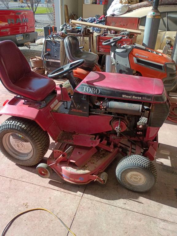

Joe BenHayon 85 #12 Posted November 29, 2025 It lives! It's too cold now for the grass to grow enough to mow, but I knocked down some tumbleweeds with it. 😁😁 1 2 Share this post Link to post Share on other sites
