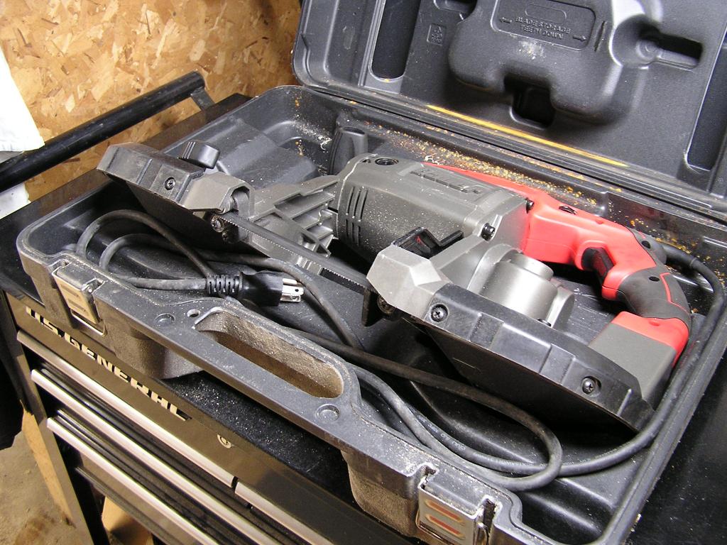

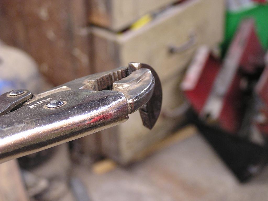

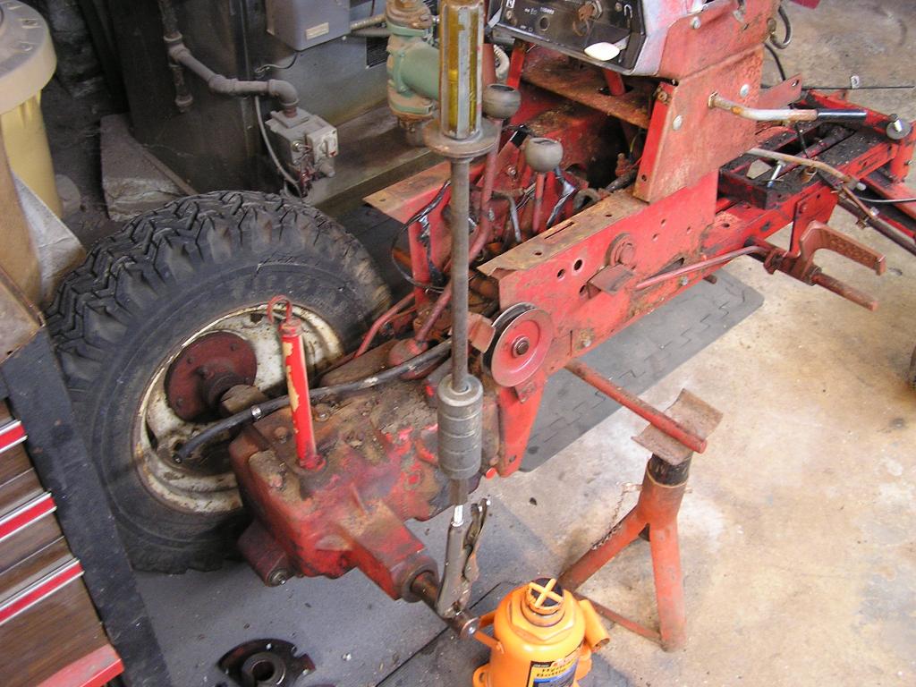

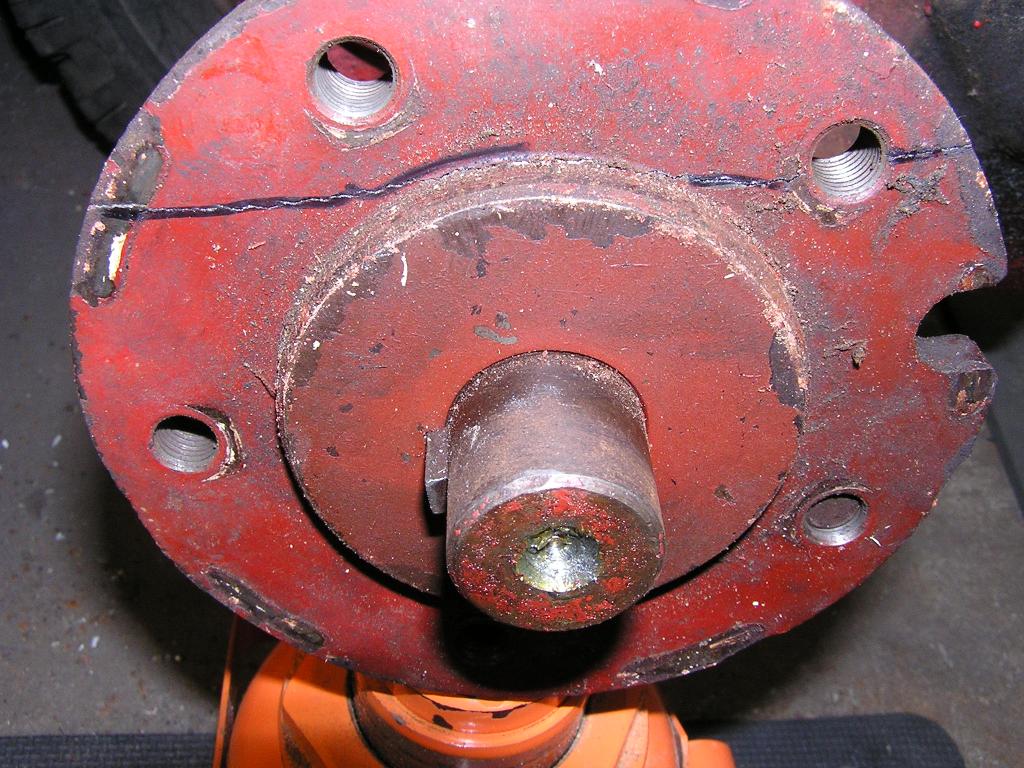

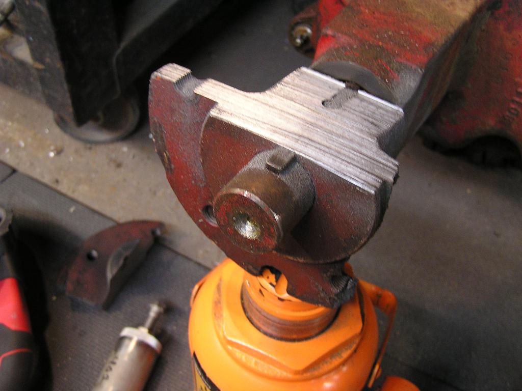

ri702bill 11,344 #1 Posted November 26, 2025 (edited) All: The C81 I purchased from @Sparky this summer had a rear that had walked inward and I could not get it loose with my puller; in fact I cracked the flange while attempting to do so. I planned on using my HFT Portable Bandsaw to cut the hub, but the flange diameter was greater than the saw's 5 inch throat opening. Snapped the broken flange piece with a large Crescent wrench, now the saw fits. Supported th hub with a jack to help keep it from rotating the axle and the plan was to cut thru the hub at the top of the keyway - and not touch the axle itself. A little more cleanup and the entire top of the keyway was exposed. Used my puller to remove it - got to love that "Snap" sound when it finally breaks free. Damaged the Woodruff Key in the process Used the Vise Grip / Slide Hammer to convince it to leave...  Edited November 26, 2025 by ri702bill 2 9 1 Share this post Link to post Share on other sites

ri702bill 11,344 #3 Posted November 26, 2025 40 minutes ago, ebinmaine said: That was fun. About as much fun as going to the Dentist & the DMV on the same day... Really quick cutting the cast iron when you use a new 10-14 TPI staggered tooth blade. That saw has nice control & variable speed. There has been various folks that mentioned cutting a hub off; I figured I'd post it - with pictures. 2 2 3 Share this post Link to post Share on other sites

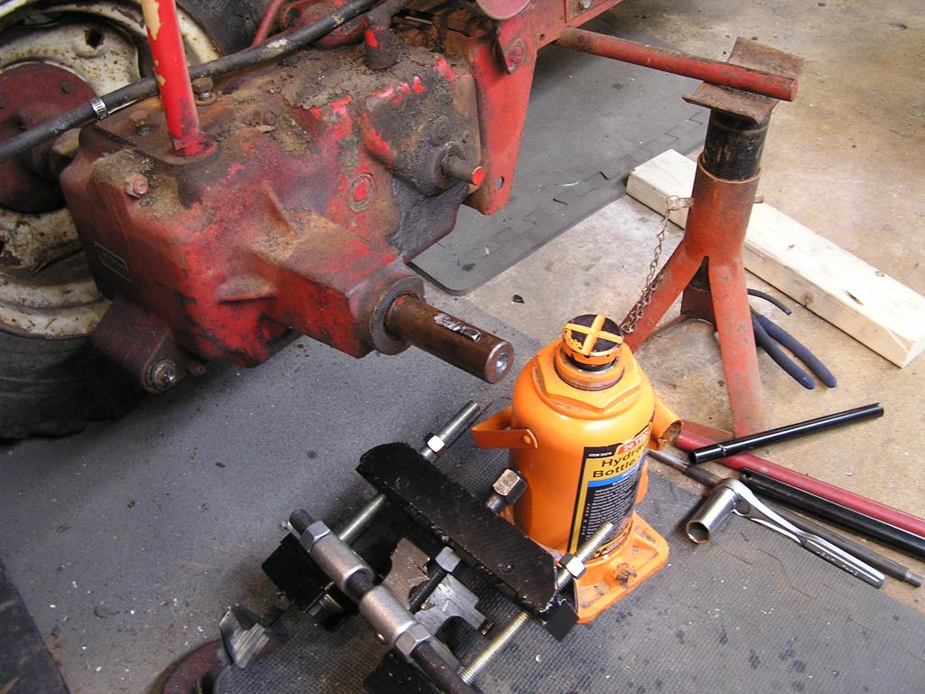

ri702bill 11,344 #4 Posted November 27, 2025 The input shaft key was in good shape, but I needed to remove it to change the seal. It did not want to budge. Used my Hydraulic ProPress plumbing crimper to squeeze down on the inside end - the front popped up enough to pry the heel on the key up & out. Super easy. 1 Share this post Link to post Share on other sites

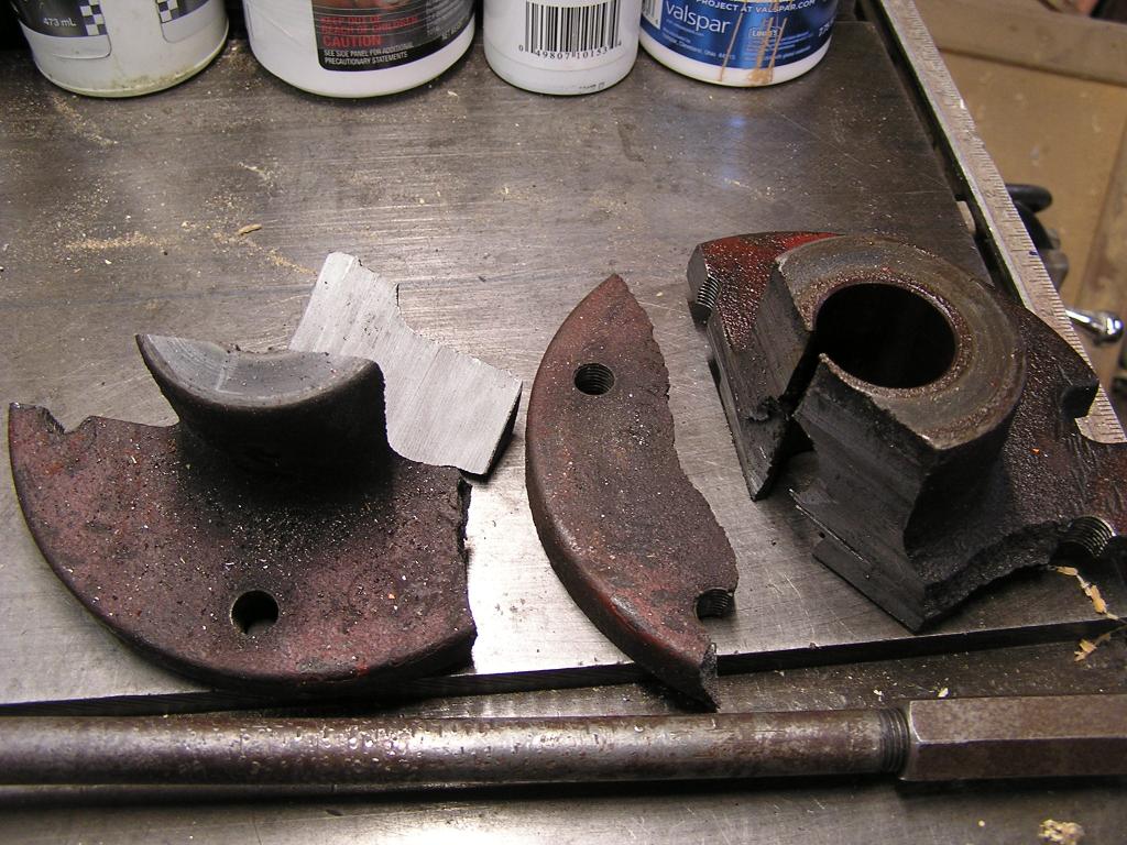

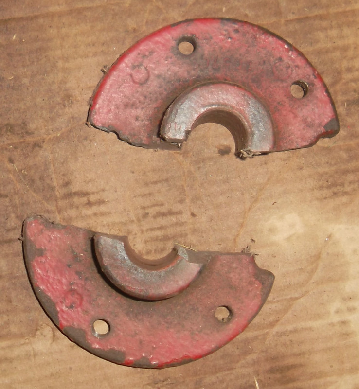

Lee1977 7,568 #5 Posted November 27, 2025 Some times they don't come off in one piece. This one wasn't broken but I broke two pullers and it never moved. Used a sawall on both sides and a chisel to finish braking it off. 4 Share this post Link to post Share on other sites
