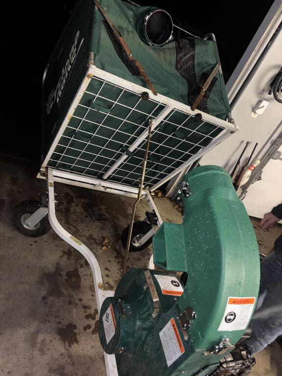

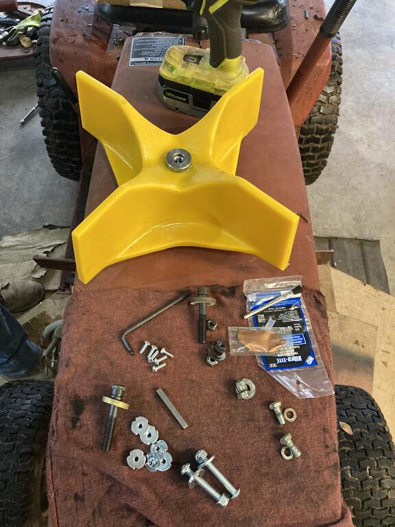

TonyToro Jr. 2,403 #1 Posted November 26, 2025 Good evening. I got a cyclone rake this past weekend. It needed an impeller so ordered that and came in today. Other than that it runs good. It has all the tubes and mounting things but no hitch. I’m not looking to mount it on the deck but simply mount it correctly in the back so it pivots how it is supposed too. If anyone could post pictures of have the hitch I need that would be great! I’ll post some pictures tomorrow. Have a good night. Mods- if I didn’t put it in the right section feel free to move it. 2 Share this post Link to post Share on other sites

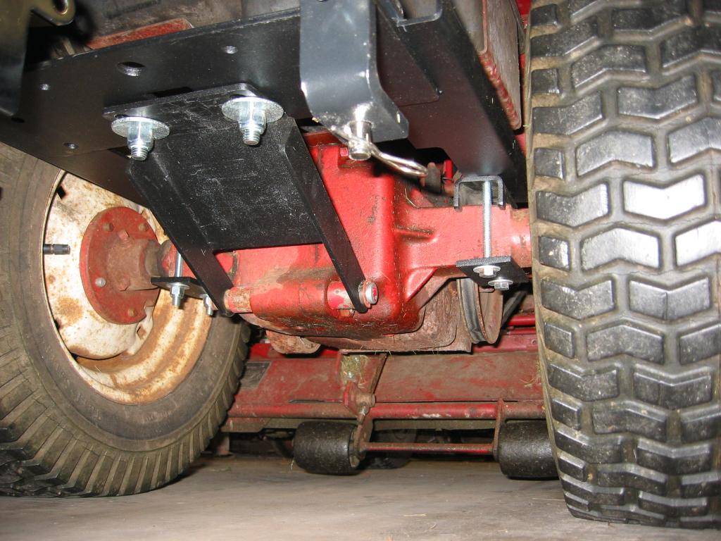

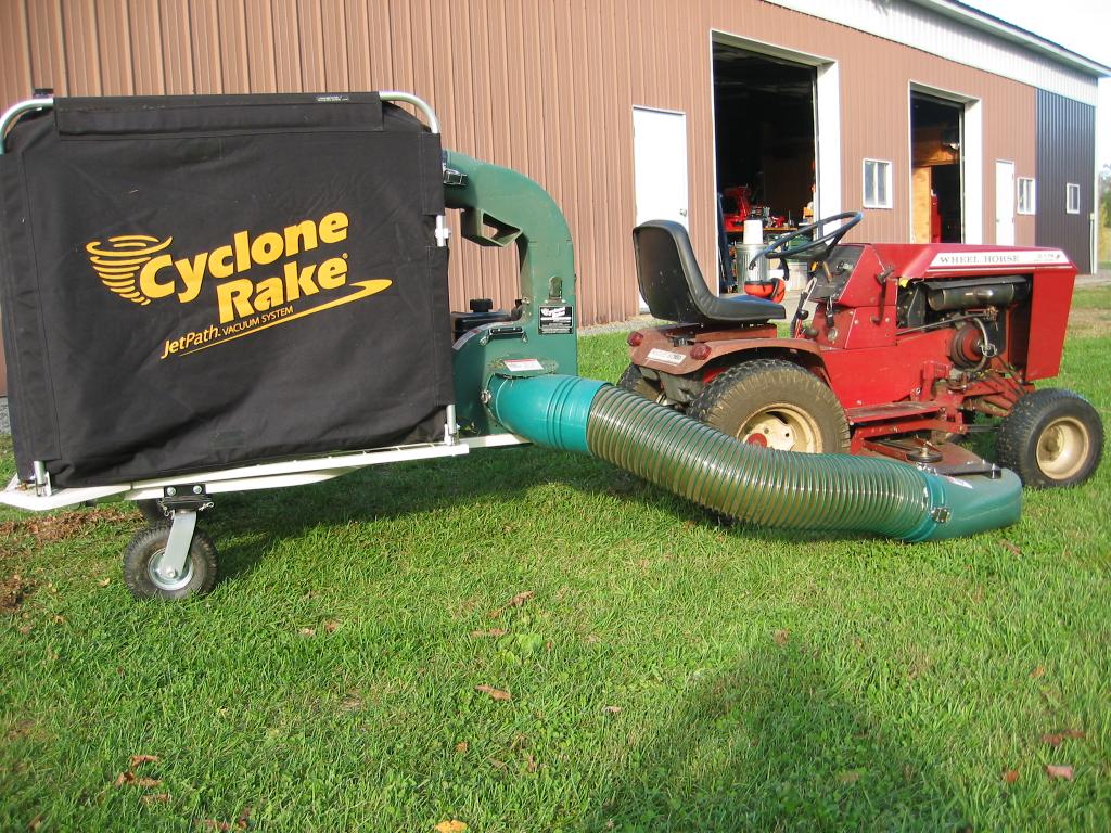

Bar Nuthin 2,257 #3 Posted November 26, 2025 This one serves double duty as a dual pin hitch for my Cyclone Rake and as a receiver hitch. I just replaced the top plates on my plow bracket. 2 1 Share this post Link to post Share on other sites

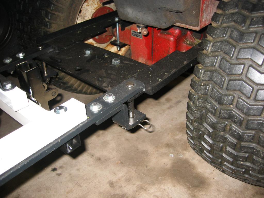

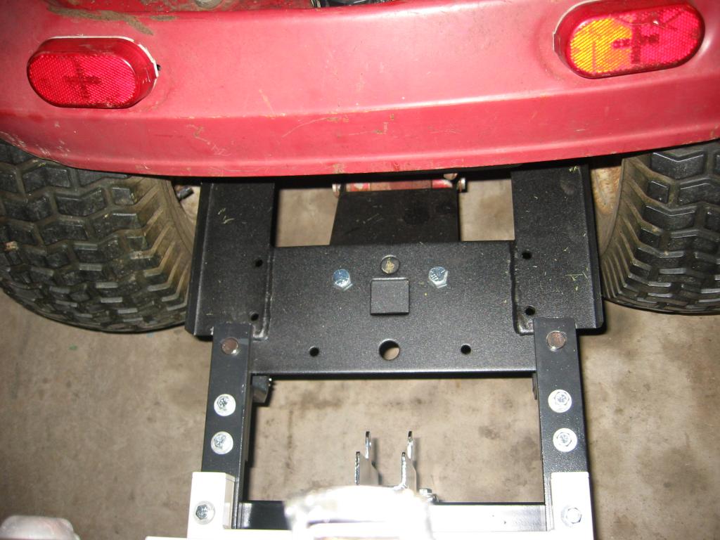

pfrederi 20,147 #4 Posted November 26, 2025 This is the hitch I got with my cyclone rake from Woodland 2 Share this post Link to post Share on other sites

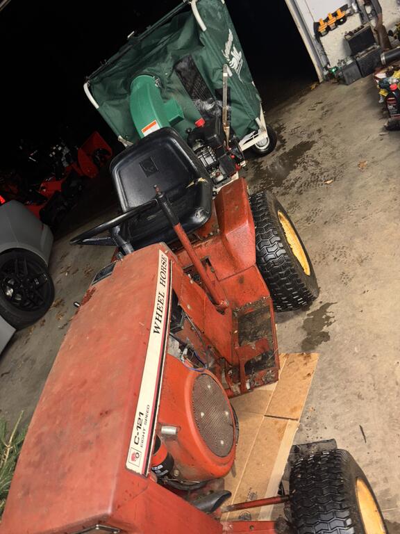

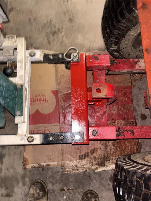

TonyToro Jr. 2,403 #7 Posted November 30, 2025 Sorry didn’t post for the last few days. Wednesday got the impelled mounted and all out together. Luckily it all came apart. On Friday we took a trip to West Haven CT to the cyclone rake factory and picked up the impeller and bag tube I was missing. Today we brought it in and we’re looking and decided to use the original mounted bracket for some other machine the PO had it mounted to. We welded that on to my additional hitch I had on my tractor and we are in business. Tomorrow give it a quick carb clean since it was leaking before when we had it running and suck up the leaves before the snow! 1 Share this post Link to post Share on other sites
TonyToro Jr. 2,403 #8 Posted December 1, 2025 Just did the first drive down to the barn and man this thing is gunna take some getting used too Share this post Link to post Share on other sites
