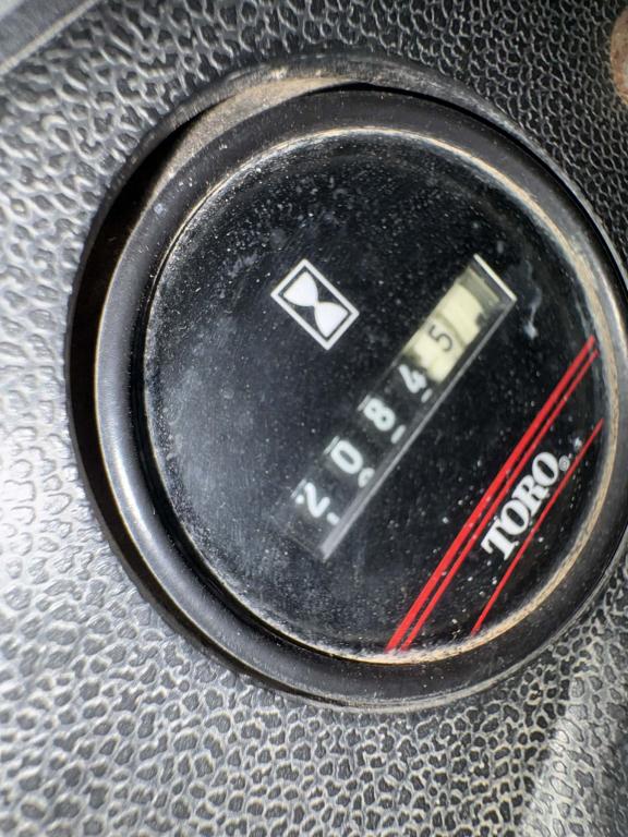

enticer 340 1 #9 Posted November 27, 2025 (edited) On 11/25/2025 at 7:51 PM, ri702bill said: Welcome! I do not own one, but I have read enough posts describing both. How many hours on the engine?? I ask because the dreaded loose valve seat issue seems to show up mostly in machines with a lot of hours... the engine has more then 2000 hours on it, the hour meter stoped working since the fuse blew up Edited November 27, 2025 by enticer 340 Share this post Link to post Share on other sites
