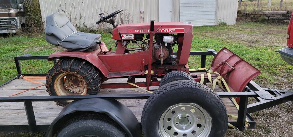

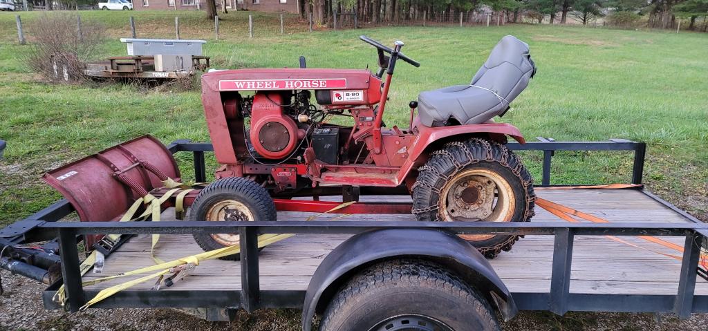

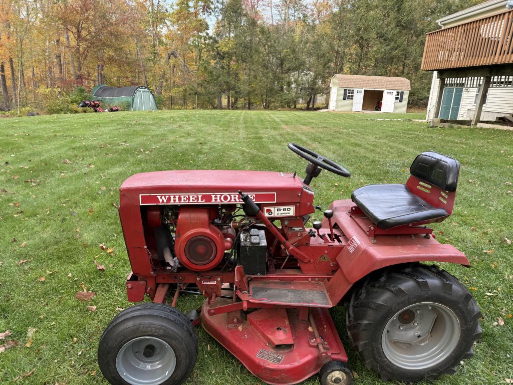

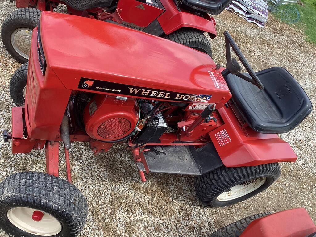

BradKahler 407 #1 Posted November 24, 2025 Well....I was browsing Marketplace looking for Wheel Horse parts and ran cross a tractor that was 16 miles from me. I'm not sure why but I ended up buying it It's a 1975 and came with the snow plow and a 36" mower deck. It came out of Ohio but it doesn't look like it was ever really stored outside. It runs although the engine has hesitation issues and stumbles when at higher rpms. I did time the engine and it helped but I'm guessing the carburetor needs cleaning as well. 7 9 1 Share this post Link to post Share on other sites
Achto 32,705 #2 Posted November 24, 2025 (edited) 40 minutes ago, BradKahler said: I'm not sure why but I ended up buying it No worries. This kind of thing happens all the time around here. Once you have one , you kind of want one of each model. BTW. Nice looking tractor. Edited November 24, 2025 by Achto 7 1 Share this post Link to post Share on other sites
ri702bill 13,067 #3 Posted November 24, 2025 (edited) And I see that it has a "Husher" hammerhead muffler. Had one on a Commando 800, but it was way too far gone. Even the 2 spoke steering wheel looks to be in great shape - a rare find. You've got an early B80 with the 4 speed, later ones had the 8 speed like a C81. A great workhorse that sips fuel. Edited November 24, 2025 by ri702bill 5 Share this post Link to post Share on other sites

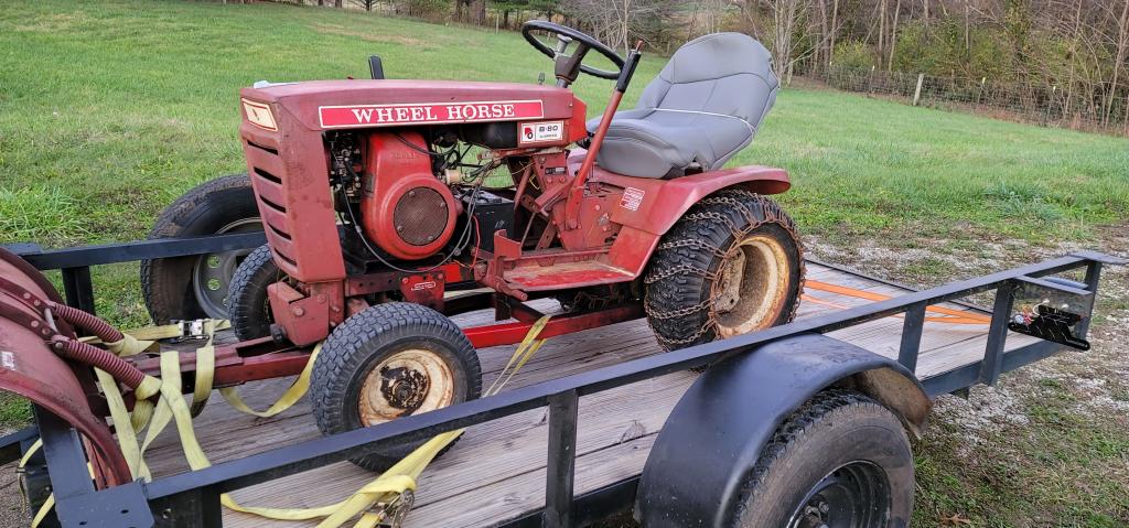

Handy Don 17,474 #4 Posted November 24, 2025 Running K-181, Two spoke steering wheel, captive quadrant blade (room for drilling out to have five rotate positions if it didn’t come that way), 2-link, well-fitted chains? Score! Seat? Trade up. 3 1 Share this post Link to post Share on other sites
ebinmaine 80,709 #5 Posted November 24, 2025 2 hours ago, BradKahler said: I'm not sure why but I ended up buying it 1 hour ago, Achto said: No worries. This kind of thing happens all the time around here. Once you have one , you kind of want one of each model. Agreed. 1 hour ago, Achto said: BTW. Nice looking tractor. Also Agreed. The B80s from 1974 to 77 are great workers. 👍 4 Share this post Link to post Share on other sites

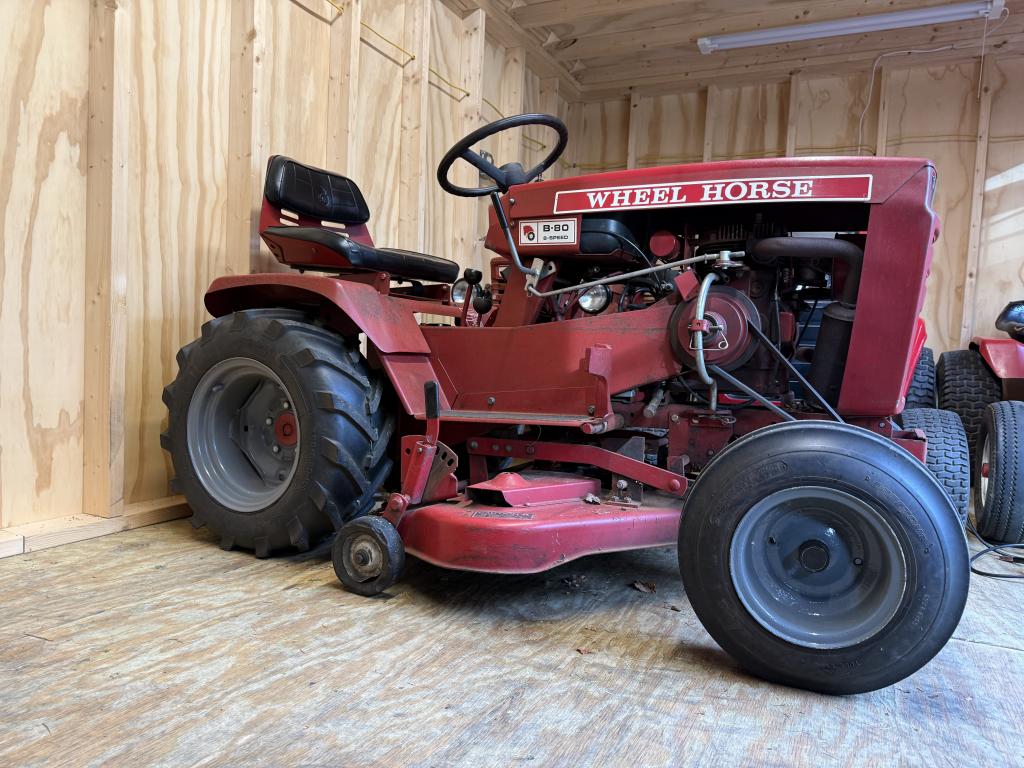

Sparky-(Admin) 26,360 #6 Posted November 24, 2025 Nice score.. and with a couple attachments I have a ‘77 B-80 and she’s a great machine! Mowed occasionally with the 36” RD and then get hosed off and dragged to the local tractor shows 3 6 Share this post Link to post Share on other sites

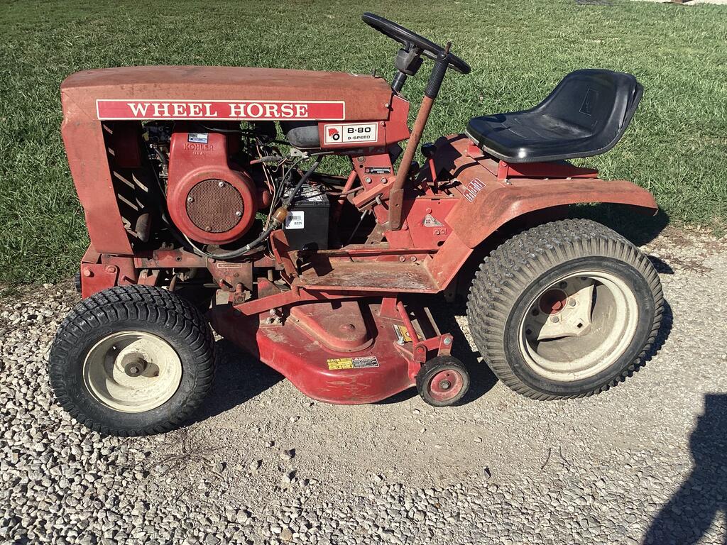

953 nut 69,315 #7 Posted November 25, 2025 5 hours ago, BradKahler said: engine has hesitation issues and stumbles when at higher rpms. If an engine idles well, but runs erratically when revved up, like it hits and misses, pops and backfires, then chances are, it needs a new condenser/capacitor. And always install a condenser/capacitor with the wire facing downward so rain water and/or when washing off engine, water will not enter inside condenser/capacitor, ruining it. With water inside the condenser, this will also allow it to idle well, but cause it to run erratically when revved up. 1 1 1 Share this post Link to post Share on other sites

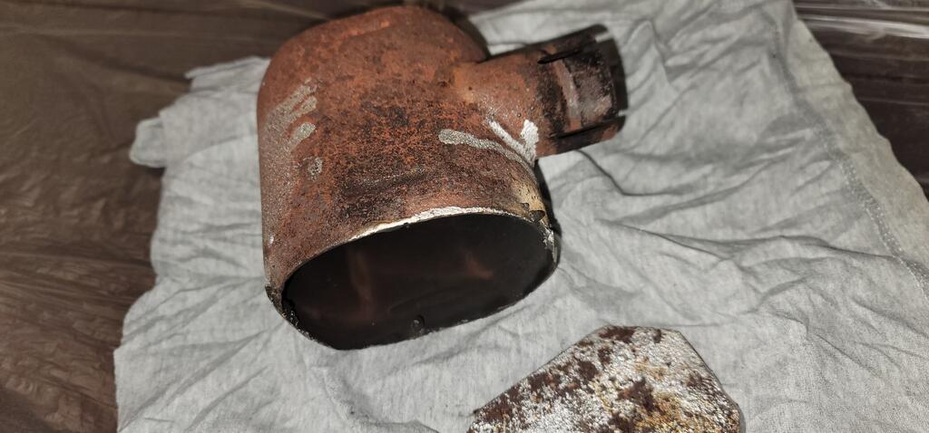

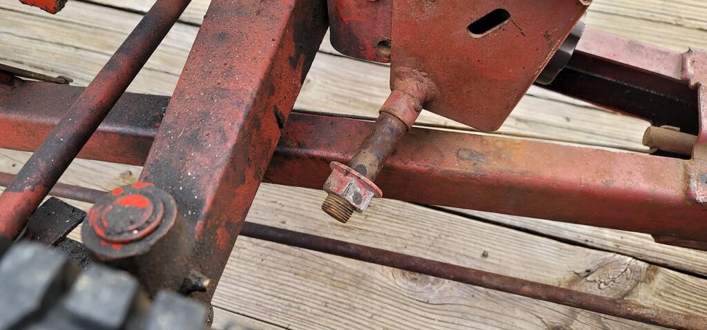

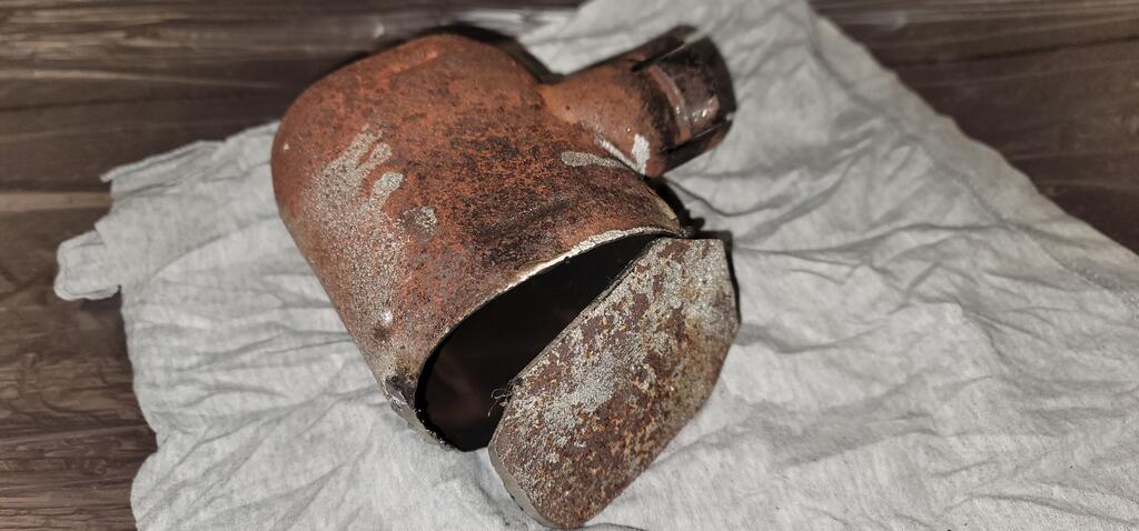

BradKahler 407 #9 Posted November 25, 2025 4 hours ago, ri702bill said: And I see that it has a "Husher" hammerhead muffler. Had one on a Commando 800, but it was way too far gone. Even the 2 spoke steering wheel looks to be in great shape - a rare find. You've got an early B80 with the 4 speed, later ones had the 8 speed like a C81. A great workhorse that sips fuel. The condition of the muffler turned out to be not what I was expecting. The previous owner had welded a plate over one end of the muffler. I thought it was to keep the exhaust from blowing into the drivers face. So I removed the plate and found that the baffle an grill was missing So now I have to come up with some sort of replacement. I'd like to use the Gravely muffler but I'm leery of trying to remove the pipe nipple in the block. 2 1 Share this post Link to post Share on other sites
BradKahler 407 #10 Posted November 25, 2025 4 hours ago, Handy Don said: Running K-181, Two spoke steering wheel, captive quadrant blade (room for drilling out to have five rotate positions if it didn’t come that way), 2-link, well-fitted chains? Score! Seat? Trade up. Thanks! Could you enlighten me about the captive quadrant blade? Share this post Link to post Share on other sites
ebinmaine 80,709 #11 Posted November 25, 2025 2 minutes ago, BradKahler said: leery of trying to remove the pipe nipple in the block. Not as difficult as you'd think. The pipe stub could be removed using a cut n crush method. There are threads describing the procedure. 9 minutes ago, BradKahler said: That's what scares me Don't be concerned. Just build a bigger workshop. 2 1 Share this post Link to post Share on other sites

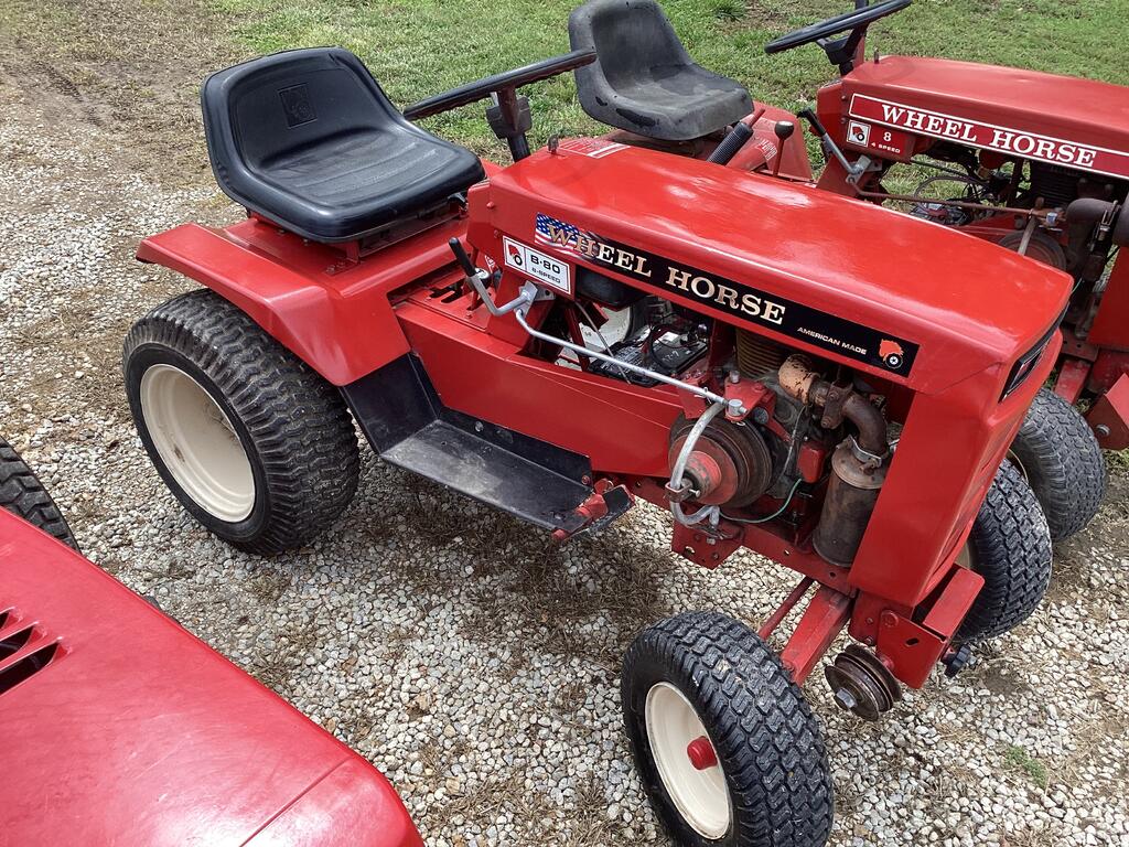

BradKahler 407 #12 Posted November 25, 2025 (edited) 3 hours ago, Sparky said: Nice score.. and with a couple attachments I have a ‘77 B-80 and she’s a great machine! Mowed occasionally with the 36” RD and then get hosed off and dragged to the local tractor shows Thanks! Where did you get that muffler/exhaust setup? Edited November 25, 2025 by BradKahler Share this post Link to post Share on other sites
Achto 32,705 #13 Posted November 25, 2025 (edited) 11 hours ago, BradKahler said: I'm leery of trying to remove the pipe nipple in the block. Hose the nipple down with some penetrating fluid in the morning and go about your day and night. When you get back to it, tap on the pipe several times with a hammer before trying to un-thread it. If worse comes to worse you can always use the cut & crush method. Edited November 25, 2025 by Achto 2 Share this post Link to post Share on other sites
BradKahler 407 #14 Posted November 25, 2025 42 minutes ago, 953 nut said: If an engine idles well, but runs erratically when revved up, like it hits and misses, pops and backfires, then chances are, it needs a new condenser/capacitor. And always install a condenser/capacitor with the wire facing downward so rain water and/or when washing off engine, water will not enter inside condenser/capacitor, ruining it. With water inside the condenser, this will also allow it to idle well, but cause it to run erratically when revved up. Good info! You pretty much described how it's running, although it doesn't really backfire. I cleaned up the points today and set the timing but I don't like the looks of the points themselves. I'll go ahead and replace the points and condenser and see what happens. Thanks! 2 Share this post Link to post Share on other sites
Achto 32,705 #15 Posted November 25, 2025 5 minutes ago, BradKahler said: Where did you get that muffler/exhaust setup? He has a factory Nelson muffler. 1 Share this post Link to post Share on other sites
BradKahler 407 #16 Posted November 25, 2025 4 minutes ago, Achto said: Hose the nipple down with some penetrating fluid in the morning and go about your day and night. When you get back to it tap on the pipe several times with a hammer before trying to un-thread it. I worse comes to worse you can always use the cut & crush method. Somewhere in my shop hidden away I've got a gallon can of kroil. I guess it's time to find it and put it to use.... 1 Share this post Link to post Share on other sites

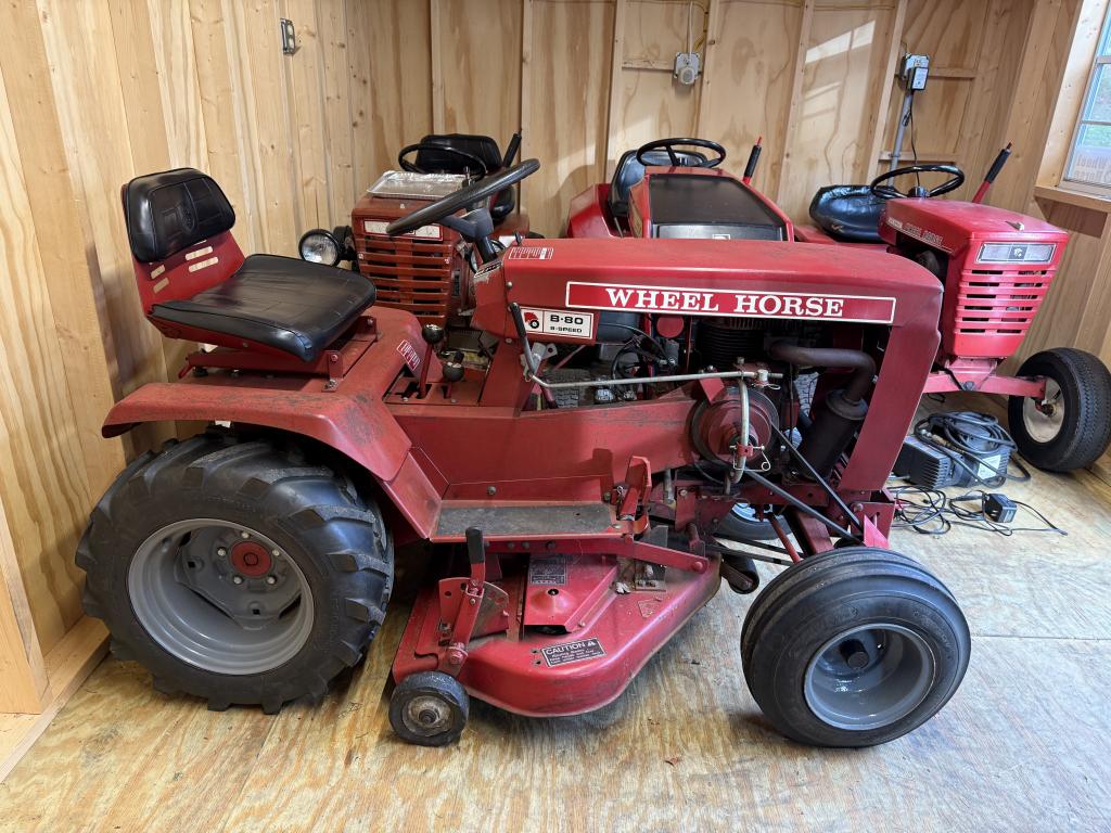

Easton Rich 1,260 #17 Posted November 25, 2025 I love my B-80’s. They are great workers! Good luck! 5 2 Share this post Link to post Share on other sites
Sparky-(Admin) 26,360 #18 Posted November 25, 2025 11 minutes ago, BradKahler said: Thanks! Where did you get that muffler/exhaust setup? That’s the stock setup on mine. Share this post Link to post Share on other sites
BradKahler 407 #19 Posted November 25, 2025 5 minutes ago, Achto said: He has a factory Nelson muffler. So that's what the Nelson muffler looks like. I've read about references to a Nelson muffler but couldn't figure out what they looked like. I'm guessing they are NLA. 1 Share this post Link to post Share on other sites
Sparky-(Admin) 26,360 #20 Posted November 25, 2025 Just now, BradKahler said: So that's what the Nelson muffler looks like. I've read about references to a Nelson muffler but couldn't figure out what they looked like. I'm guessing they are NLA. You could fine a used one I’m sure 1 Share this post Link to post Share on other sites
BradKahler 407 #21 Posted November 25, 2025 3 minutes ago, Easton Rich said: I love my B-80’s. They are great workers! Good luck! Wow nice! A small herd of them What is the small double pulley and cover box for? Mine has the box and the shaft although the shaft is mangled. Share this post Link to post Share on other sites
Easton Rich 1,260 #22 Posted November 25, 2025 That’s your mule drive. You only need it if you wanna run a deck. I’ve got some if you want a better one. 2 1 Share this post Link to post Share on other sites

BradKahler 407 #24 Posted November 25, 2025 25 minutes ago, Sparky said: You could fine a used one I’m sure I just did a quick ebay search and the prices for used mufflers is insane I like the looks of the Gravely muffler as well, and it's available for about $55 delivered. That would likely be the easiest and cheapest, assuming I can get the pipe nipple out. Share this post Link to post Share on other sites

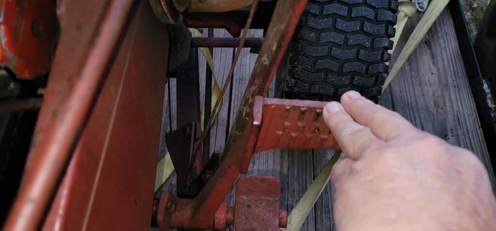

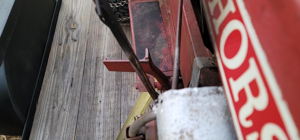

BradKahler 407 #25 Posted November 25, 2025 There is an issue with the brake pedal when pushing on it, it hits the lever for the blade. My best guess is the blade lever is bent to a position where it shouldn't be. Share this post Link to post Share on other sites
