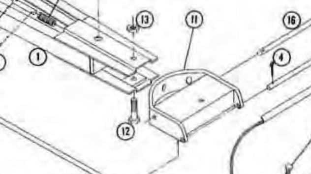

Handy Don 17,175 #52 Posted November 26, 2025 Your blade quadrant resembles the curved #11 in the IPL clip below. This early one shows 3 holds--left, center, and right for positioning the blade straight rotated to either side. Some later models came with 5 holes with the extras being left and right of the center halfway to the “outer” holes. Some members with a 3 drilled it to become a 5 and are quite pleased with the extra positions. (Note that blades before 1964 had a different style of quadrant) 1 1 Share this post Link to post Share on other sites

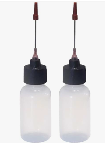

Handy Don 17,175 #53 Posted November 26, 2025 3 hours ago, BradKahler said: Yep, it penetrates so well, the plastic spray bottles leak like a sieve. I wish I could find a spray bottle that would work with it. You won’t. I ended up “decanting" my penetrant into little 2 oz. bottles like these. I can drip or squirt. 5 Share this post Link to post Share on other sites

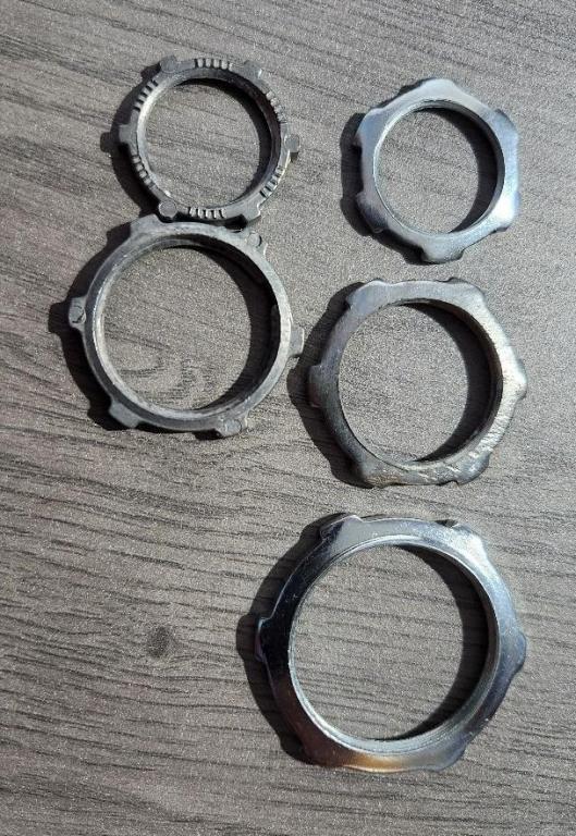

953 nut 68,134 #55 Posted November 26, 2025 19 hours ago, Racinbob said: Using the locknuts lets me not tighten the nipple as much for future removal Lock nut is the way to go but be sur to get a top quality electrical conduit lock nut from an electrical supply house, do not buy the junk ones being sold at big box stores. 2 Share this post Link to post Share on other sites
BradKahler 391 #56 Posted November 26, 2025 9 hours ago, Handy Don said: Your blade quadrant resembles the curved #11 in the IPL clip below. This early one shows 3 holds--left, center, and right for positioning the blade straight rotated to either side. Some later models came with 5 holes with the extras being left and right of the center halfway to the “outer” holes. Some members with a 3 drilled it to become a 5 and are quite pleased with the extra positions. (Note that blades before 1964 had a different style of quadrant) Ok, got it. I'll check today to see how many holes. Thanks for bringing this to my attention. Share this post Link to post Share on other sites
BradKahler 391 #57 Posted November 26, 2025 9 hours ago, Handy Don said: You won’t. I ended up “decanting" my penetrant into little 2 oz. bottles like these. I can drip or squirt. I'm glad to hear it's not just me that was having issues. I'd prefer drip bottles over spray bottles anyway, less mess. Thanks! Share this post Link to post Share on other sites
BradKahler 391 #58 Posted November 26, 2025 52 minutes ago, 953 nut said: Lock nut is the way to go but be sur to get a top quality electrical conduit lock nut from an electrical supply house, do not buy the junk ones being sold at big box stores. There are only two big box stores in my area and I don't know of any electrical supply houses within reasonable distance Would this style lock nut work? https://www.amazon.com/Brass-Pipe-Fitting-Locknut-Female/dp/B07QM8T78V 1 Share this post Link to post Share on other sites
953 nut 68,134 #59 Posted November 26, 2025 5 minutes ago, BradKahler said: There are only two big box stores in my area and I don't know of any electrical supply houses within reasonable distance Would this style lock nut work? https://www.amazon.com/Brass-Pipe-Fitting-Locknut-Female/dp/B07QM8T78V No, you want a steel locknut. Most of the ones at big box stores are cast pot metal or thin stamped steel. Home Depot or ACE may have steel locknuts for ridged conduit. Share this post Link to post Share on other sites
BradKahler 391 #60 Posted November 26, 2025 15 minutes ago, 953 nut said: No, you want a steel locknut. Most of the ones at big box stores are cast pot metal or thin stamped steel. Home Depot or ACE may have steel locknuts for ridged conduit. Turns out I was using the wrong search words on Amazon. I was searching for NPT pipe nuts, I should have been searching for electrical conduit nuts. https://www.amazon.com/Hubbell-Raco-1194B2-Locknut-1-Inch-Conduit/dp/B00G9IR596? Share this post Link to post Share on other sites
Racinbob 13,085 #61 Posted November 26, 2025 (edited) Steel (on the right), not brass or pot metal. They can be found at the big boxes. Like Richard said, often tagged for rigid conduit. Sigma ProConnex 1-in Rigid / IMC Zinc-plated Steel Conduit Locknut Conduit Fittings (2-Pack) 49103 at Lowes.com Edited November 26, 2025 by Racinbob 1 Share this post Link to post Share on other sites
BradKahler 391 #62 Posted November 26, 2025 6 minutes ago, Racinbob said: Steel (on the right), not brass or pot metal. They can be found at the big boxes. Like Richard said, often tagged for rigid conduit. Sigma ProConnex 1-in Rigid / IMC Zinc-plated Steel Conduit Locknut Conduit Fittings (2-Pack) 49103 at Lowes.com Thanks. You can definitely see the casting marks on the ones on the left. I'm going to swing by Lowes today to see what they might have in stock. 1 Share this post Link to post Share on other sites
953 nut 68,134 #63 Posted November 26, 2025 (edited) 26 minutes ago, BradKahler said: Turns out I was using the wrong search words on Amazon. I was searching for NPT pipe nuts, I should have been searching for electrical conduit nuts. https://www.amazon.com/Hubbell-Raco-1194B2-Locknut-1-Inch-Conduit/dp/B00G9IR596? That is a ridiculously high price, go to lowes, Home Depot, or ACE Edited November 26, 2025 by 953 nut 1 Share this post Link to post Share on other sites
BradKahler 391 #64 Posted November 26, 2025 4 minutes ago, 953 nut said: That is a ridiculously high price, go to Lowes, Home Depot, or ACE I 100% agree Around here, Lowes is the only one that stocks 1" stuff and I'm heading there after lunch. I'm finding more and more that the only place to find a lot of things is online 1 Share this post Link to post Share on other sites

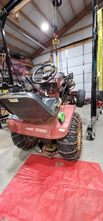

EB-80/8inPA 2,081 #66 Posted November 27, 2025 On 11/24/2025 at 8:57 PM, BradKahler said: My best guess is the blade lever is bent to a position where it shouldn't be Can’t tell from the pic but it might need to be flipped around. I had a similar problem when I mounted mine backwards one year. I have to remove the bell and do up some protective greasy sleeve for the driveshaft which seems wrong - I don’t think my blade’s control arm was meant for the B-80 but I’ll make do until a nice hydro combo comes up for sale nearby. Share this post Link to post Share on other sites
BradKahler 391 #67 Posted December 4, 2025 On 11/26/2025 at 8:06 PM, EB-80/8inPA said: Can’t tell from the pic but it might need to be flipped around. I had a similar problem when I mounted mine backwards one year. I have to remove the bell and do up some protective greasy sleeve for the driveshaft which seems wrong - I don’t think my blade’s control arm was meant for the B-80 but I’ll make do until a nice hydro combo comes up for sale nearby. The blade blade assembly isn't installed right now so I haven't been able to try this. It's possible sometime next week I'll be able to do so and I'll report back at that time. Thanks Share this post Link to post Share on other sites

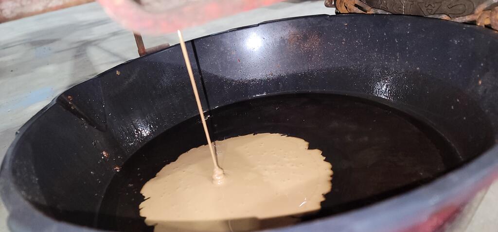

Handy Don 17,175 #69 Posted December 4, 2025 17 minutes ago, BradKahler said: 4 or 5 to 1 oil to water mix. The oil usually floats leaving the water on bottom (unless you’ve recently stirred it up) so water comes out first 17 minutes ago, BradKahler said: I'd find a small tail pipe to point the exhaust out to the side Lots of tailpipe “tips” on the car restorer supply sites. Might be hard to choose one! 😁 1 Share this post Link to post Share on other sites

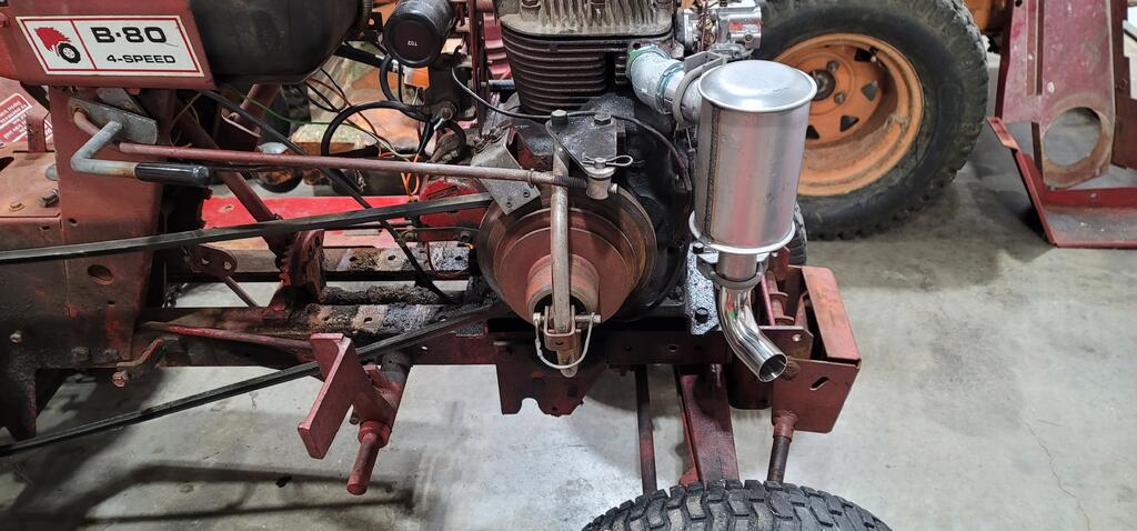

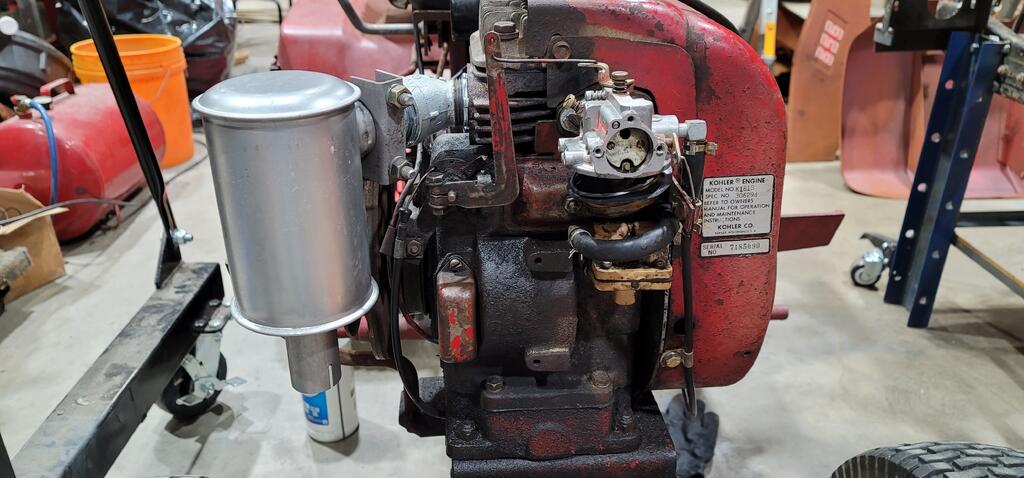

Retired Wrencher 6,901 #72 Posted December 10, 2025 (edited) On 11/24/2025 at 7:55 PM, BradKahler said: The condition of the muffler turned out to be not what I was expecting. The previous owner had welded a plate over one end of the muffler. I thought it was to keep the exhaust from blowing into the drivers face. So I removed the plate and found that the baffle an grill was missing So now I have to come up with some sort of replacement. I'd like to use the Gravely muffler but I'm leery of trying to remove the pipe nipple in the block. Too bad we can’t find someone to make those shusher mufflers. They’re pretty simple design. I’ve always liked those mufflers. Edited December 10, 2025 by Retired Wrencher I was wrong. Share this post Link to post Share on other sites
BradKahler 391 #73 Posted December 10, 2025 53 minutes ago, Retired Wrencher said: Too bad we can’t find someone to make those shusher mufflers. They’re pretty simple design. I’ve always liked those mufflers. They are definitely unique looking mufflers. I'm guessing whoever blanked off one side didn't like the exhaust being blown back in their faces. I was hoping when I removed the plate the the baffles would still be there. If someone wants this muffler they are welcome to it. Share this post Link to post Share on other sites

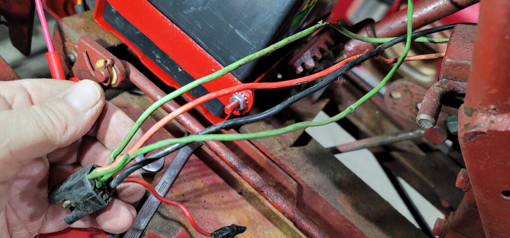

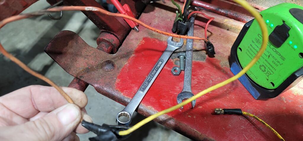

BradKahler 391 #74 Posted December 10, 2025 Yesterday I tried starting the engine after replacing the leaking fuel bowl and found the starter solenoid wasn't getting any power. The first thing I found was I didn't have the PTO lever in the disengaged position. The next thing I found was a bunch of burned and spliced wiring along with the connections to the ignition switch being in the wrong positions. I'm not sure how it had started for me previously but the wiring is a total mess. There were splices wrapped with tape. I found one wire that was spliced twice and three different colors of wire were used! The plug for the ignition switch is toast so I ordered a replacement that includes a pigtail. The ammeter was bypassed, I assumed due to a bad meter but found that the spade connector was not making contact with the post. So the ammeter is ok, I just need to replace the spade terminal. Also, the Rectifier tested bad using the Diode setting on my meter. One side is open and the other side is shorted. On the ignition switch, the (B)attery connection was on the (I)gnition terminal, the (R)ectifier connection was on the (A)ccessory terminal, the (A)ccessory connection was on the (R)ectifier terminal, and the (I)gnition terminal was on the (B)attery terminal. Looking at the switch layout diagram it doesn't look like this arrangement should really make any difference but I'll go ahead and wire in the replacement plug to match the wiring diagram. I tested the clutch safety switch and it seems to be working so today I'll dig a little deeper to see if I can figure out why no voltage was getting to the starter solenoid. Share this post Link to post Share on other sites
Handy Don 17,175 #75 Posted December 10, 2025 8 hours ago, BradKahler said: Also, the Rectifier tested bad using the Diode setting on my meter. One side is open and the other side is shorted. This isn’t clear to me, can you explain further how you tested? Do you have a rectifier bridge or a voltage regulator there? Bridges are easily tested with a VOM using either the DCV setting and a battery or else the diode setting sans battery. But a VR is isn’t really testable with VOM alone--it needs both an AC input and a 12v reference supply. Many of the the VRs that I’ve encountered (including on both the Onan P218 and P220) have one of the stator terminals directly tied to the 12v output terminal. That could look like a short. Share this post Link to post Share on other sites
