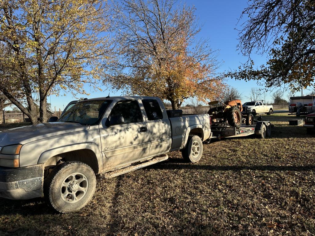

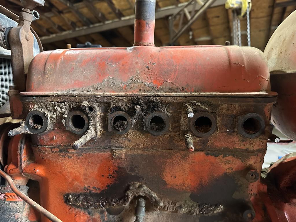

ClassicTractorProfessor 5,455 #1 Posted November 24, 2025 Last Tuesday night I couldn’t sleep, no matter what I tried I just could not go to sleep, so while laying there awake browsing Facebook I stumbled upon an ad for an online auction. And for once it was 100 miles away, not 1000. Started browsing through the listings and stumbled across this little Allis Chalmers B with only 2 bids on it. It looked rough but I could maybe see some potential in it, and I’ve always wanted a B. So I put in my max bid and went about my business. Thursday night I get an email from the auction co with an invoice for $319…$290 for the tractor and $29 for buyers premium (I hate that they charge seller and buyer premium on online sales, but I won’t get on that rant tonight). Paid the invoice, then remembered my trailer is 100 miles away still at the show grounds along with the WD. Saturday morning I made the trip to the show grounds, loaded up the WD and brought it back to the farm. First 200 mile round trip for the day done…headed out for the second trip to pick up the B. Let’s just say when I got there it was a “little” rougher than I originally thought. But oh well we bought it let’s load it up and get it home. Got home too late last night to mess with unloading it. Fired up the 1940 Farmall A today and drug it off the trailer and into the shop. Started tearing in to it and yeah it’s ROUGH. But we like a challenge around here and I promised the seller that grandads tractor wasn’t going to scrap so we are gonna do our best to try to save it. Here’s the first of probably many videos on the project. With a torch, hopes & prayers, and maybe a tetanus booster she will live again. Stay tuned and enjoy! We Brought Home an Allis B… and Immediately Regretted It 😂 https://youtu.be/PyBvPMV89jY 4 5 Share this post Link to post Share on other sites

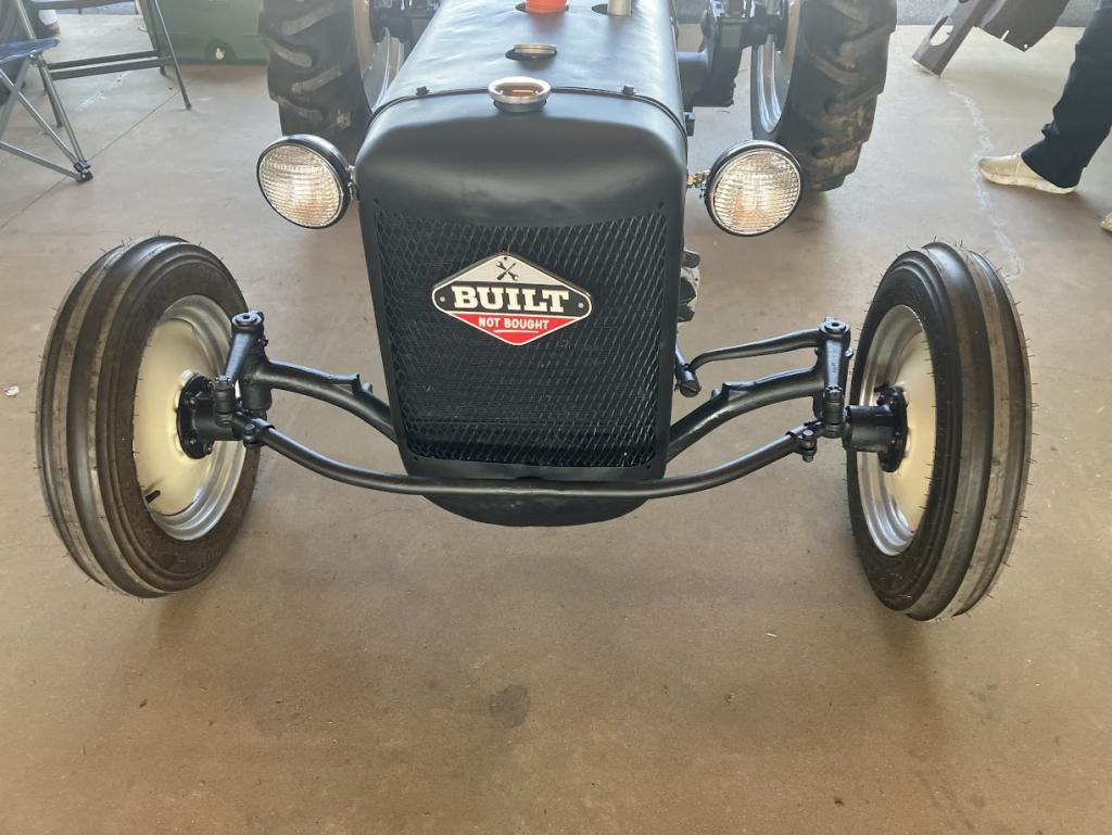

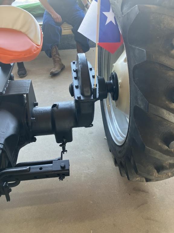

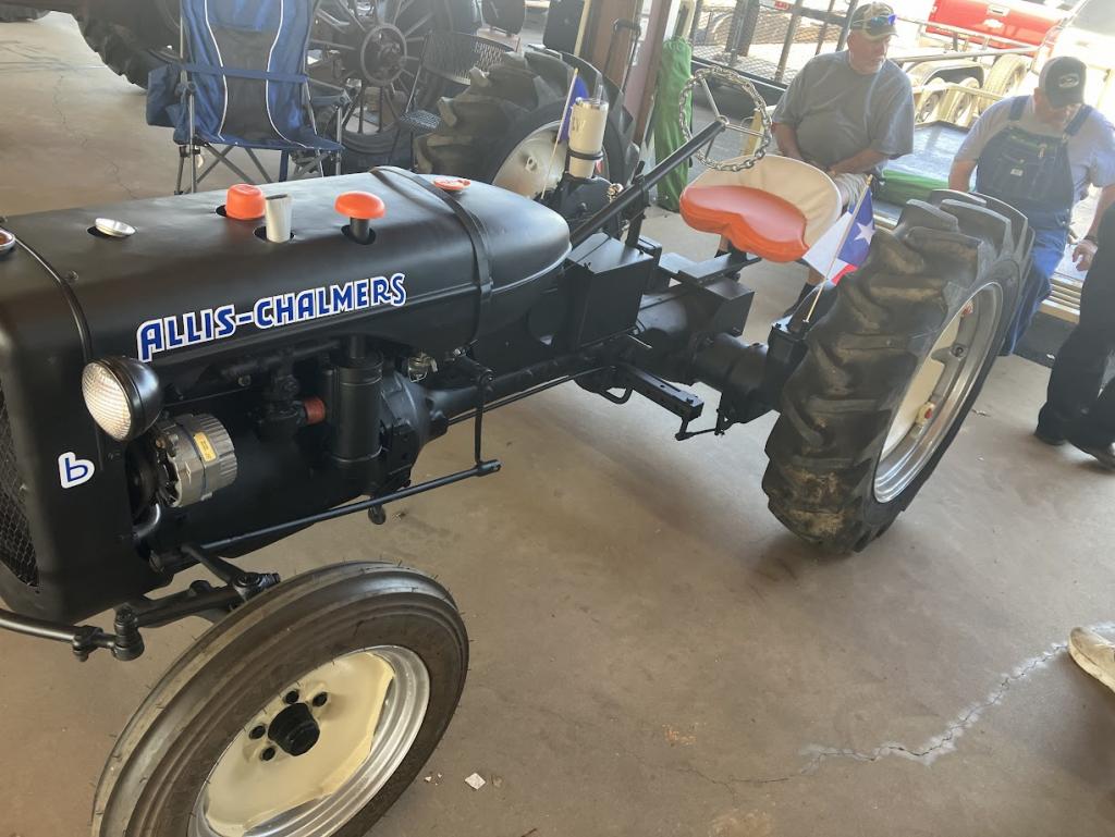

oliver2-44 11,751 #8 Posted November 24, 2025 Here's an really cool hot rod Allis idea for ya I saw at the Canton Tractor Show last Spring. Owner said front axle and rear drops swapped over with no changes. Said he only had to modify the side steering rod. 2 1 1 Share this post Link to post Share on other sites

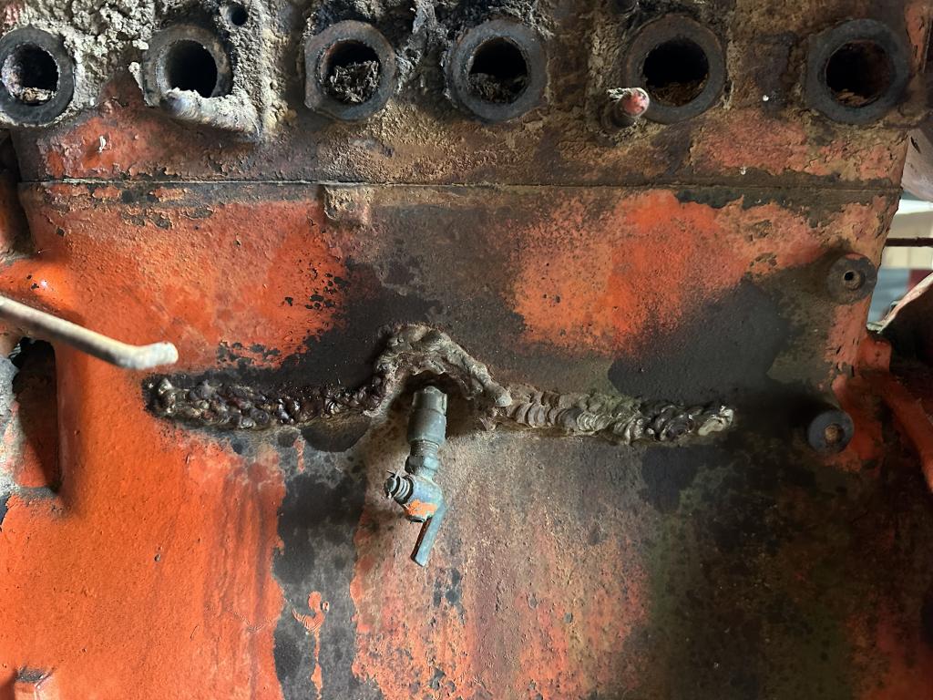

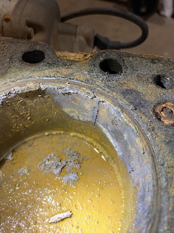

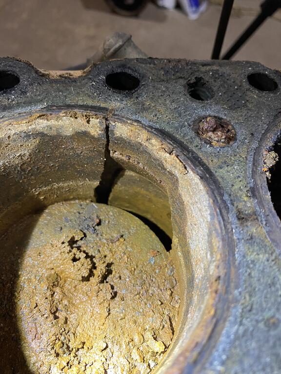

ClassicTractorProfessor 5,455 #9 Posted November 25, 2025 Didn’t get to work on the B tonight. Boss needed to borrow my MIG welder so I made a trip to the farm to grab it and straight back to town. I did walk over and look at it again as I was questioning my sanity and discovered something I didn’t notice yesterday. My best guess is that water got in the middle two cylinders through the exhaust, then froze and busted the sleeves. At first I thought it was water in the cooling jackets, but the more I think about it the busted sleeve is heaved outward into the block, so it had to be water inside the cylinder that froze. Busted sleeve is on cyl 3 but cyl 2 is cracked as well. Next step is going to be pulling the engine getting it on a stand and opening up the bottom end. Almost afraid of what we’re gonna find when we pull the pan off. 1 2 Share this post Link to post Share on other sites

oliver2-44 11,751 #11 Posted November 26, 2025 In high school Ag Mechanics shop we overhauled an Allis A. Using new sleeves. After it ran a few hours, water in oil. Over the next two year the sleeves came out of that poor thing numerous times. The O-ring at the bottom of one sleeve, then another, then another had nicks in them. The mating parts at the bottom of the block and the sleeve groove were honed multiple times to break the edge and remove any burrs. They finally just put a couple of cans of radiator stop leak in it and it fixed it. 1 Share this post Link to post Share on other sites
