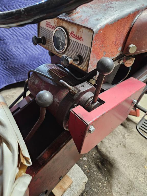

Mike'sHorseBarn 3,645 #1 Posted November 22, 2025 I've posted about this thing before. Its leaked ever since I got it due to the hole where the input shaft is being wallowed out. I've done seals may times, but i'm just sick of it making a mess of the tractor. Im thinking about taking it off amd putting a manual lift on, but that almost ruins the tractor. Would anyone have a pump that is in better shape than this one i could swap out? Thoughts on the whole ordeal?? 4 Share this post Link to post Share on other sites
ri702bill 12,690 #2 Posted November 22, 2025 (edited) I too have a HY-2 that needed a return spring, so I got the whole Kit from Lowell. The shaft seal was correct but did not fit the housing. I contacted him - after measuring it, we agree that the housing seal bore was machined out to be one size larger for the OD of the seal, with the same original ID. I had to source one - it works fine. That may work for you.... The shaft bore on mine looks original, yours may need a bushing... Edited November 22, 2025 by ri702bill Share this post Link to post Share on other sites

953 nut 68,134 #4 Posted November 22, 2025 11 hours ago, Mike'sHorseBarn said: leaked ever since I got it due to the hole where the input shaft is being wallowed out. I've done seals may times Could you drill it out and press in a bronze bushing and then put in a new seal? 3 Share this post Link to post Share on other sites
Mike'sHorseBarn 3,645 #5 Posted November 22, 2025 10 hours ago, 953 nut said: Could you drill it out and press in a bronze bushing and then put in a new seal? That's what Id like to do, but I dont have good enough equipment to do so. If I knew if a machine shop in pa that would do it I'd take it there. 2 Share this post Link to post Share on other sites
adsm08 4,895 #6 Posted November 23, 2025 I know a place in Carlisle that might be able to do something wit it, but it probably won't be cheap. Share this post Link to post Share on other sites
oliver2-44 11,656 #7 Posted November 23, 2025 I've used Locktite 660 for some gap filling situations. So for what its worth, I asked AI to suggest a product to fill the gap around the outside of a seal in a worn bore and it suggested Locktite 660 as well. My Oliver Backhoe had a hydraulic cylinder top shaft end seal area was pitted. I embedder the seal in a thin film of JB Well. it has lasted 20+years. I seem to recall heating the part on the gas grill to burn all the oil out of the metal. Share this post Link to post Share on other sites
