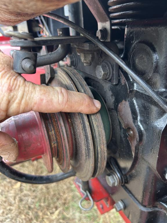

Mattrix 1 #1 Posted November 21, 2025 hello everyone. Im new to the world of wheel horses. Always wanted one but never had the opportunity. Just purchased my first wheel horse and the main drive pulley on the motor has some play in it. Fella i bought it from said it was supposed to be that way. Just wanted to verify if that is true. Everyone have a very blessed day 1 Share this post Link to post Share on other sites

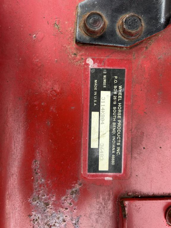

ri702bill 10,954 #2 Posted November 21, 2025 Welcome! But we can't do anything without knowing which model tractor. Perhaps a few closeup pictures of the item in question?? 2 Share this post Link to post Share on other sites
Mattrix 1 #3 Posted November 21, 2025 Sorry. Rookie mistake. Lol Share this post Link to post Share on other sites
pfrederi 19,455 #4 Posted November 21, 2025 The outer cone shaped part will move in and out and spin freely with the PTO disengaged. The part your finger tip is on should not move. 1 Share this post Link to post Share on other sites
Mattrix 1 #5 Posted November 21, 2025 Ok thank you. I didn’t figure it should. I’ll pull it apart. Thank you for your help Share this post Link to post Share on other sites
ri702bill 10,954 #6 Posted November 21, 2025 OK - so I's seeing the bell style PTO on a black Kohler Magnum. DO download the IPL manual for your tractor;it has the exploded views to help you figure how it goes together. As mentioned, the inner most pulley and clutch disc should not move with the engine off as they are keyed and fastened to the output shaft of the engine. The rest is free to rotate on its own. 1 Share this post Link to post Share on other sites
