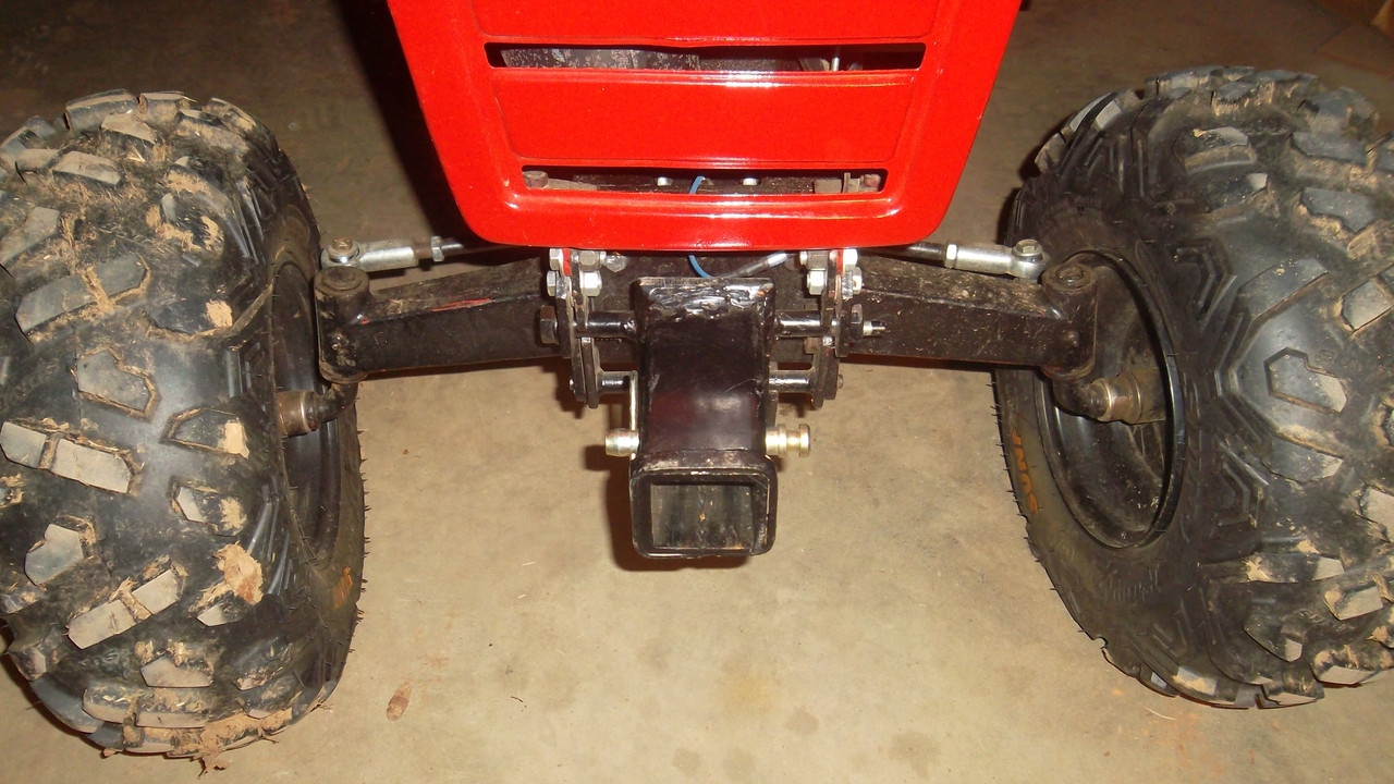

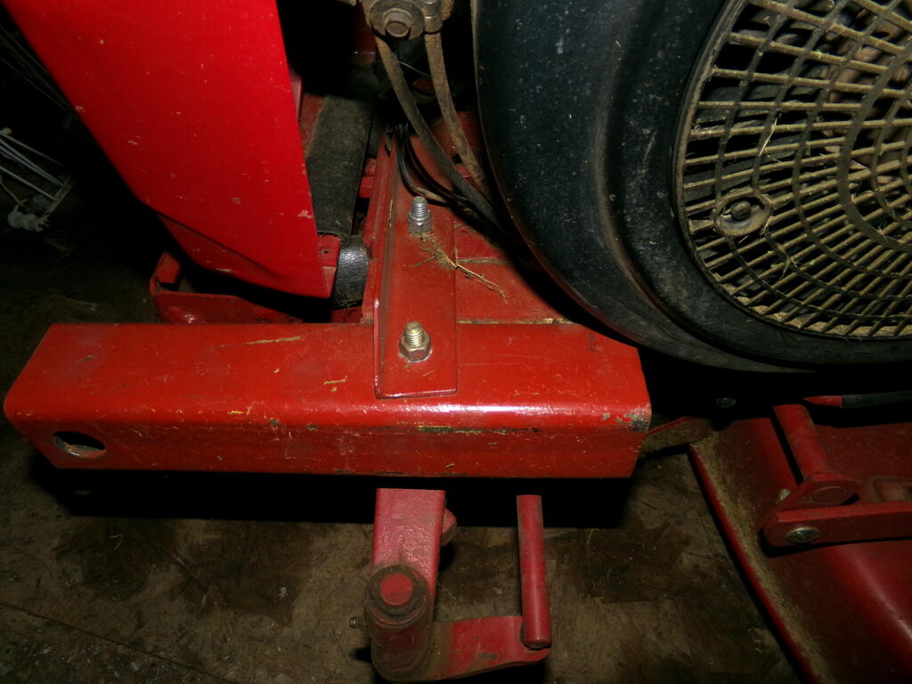

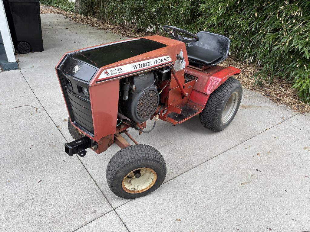

Ed Kennell 45,524 #2 Posted November 21, 2025 I mounted the receiver on the left side of my 312H. I can still use the mule drive and deck and fully open the hood. Best of all, I can see the ball when lining up to the trailer hitch. 5 2 Share this post Link to post Share on other sites

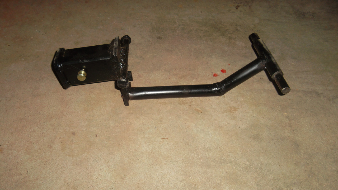

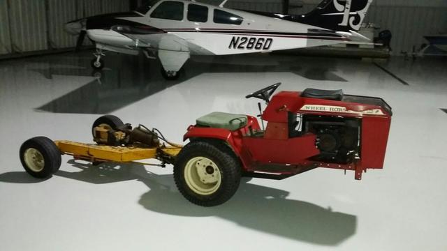

SylvanLakeWH 30,923 #3 Posted November 21, 2025 Here's mine... Made out of a mule drive... pops on and off quick. 7 Share this post Link to post Share on other sites

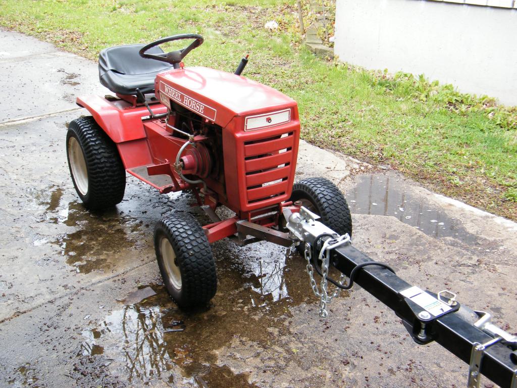

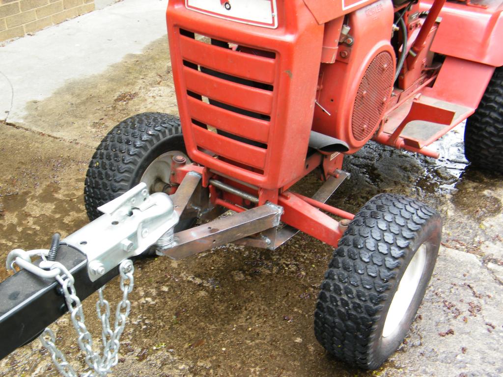

Chaz54 99 #4 Posted November 21, 2025 Here are a couple of threads from previous posts: 3 Share this post Link to post Share on other sites

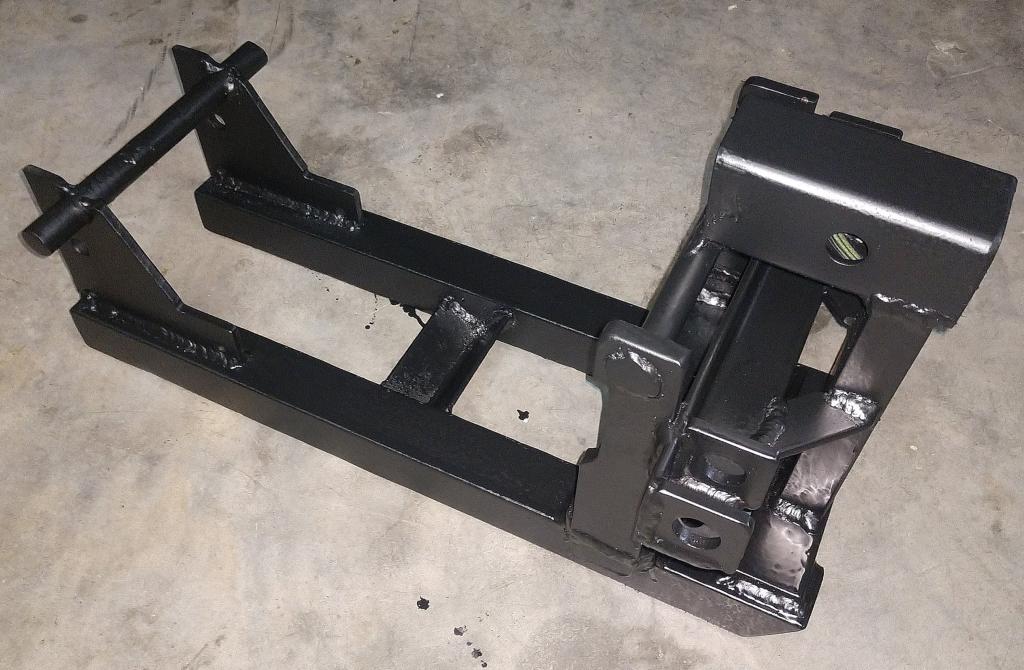

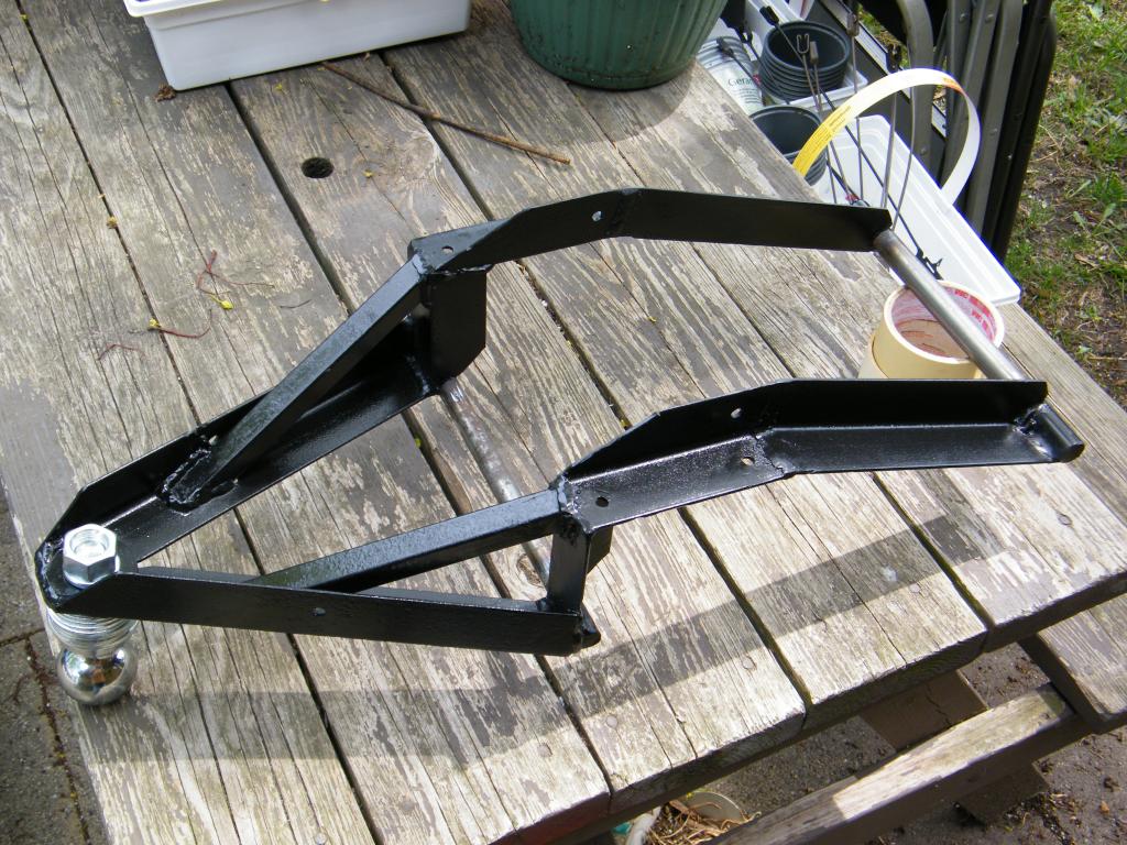

stevasaurus 23,656 #5 Posted November 21, 2025 This front hitch is built a little different, but it is strong, comes right off and works great. 4 5 Share this post Link to post Share on other sites
CRE1992 143 #6 Posted November 21, 2025 23 minutes ago, stevasaurus said: This front hitch is built a little different, but it is strong, comes right off and works great. Nice design, looks heavy duty! I might have to copy this one. 3 1 1 Share this post Link to post Share on other sites
ri702bill 11,617 #7 Posted November 22, 2025 Steve - it looks complicated, but it is nice that it ties into both the front and mid mounting points. Is it user friendly or a PITA to attach?? Can you mount one end then swing the other up or do you have to do both at the same time?? Share this post Link to post Share on other sites
kpinnc 17,575 #8 Posted November 22, 2025 (edited) 34 minutes ago, ri702bill said: Can you mount one end then swing the other up or do you have to do both at the same time?? Mine is not as refined, but attaches in the belly first and the front swings up and locks. Definitely better attaching in both places if for some reason the trailer is lighter at the nose. Edited November 22, 2025 by kpinnc 3 4 Share this post Link to post Share on other sites

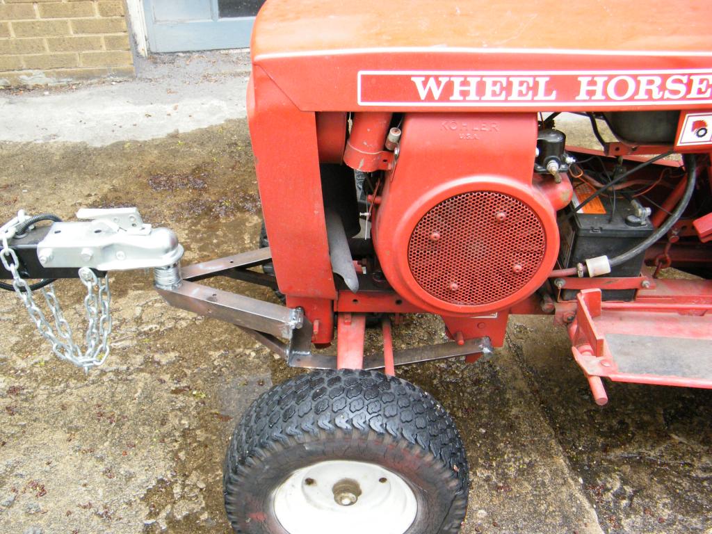

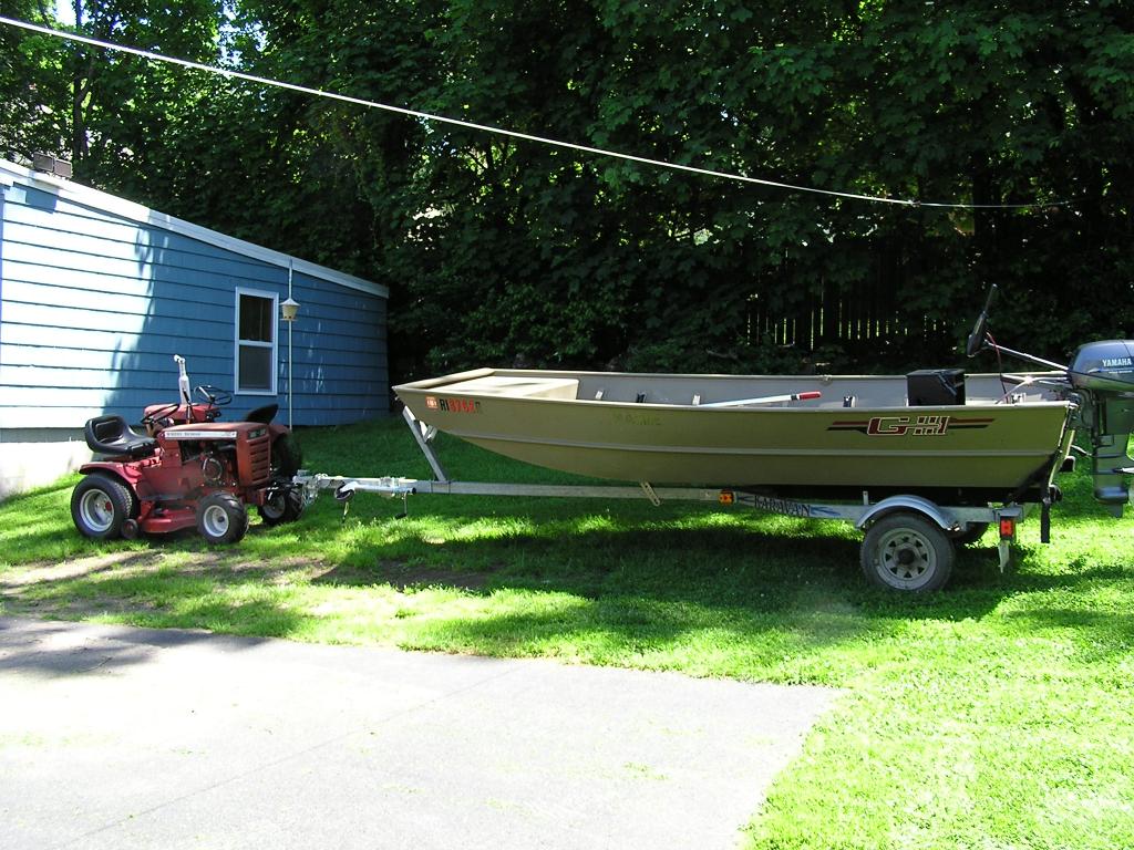

ri702bill 11,617 #9 Posted November 22, 2025 (edited) My "adorable" front hitch was designed to be simple to attach - leaving the cutting deck in place and just switch the mule drive out and cut grass. That was important to me... Edited November 22, 2025 by ri702bill 4 Share this post Link to post Share on other sites

Ed Kennell 45,524 #11 Posted November 22, 2025 Deck and mule drive stays in place with mine. 8 Share this post Link to post Share on other sites
ri702bill 11,617 #12 Posted November 22, 2025 (edited) 49 minutes ago, Ed Kennell said: Deck and mule drive stays in place with mine. Like chocolate and vanilla? Or... crabs & crawdads?? Excellent adaptation for light duty usage with great line-up visibility If it were any easier, you could just whistle, and the coupler of the splitter would jump on to the hitch by itself!! Edited November 22, 2025 by ri702bill 1 1 Share this post Link to post Share on other sites

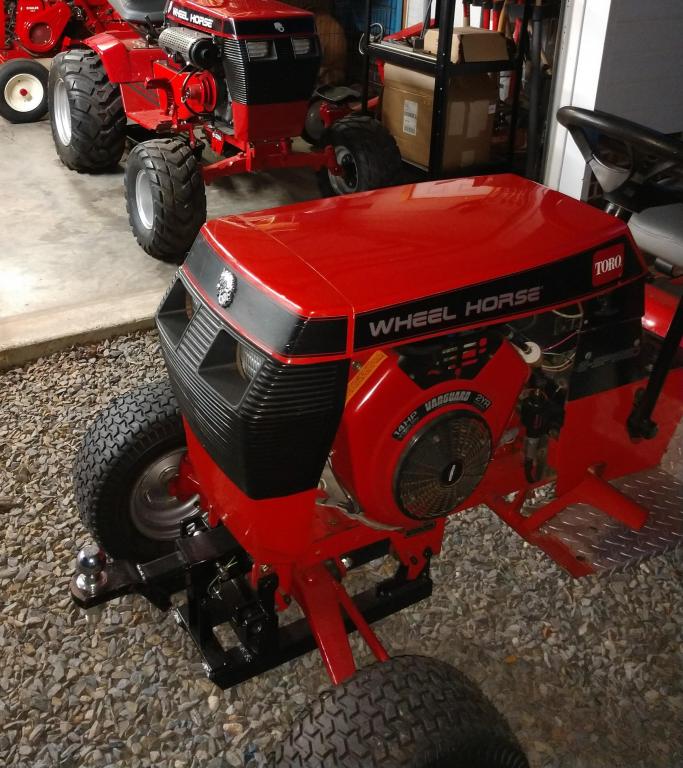

ineedanother 1,992 #17 Posted November 22, 2025 I put this one together for my crane in just a few hours with a section of an old frame that had a fractured F-bracket. Similar to the others shown, attach to the mid-tach and lift to latch in front. I think I'm going to make another one with a rack for weights now that I'm thinking about it again. 2 2 Share this post Link to post Share on other sites
kpinnc 17,575 #18 Posted November 22, 2025 10 hours ago, Bill D said: Any pictures of it off the tractor? Thanks. Mine has some extra stuff up front because I made it to work with a front mower. But you get the idea. 2 Share this post Link to post Share on other sites
