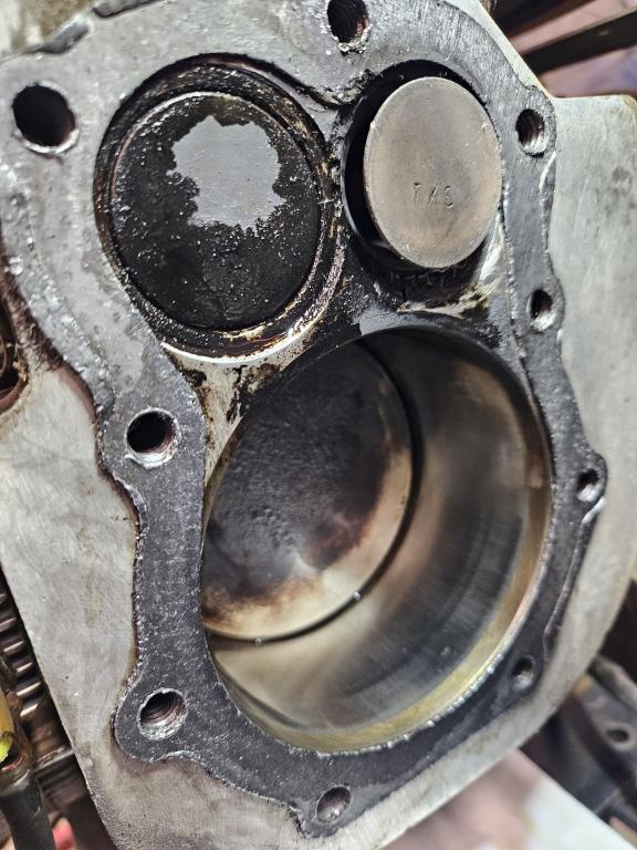

ML3 2,074 #18 Posted November 29, 2025 Got the head off. 1st pic is how it was before turning engine over by hand. Gotta now figure out where the no compression issue is coming from 20251129_115138.mp4 1 Share this post Link to post Share on other sites
Gasaholic 342 #19 Posted November 29, 2025 50 minutes ago, ML3 said: Got the head off. 1st pic is how it was before turning engine over by hand. Gotta now figure out where the no compression issue is coming from Exhaust valve seat. Check for it being cracked or poorly done re-seating (note the peened pin punch divots around the seat) if the counterbore for the seat was worn it can leak around the valve seat, if the seat was not perfectly square to the valve face when it was peened in place then valve isn't seating fully - can sometimes get away with just lapping in the valve to the seat, but odds are need seat re-cut and then valve clearance adjusted (or maybe adjust valve clearance first to see if that does the trick?) It was common for those exhaust valve seats to get loose from overheating and then they just kept running them with the loose seat which pounded away the surrounding aluminum - it's *usually* fixable but often need special tools (valve seat cutter - around $500+ for the tool kit from Neway) and/or replace the seats (perhaps local machine shop could manage it?) 1 Share this post Link to post Share on other sites
ML3 2,074 #20 Posted November 29, 2025 22 minutes ago, Gasaholic said: Exhaust valve seat. Check for it being cracked or poorly done re-seating (note the peened pin punch divots around the seat) if the counterbore for the seat was worn it can leak around the valve seat, if the seat was not perfectly square to the valve face when it was peened in place then valve isn't seating fully - can sometimes get away with just lapping in the valve to the seat, but odds are need seat re-cut and then valve clearance adjusted (or maybe adjust valve clearance first to see if that does the trick?) It was common for those exhaust valve seats to get loose from overheating and then they just kept running them with the loose seat which pounded away the surrounding aluminum - it's *usually* fixable but often need special tools (valve seat cutter - around $500+ for the tool kit from Neway) and/or replace the seats (perhaps local machine shop could manage it?) I saw the peen marks & figured thats where I need to start looking. Looks like its got the potential to turn into a big repair. May consider trying to find a repower option instead??? Gotta look into whats the best financial option. 1 Share this post Link to post Share on other sites
