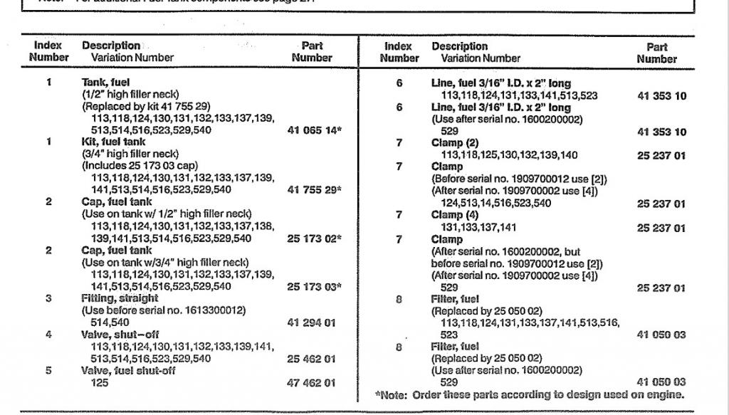

pfrederi 19,874 #11 Posted November 20, 2025 (edited) If you engine is spec # 301511 then it is Variation 513 for Fuel tanks and you need cap # 25 173 03 if it has the 3/4" neck 2517302 for 1/2 tall neck Kohler is exceedingly proud of the cap.... Edited November 20, 2025 by pfrederi 1 Share this post Link to post Share on other sites

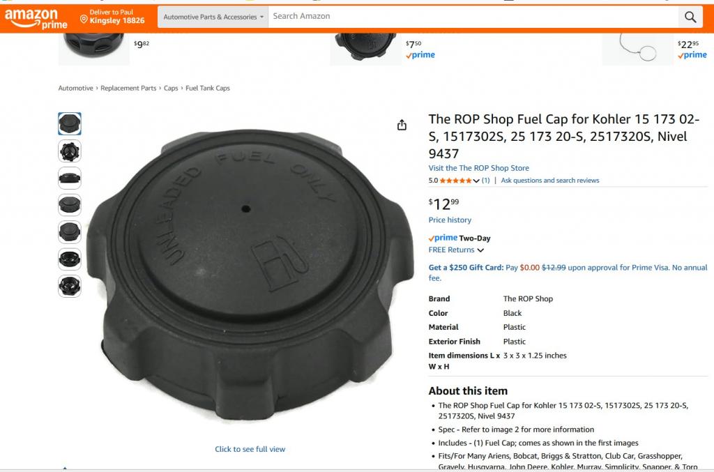

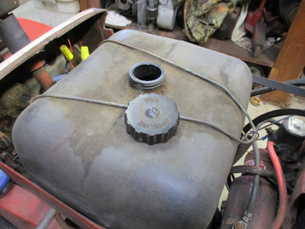

CCW 1,491 #13 Posted November 21, 2025 On 11/19/2025 at 2:23 PM, fritzie said: Where can I buy gas cap for kohler engine ser# 1534304442 m# o8S have 1987 wheelhouse See this thread. It is the gas’s cap I put on my 312-8. Share this post Link to post Share on other sites

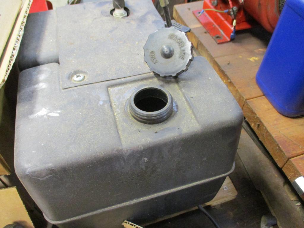

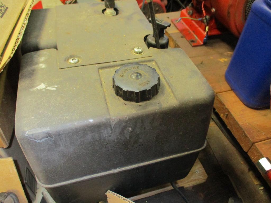

pfrederi 19,874 #14 Posted November 21, 2025 3 hours ago, CCW said: See this thread. It is the gas’s cap I put on my 312-8. The 308-8 gas tank is on the engine and has a much smaller neck than the under seat tanks. Interesting, just tested the cap from Chargers and early C series Under the hood tanks it fits the 8hp Magnum tank. 1 Share this post Link to post Share on other sites
