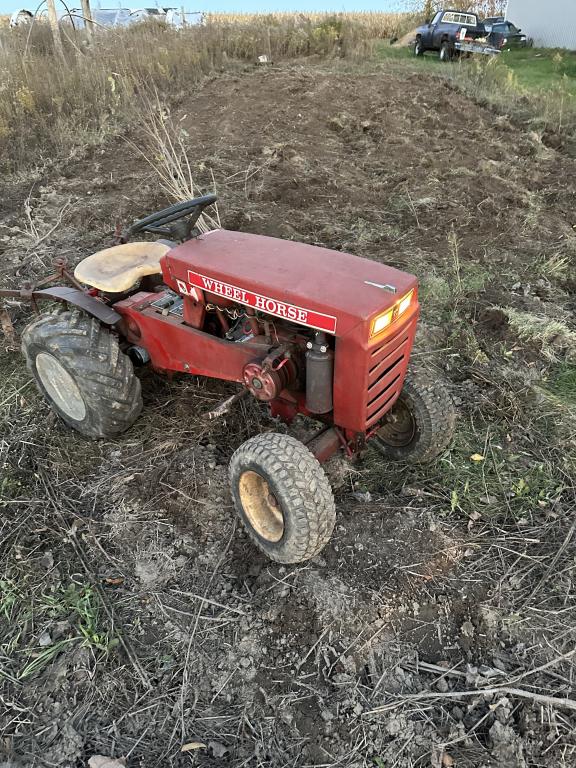

CNC 17 #1 Posted November 19, 2025 I have been using the horse for the last 3 or 4 months everything worked fine until a few days ago. I stared it up pulled it outside it started as usual, when I went back a few hours later it would not start ( engine would not turn over,no noise from solenoid nothing). I push the dead horse back into the garage and changed out the solenoid and battery from my other wheel horse ranger. Still nothing so I said must be the 2 safety switches. Pulled them off one of the brake switch wires was broken ( that must be the problem!) clean both switches and replaced with new wires. I reinstall everything still nothing. No noise engine will not turn over. Can anyone give me some suggestions on what to do next. I hope the ole c160 horse is not ready for the pasture Share this post Link to post Share on other sites
