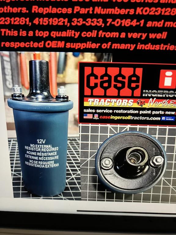

Retired Wrencher 6,448 #1 Posted November 17, 2025 Is a no external resistor needed. Is this the proper coil to put on a start GEN engine seems to be kind of confusing what to get and not buy over the big pond junk thanks in advance. Share this post Link to post Share on other sites

squonk 45,500 #4 Posted November 17, 2025 Echlin IC 14 or Accel 8140 1 1 Share this post Link to post Share on other sites
Retired Wrencher 6,448 #5 Posted November 17, 2025 (edited) 4 hours ago, squonk said: Echlin IC 14 or Accel 8140 Mike does Nappa still sell them? I know you are a big fan of Nappa. Also I have this I bought from a Case dealer would this work. Edited November 17, 2025 by Retired Wrencher 2 Share this post Link to post Share on other sites
Retired Wrencher 6,448 #6 Posted November 17, 2025 4 hours ago, squonk said: Echlin IC 14 or Accel 8140 So Mike this is the one. Share this post Link to post Share on other sites
pfrederi 19,874 #7 Posted November 17, 2025 The Case no resistor required will work 4 1 Share this post Link to post Share on other sites
squonk 45,500 #8 Posted November 17, 2025 36 minutes ago, Retired Wrencher said: Mike does Nappa still sell them? I know you are a big fan of Nappa. Also I have this I bought from a Case dealer would this work. Yes to both Share this post Link to post Share on other sites
Retired Wrencher 6,448 #9 Posted November 17, 2025 (edited) 4 minutes ago, squonk said: Yes to both Ok thanks. Edited November 17, 2025 by Retired Wrencher Share this post Link to post Share on other sites
Retired Wrencher 6,448 #10 Posted November 18, 2025 16 hours ago, pfrederi said: The Case no resistor required will work Thanks Paul. Electrical and me don’t get a long. That is why I am a 60.s fan. Share this post Link to post Share on other sites
Retired Wrencher 6,448 #11 Posted November 29, 2025 (edited) On 11/17/2025 at 8:31 AM, squonk said: Echlin IC 14 or Accel 8140 Mike I would like to say I put that case coil on the 1056 rat that I have cannot believe the difference on startup turn the key and it’s running amazing. So I’d like to thank you for all the information that you gave me. I like it so much I bought anther one. There on EBay he is Ct. If you look it is this picture in the add. Edited November 29, 2025 by Retired Wrencher 1 Share this post Link to post Share on other sites
