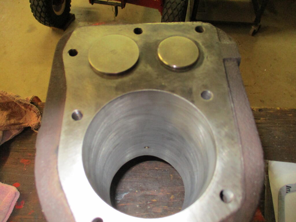

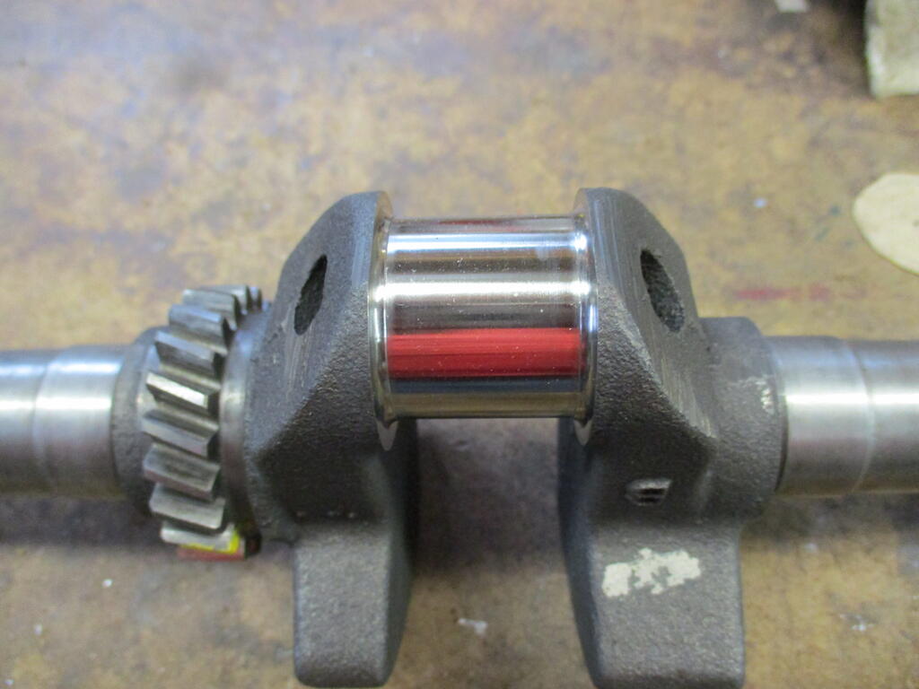

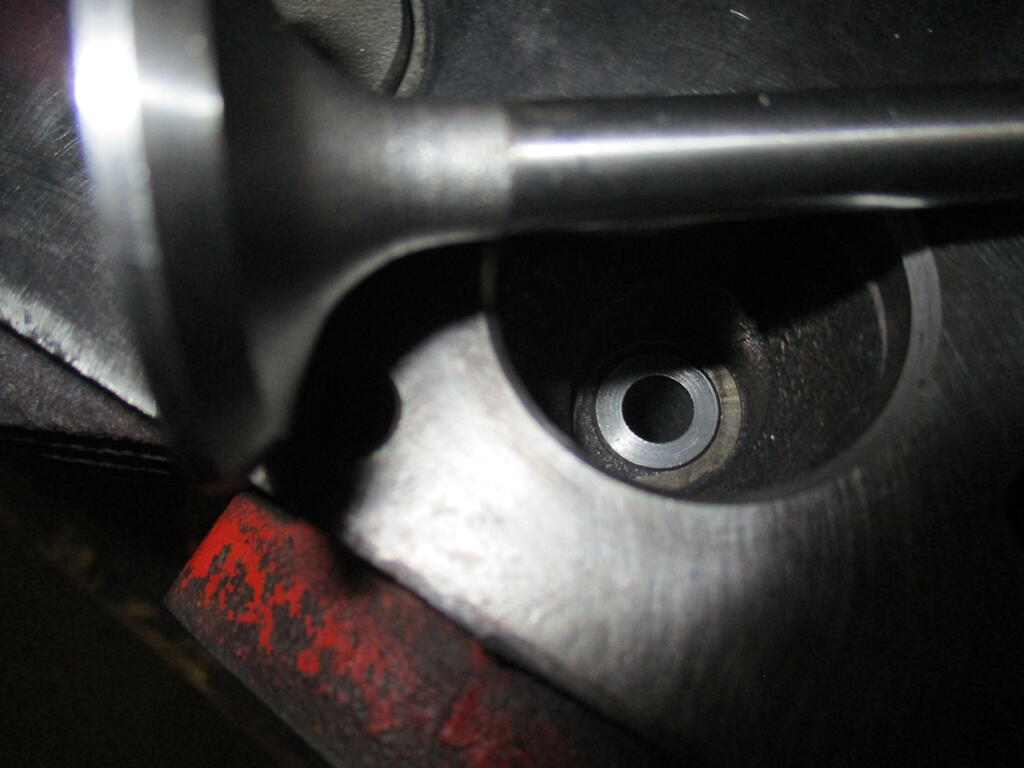

pfrederi 19,874 #1 Posted November 13, 2025 Been awhile since my last overhaul...I am fortunate to have a quality machine shop to do the machining. He has also did one of my big tractors and 230ci engine in my M37. But like everything else it is getting costlier....Bore and hone .010 over $100 Grind crank $75 Insert and size valve guide $50 valve job $20 2 10 Share this post Link to post Share on other sites

ebinmaine 77,323 #4 Posted November 13, 2025 2 hours ago, pfrederi said: costlier....Bore and hone .010 over $100 Grind crank $75 Insert and size valve guide $50 valve job $20 Bore and hone is about that here. Guides.... I dunno IF that can be done. Valve grind around here is more of a hand lapping sequence on small engines. There's a more concise shop further away. They definitely do good automotive work. Small engines.....??? 2 Share this post Link to post Share on other sites

squonk 45,500 #7 Posted November 14, 2025 Pretty much most of the work can be done DIY with economical tools. The machine shop comes into play when the cylinder needs boring, valve guides need replacing and the crank needs to be ground. I ran into a situation on one of my last rebuilds. I bought new valves From I Save and the intake valve face must not have been cut right. Inserting it into the engine it was too short. I had a huge gap where usually you have to trim the stem for clearance. So I call the local shop about getting the face cut and he said he could do it right away. So I had him set the lash while he was at it. And for $20 cash it was worth it to me to have him just do the lash on the next engine I did. 2 Share this post Link to post Share on other sites
