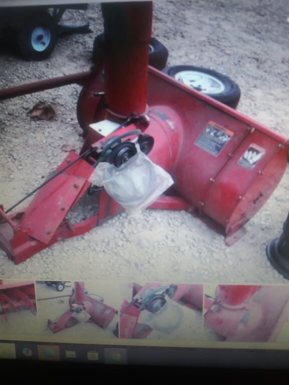

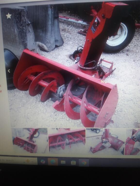

6wheeler 670 #1 Posted Wednesday at 08:21 PM Hi all. This is up for auction. But, it is 50 miles away. Can anyone ID this blower? It is a 44" inch and I was thinking of bidding on it. Would it fit on my 165? I think it may be for a 520. But, I think it is missing the lift bar. Maybe I am wrong. Share this post Link to post Share on other sites
gwest_ca-(File Mod) 11,768 #2 Posted Wednesday at 09:00 PM Here they are DNA 44" 2-stage snowthrower 1990 2-stage 44" model 06-44SC01 1991 2-stage 44" model 06-44SC01 Serial 1000001-1999999 1992 2-stage 44" model 06-44SC01 Serial 2000001-2999999 1993 2-stage 44" model 79361 Serial 3900001-3999999 1994 2-stage 44" model 79361 Serial 4900001-4999999 1995 2-stage 44" model 79361 Serial 5900001-5999999 1996 2-stage 44" model 79361 Serial 6900001-6999999 1997 2-stage 44" model 79361 Serial 7900001-7999999 1998 2-stage 44" model 79361 Serial 8900001-8999999 2000 2-stage 44" model 79361 Serial 200000001-200999999 Share this post Link to post Share on other sites
ebinmaine 74,770 #3 Posted Wednesday at 09:06 PM That'll set up on any long frame with the attach-o-matic mount. I believe 1973 and up. I've had one on my 1975 C160 Automatic for testing but didn't use it. Wasn't mine back then. It is now. I'll have it on a 1984 Workhorse GT1800 this winter. The related lift parts are available or can be fabbed. Just be aware of extra costs beyond the initial purchase. Even by itself that Two Stage Tall Chute Snowblower is worth a pretty penny. Share this post Link to post Share on other sites

peter lena 9,483 #5 Posted Wednesday at 10:10 PM @6wheeler very often refer to the , drive belt IDLER PULLEYS on any unit , known for tiny . bearings and unknown lubrication , they regularly , collectively slow down anything they are a part of , they also regularly , add to pto lever engagement squealing , should spin easily and quietly . enhanced rotational belt drives on all my stuff , the difference is amazing . pete Share this post Link to post Share on other sites
