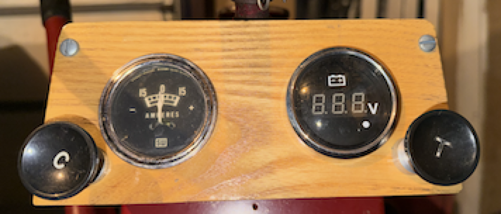

   I acquired my B80 a couple of years ago. It had several issues one of which was electrical. Mainly loose connections and shabby repairs. I cleaned up the wiring and that fixed all the issues. The one thing I noticed was when running, the amp gauge was very erratic, jumping all over the charging side of the scale. Is this normal? I tested at the battery and all was good charging at 14v.
   I haven't had any issues until last April I noticed the amp guage was not moving off 0 volts. I replaced the  rectifier which I believed to be the original with an aftermarket one. I had about 22 hours of running time with the new one when I had a no crank, no start  problem. I chased the issue to the amp gauge. I bypassed the guage and it started right up. While continuing with my fall cleanup I noticed smoke coming from the rectifier area. The rectifier over heated melting the connector plug. I made sure the ground was good on the rectifier. I removed the rectifier knowing it's junk. I tested the stator with a multi meter. This is the first  time I've ever done this and I have some questions. I have read manuals  and viewed some videos for this procedure. The readings on the meter where jumping rapidly all over between 33 and 27 volts and periodically a "1" would appear in front of the  readings technically changing them to 133 - 127v . I don't know if I have a problem with the stator or my  meter  is not giving me a accurate reading.  It's  new , I think I paid about $20 .
     Any thoughts would be greatly appreciated .  Either way I'll  need to get  a replacement rectifier. Has anyone  experienced issues with an aftermarket rectifier. I know oem is the way to go but I can see sellers are very proud of them.

My first guess is that the regulator/rectifier is not grounded properly any longer. Common problem. But first, check the AC voltage coming from the stator. It should be in the 28 to 40 volts AC at 3600 RPM, not connected to the regulator. Remember to put your meter in the AC mode. Next, I would install a known-good or new regulator. The output voltage should be about 13.8 VDC. Check charging voltage with the battery connected as the battery is part of the charging system. If all voltages are correct, see what the ammeter is doing. If it's steady, good. If not, replace it. All of my ammeters on B-80's, B-100's, and C-120's all jumped around. As long as you are charging, just bypass the meter if it bothers you.
