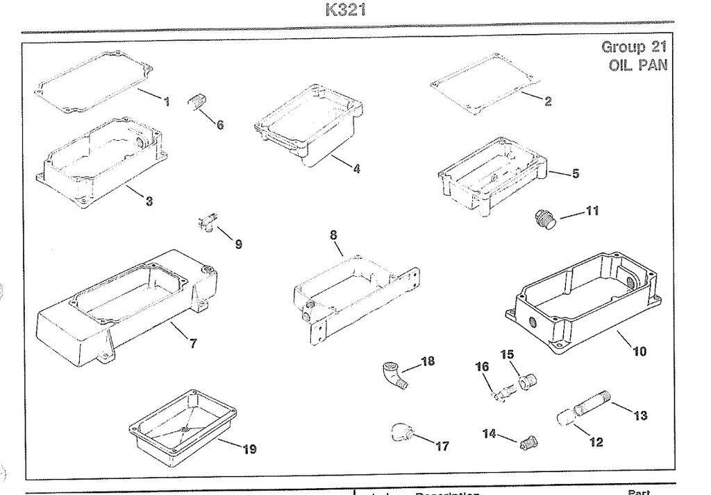

Hi, I have a Wheelhorse 414-8 with a Kohler Magnum 14hp. I rebuilt the engine and and filled  it with 2 quarts of oil,when i check the dip stick it does not read full. why is this happening?
Thank for any info.
gwest_ca
The lube chart calls for 2-1/2 quarts.
You can see it here in the thumbnails

Just make sure you check your particular engine. My version of that chart is older and that's actually the first time I saw a Kohler single over 2 quarts. It got me wondering about the M14 on the 314-H so I looked at the owners manual (I know, what a concept :eusa-whistle:) and it's only 2 quarts. :)

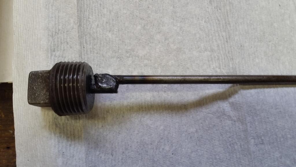

I never used to even worry about what the book says on oil amount... untill i realized that a PO may have altered the dipstick or replaced it with an incorrect one.
Now I use Racin Bob's patented juicy juice jug method. Two bottles with measured marks on them . One for drained oil just to know how much was in it and to get an idea of oil consumption.  Another one for clean oil to measure how much goes in according to book.

Kohler used several different oil  pans on the big blocks hence different amounts of oil required  For instance #10 regular big base big block...#5 small base (shaker mount)
