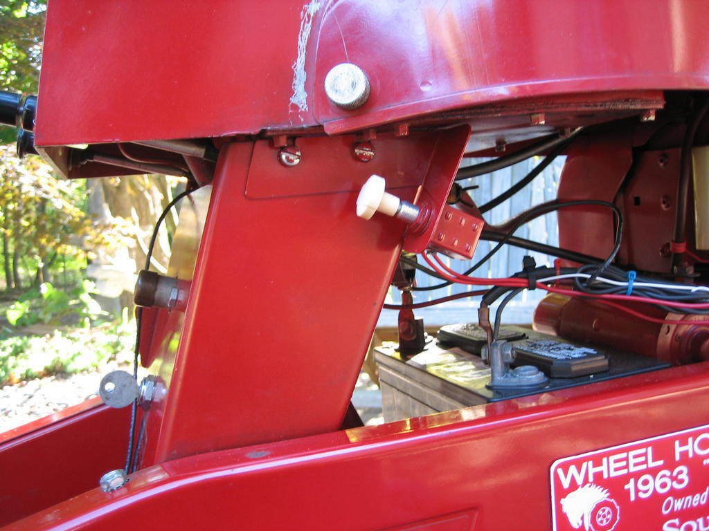

DBlackston 333 #1 Posted November 9, 2025 I am working on an HL-5 setup for my 854 and 704 tractors. I have seen two different switch brackets and I much prefer the style in the picture below. Does anyone have one of these they could layout a flat template from so I may reproduce one? Also, I am certain this bracket will fit on the 854 but I am not as certain on the 704 as it has the different sloping upright. Thanks in advance! Share this post Link to post Share on other sites
