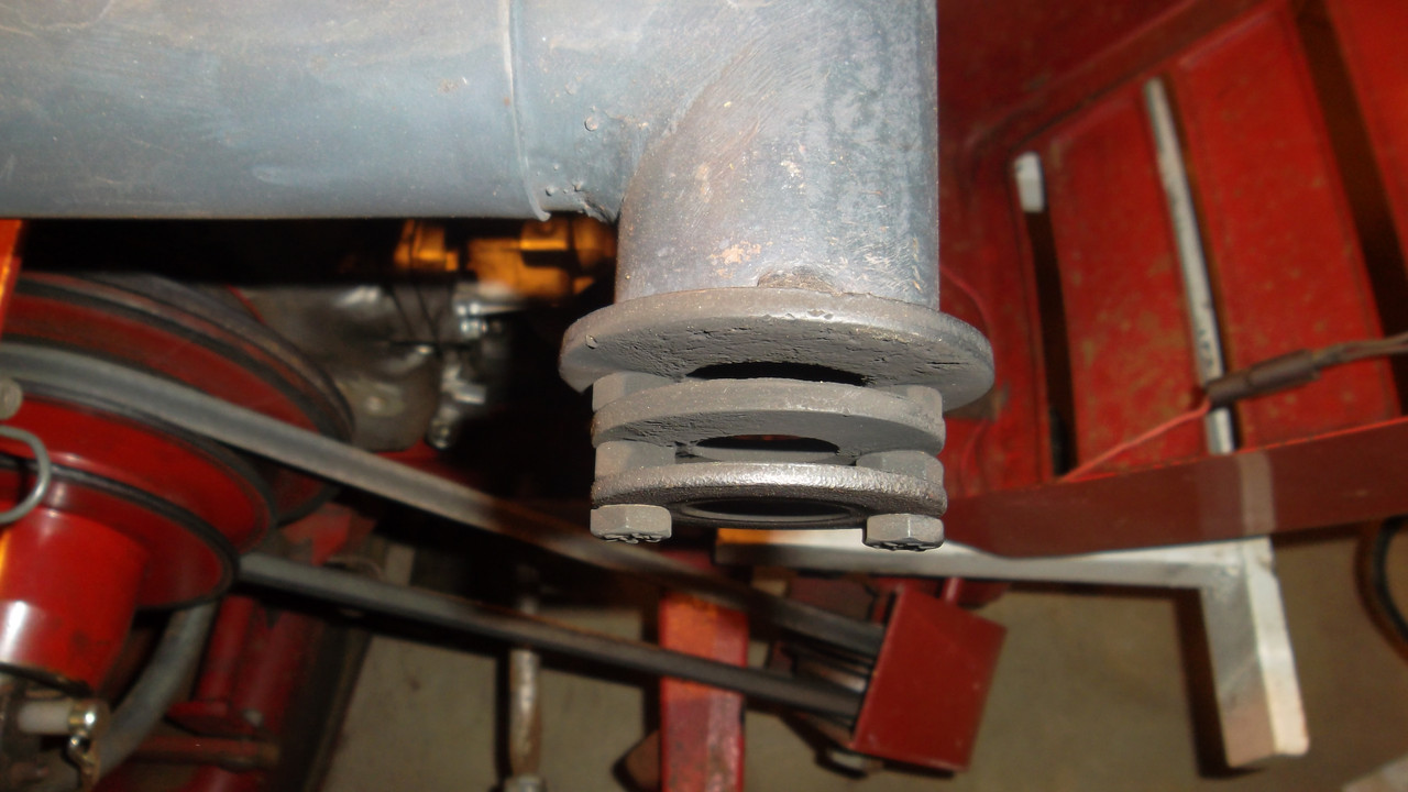

Phan 50 #1 Posted November 8, 2025 Everyone has to see it and hear the sound ! 4 4 Share this post Link to post Share on other sites

Pullstart 68,870 #4 Posted November 10, 2025 (edited) Very nice! I’ve made a few, they are fun to tune the sound. A bolt, a washer, a cut or convoluted washer, they all make a difference. Have fun! https://www.wheelhorseforum.com/topic/105214-the-big-exhaust-conundrum/?tab=comments#comment-1141251 I did finally build a real muffler. It sounds great! https://www.wheelhorseforum.com/topic/61099-picked-up-a-c-101-this-morning/?page=3&tab=comments#comment-1183207 Edited November 10, 2025 by Pullstart 4 Share this post Link to post Share on other sites

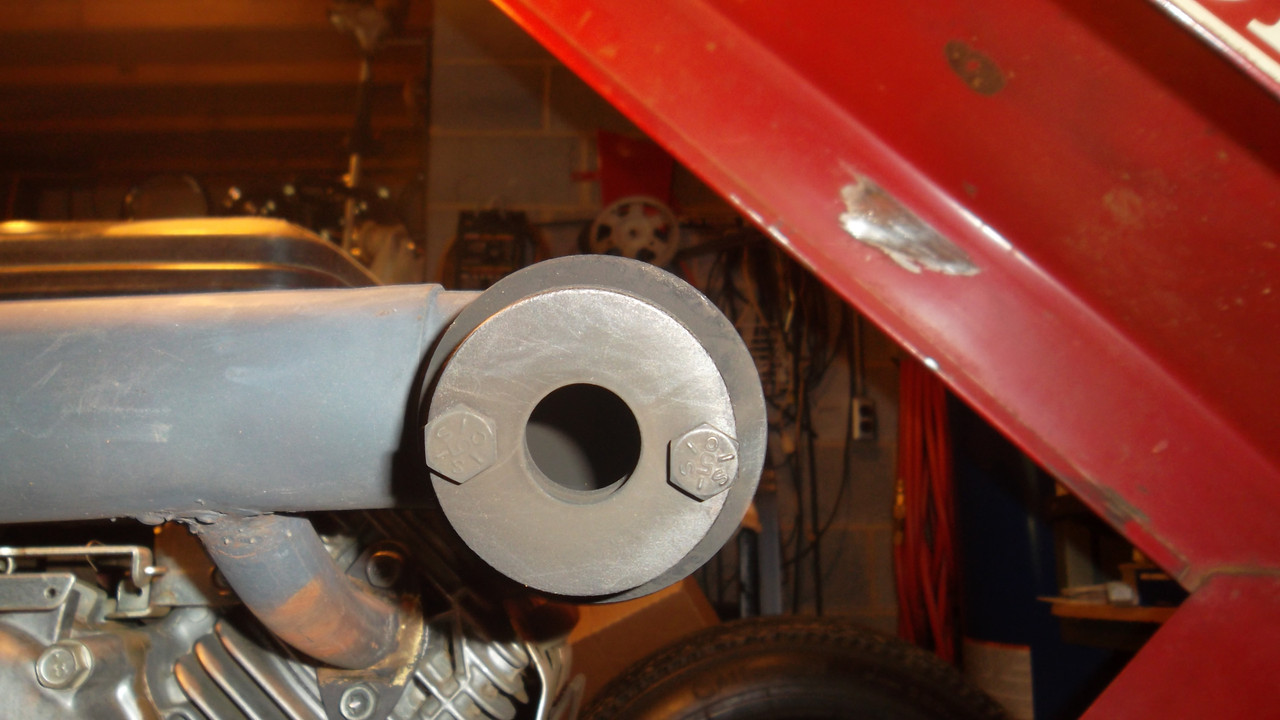

Lee1977 7,551 #5 Posted November 11, 2025 Here one I made for an 18 HP Vanguard. There is nothing in the 2"" tail pipe or the 3/4 tubing up to it. Just the 1" washer with the two 3/4" washer spaced out with drilled out 1/4" nut spacers. 1 Share this post Link to post Share on other sites
