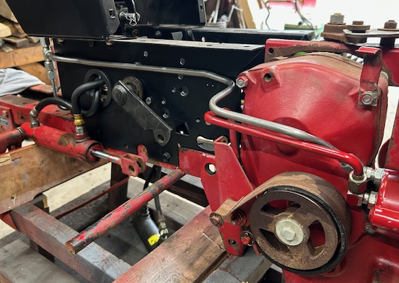

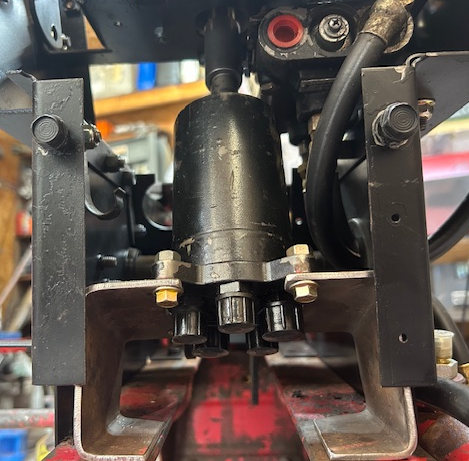

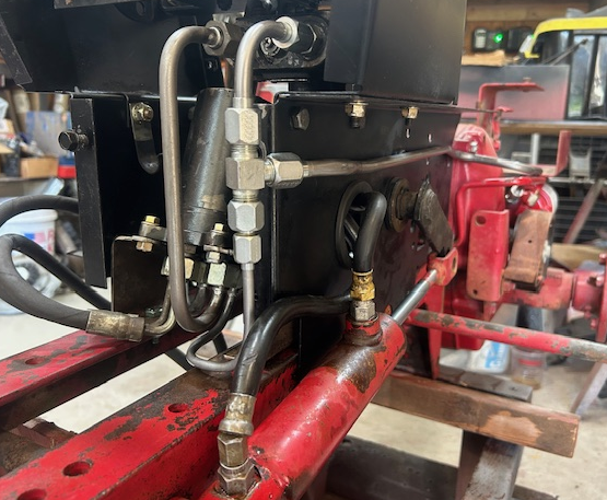

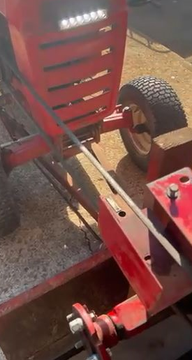

JoeM 9,650 #1 Posted November 7, 2025 Straight from the back burner, I have been tinkering with this 520H. I bought an orbital steering valve from 19richie66 and decides to modify the 520 to power steering. I seen a thread a while ago were someone added steering to a 518. Figured that would be a nice side project if I came across a reasonably priced steering valve. I wanted to keep it looking the same and tucked in the column. It was a little tricky with a mix of face seal and jic piping. Picked up some face seal fitting from MMC and silver soldered to the steel pipe. For now it is on ice, next will be the front axle mod to accept the steering cylinder. Absolutely don't need a 520H with power steering but I like to build things and keeps me out of the Mrs. cross-hairs. Used the c120 and old deck belt to test run. front view 10 Share this post Link to post Share on other sites

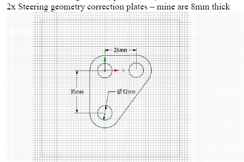

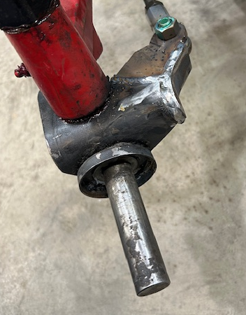

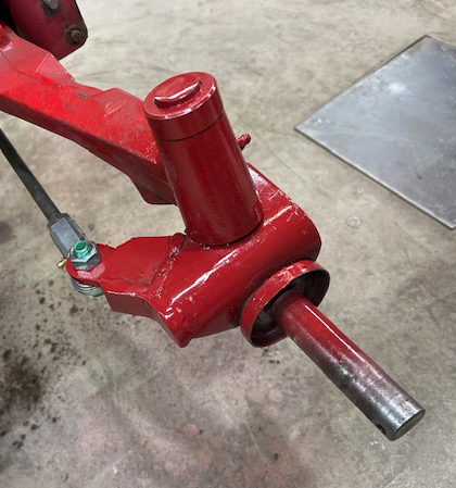

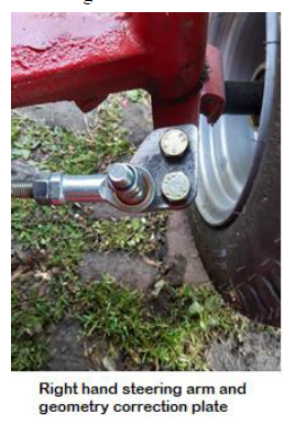

JoeM 9,650 #10 Posted November 10, 2025 On 11/7/2025 at 5:13 PM, Handy Don said: Turns out the different linkage configuration didn’t have a proper Ackerman geometry and so steering was easy but cornering caused tire scuffing and wander. HD good catch! I went back and searched for the PS thread and found it was done by @Damien Walker. He wrote an excellent PDF with updates. The steering geometry was solved by adding these plates to the arms on both sides. This will save me from cipher'n the problem myself. Damien also sited the number of turns lock to lock. I have about 3 1/2 turns lock to lock. I may replace the cylinder with a smaller lift cylinder from a 520H. It should get me below 2. Damien says he used a 1 inch cylinder and it worked good plus the steering was still easy. 1 Share this post Link to post Share on other sites

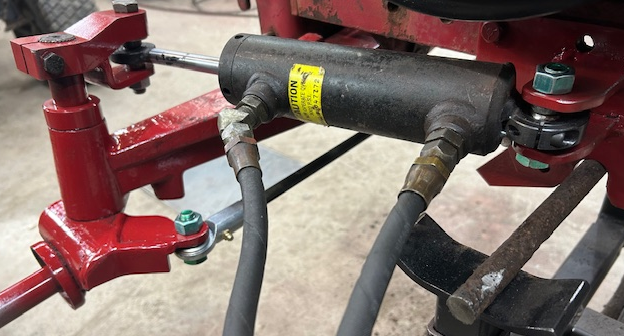

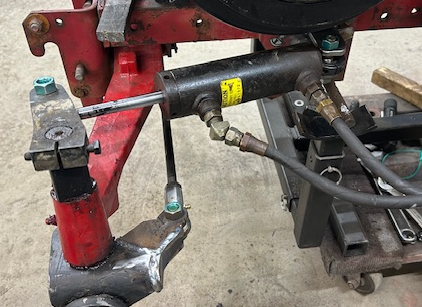

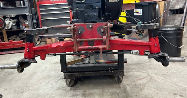

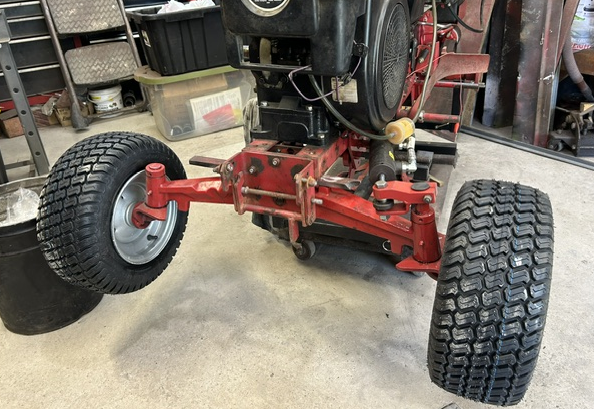

JoeM 9,650 #14 Posted January 17 Got back to the PS project. Figured out the drag link, next is the steering cylinder mount. 1 2 Share this post Link to post Share on other sites
cleat 8,750 #15 Posted January 17 On 11/8/2025 at 7:32 AM, JoeM said: Testing vid Great way to test. The only issue I heard was the steering lugging the engine at the end of it's stroke. The lift valve has a pressure relief valve built in but because your steering is plumbed in first that valve is not going to help. Long story short, make sure you have a pressure relief ahead of the steering control valve to prevent over pressure issues. Just my 2 cents. 2 Share this post Link to post Share on other sites

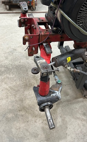

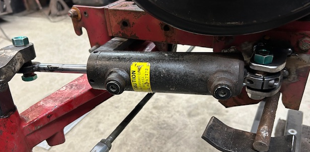

JoeM 9,650 #16 Posted January 17 2 hours ago, cleat said: The only issue I heard was the steering lugging the engine at the end of it's stroke. Yeah man, both the steering (power beyond type) and the left valve have reliefs. The lift valve is defiantly set to high. I have not gauged it yet but will have to fine tune as the we get closer. Steering Valve I did get the steering cylinder in place and tested today, need a little adjusting the stops on the spindels but it was real close. 3 Share this post Link to post Share on other sites

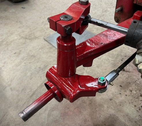

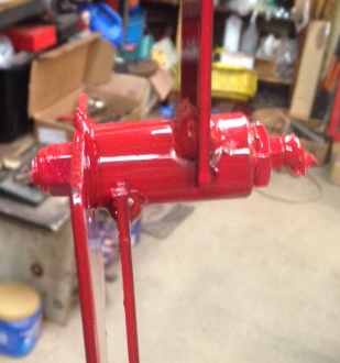

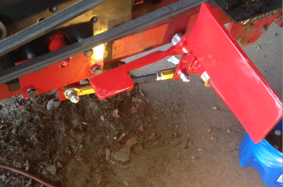

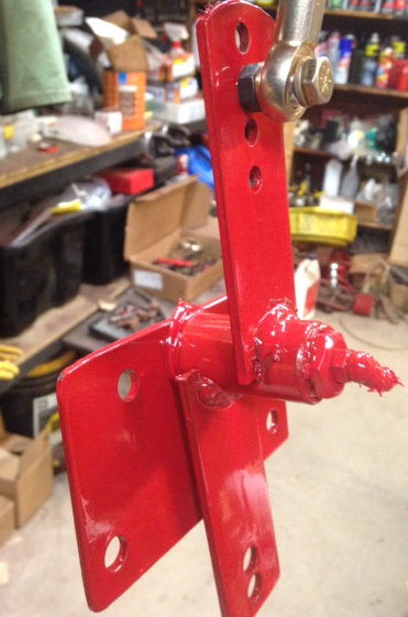

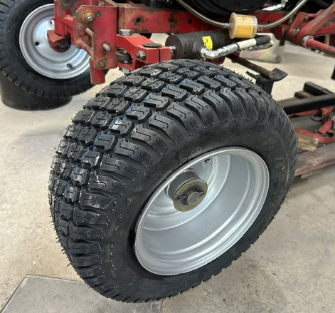

JoeM 9,650 #17 Posted January 19 A few pics from the project Most of the parts I have laying around. Just a budget friendly thing to do. The spindles and cylinder are xi. I have the front wheels too. The correct hoses and fittings are ordered and on the way. I figured this deserves a foot control.......maybe yes! That will be next. 2 Share this post Link to post Share on other sites

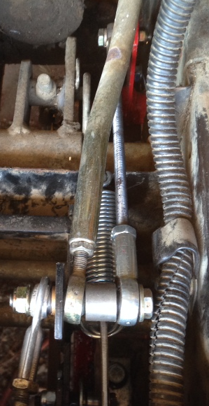

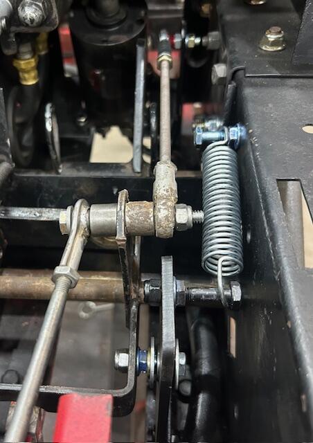

JoeM 9,650 #19 Posted January 19 33 minutes ago, Bill D said: make your own foot control? yep, a little different then the typical versions. This one i have done in the past, uses a grease-able shoulder bolt for the pivot. I like leaving the hand lever hooked up. I have a fused right ankle and sometimes it is cumbersome to use the foot control. this time I might have to work around stuff then usual. 2 Share this post Link to post Share on other sites
JoeM 9,650 #20 Posted January 26 some of the foot control installed have to take a break for the snow storm. 1 Share this post Link to post Share on other sites
