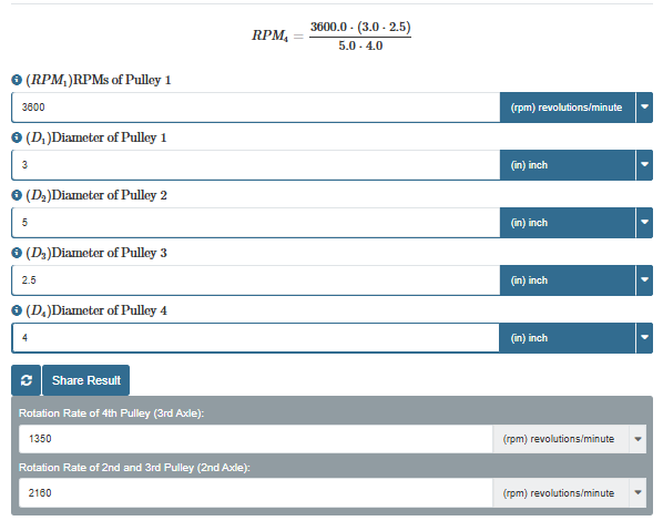

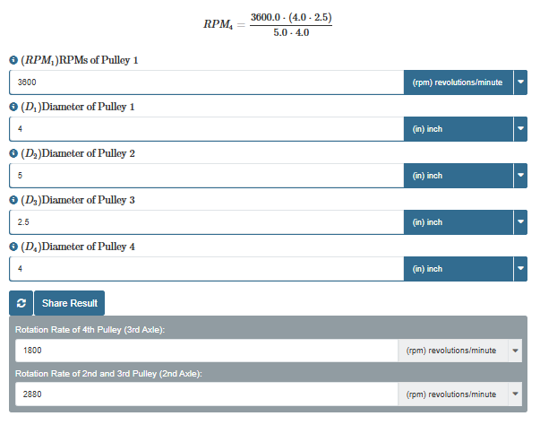

"Manic-Mechanic" 1,485 #1 Posted November 6, 2025 (edited) I am setting up a 50” side sickle 3600 rpm off the PTO Is this correct and will I be running too fast with a 4” drive pulley? Edited November 6, 2025 by "Manic-Mechanic" calculation correction Share this post Link to post Share on other sites
8ntruck 8,627 #2 Posted November 6, 2025 Your math looks about right. What final rpm at the wobble box drive were you looking for? 1 Share this post Link to post Share on other sites
gwest_ca-(File Mod) 12,015 #3 Posted November 6, 2025 You sure do not want to run them very fast because they will shake themselves apart. I mow at just a bit above idle for that very reason. 6 1 1 Share this post Link to post Share on other sites

8ntruck 8,627 #8 Posted November 6, 2025 Just now, "Manic-Mechanic" said: What would you recommend? I never had a sickle mower, so I don't know exactly. There is a lot of mass shaking back and forth in one of these things, so that makes a lot of forces in the drive system each time the sickle bar changes directions. The faster you run them, the higher those forces will be. More force means higher stress in the drive components, which leads to quicker failures. I'll guess that the owner's manual suggests an operating speed. You might find a manual in the files section of the forum. I'd also guess that the longer the sickle bar, the lower the speed. 1 Share this post Link to post Share on other sites

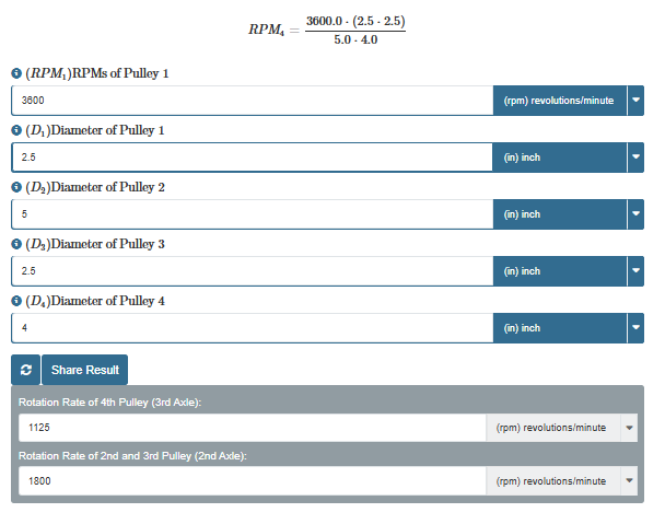

"Manic-Mechanic" 1,485 #9 Posted November 6, 2025 (edited) 41 minutes ago, 8ntruck said: I never had a sickle mower, so I don't know exactly. There is a lot of mass shaking back and forth in one of these things, so that makes a lot of forces in the drive system each time the sickle bar changes directions. The faster you run them, the higher those forces will be. More force means higher stress in the drive components, which leads to quicker failures. I'll guess that the owner's manual suggests an operating speed. You might find a manual in the files section of the forum. I'd also guess that the longer the sickle bar, the lower the speed. Incredulously no, the manual is not very helpful, only a vague reference slowly starting the sickle, increase gradually to full throttle. As the units were originally engineered to the old direct drive pulley, some 2.5 inches, not sure what speed is achieved. I can do the math with 2.5 representing D1 I suppose. As stated earlier, I can mimic the old direct drive set up with a pedal. The PTO Clutch are a strange bird to try and adjust the brake pad and keep it still while not in use, they get extremely hot! Edited November 6, 2025 by "Manic-Mechanic" added math Share this post Link to post Share on other sites
"Manic-Mechanic" 1,485 #10 Posted November 6, 2025 My final assessment is the change of D1. I can do a 3" easily, reverting back to direct drive with a pedal, or a smaller cone on the PTO Clutch. All putting the cart before the "horse!" Share this post Link to post Share on other sites

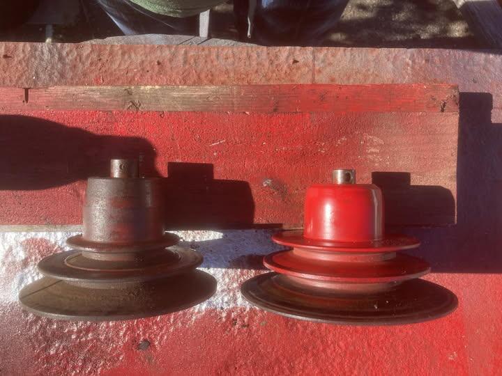

gwest_ca-(File Mod) 12,015 #18 Posted November 6, 2025 The pulley on the right was designed for a 5/8" wide belt. You can see where it was riding. I wonder if a 1/2" belt would fit without contacting the bottom of the groove. That would reduce the effective pulley diameter. 1 Share this post Link to post Share on other sites
"Manic-Mechanic" 1,485 #19 Posted November 6, 2025 (edited) 1 hour ago, gwest_ca said: The pulley on the right was designed for a 5/8" wide belt. You can see where it was riding. I wonder if a 1/2" belt would fit without contacting the bottom of the groove. That would reduce the effective pulley diameter. I have a deck used a 1/2 belt on that prior but it didn’t ride on there well.. So, I will go to the one on the left, switched stub shafts it fits excellent! The diameter is closer as well. I will need 1/2-37 belt now but that’s cost effective. Edited November 6, 2025 by "Manic-Mechanic" Share this post Link to post Share on other sites

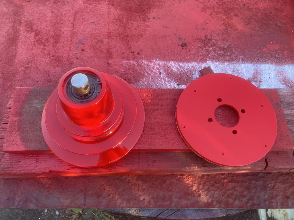

"Manic-Mechanic" 1,485 #20 Posted November 6, 2025 I have test fit this modified pulley assembly and it aligns nicely. Now getting the pesky brake to cooperate! Share this post Link to post Share on other sites

Handy Don 16,018 #23 Posted November 7, 2025 On 11/6/2025 at 3:14 PM, gwest_ca said: The pulley on the right was designed for a 5/8" wide belt. You can see where it was riding. I wonder if a 1/2" belt would fit without contacting the bottom of the groove. That would reduce the effective pulley diameter. Depending on how tightly the manufacture adhered to the standards, the slope of the “V” should be different between the two sheaves which would affect the depth and the contact between the belt and the sheave wall. 1 Share this post Link to post Share on other sites
"Manic-Mechanic" 1,485 #24 Posted November 7, 2025 1 hour ago, Handy Don said: Depending on how tightly the manufacture adhered to the standards, the slope of the “V” should be different between the two sheaves which would affect the depth and the contact between the belt and the sheave wall. I used the left pulley, it was designed for L belt and the diameter of the outer sheave is closer to intended circumference 1 Share this post Link to post Share on other sites
