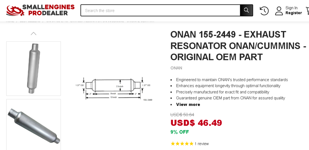

JoeM 9,387 #1 Posted November 4, 2025 Was looking through this web site and seen this onan muffler, might be a good fit for a Kohler K or Mag?? I got some Kohler parts from these guys and seemed good. 1 Share this post Link to post Share on other sites
ebinmaine 76,424 #2 Posted November 4, 2025 Given decent skill with a welder, one could repair or even make a mid 70s "small can" Nelson replacement. 5 Share this post Link to post Share on other sites

JoeM 9,387 #4 Posted November 5, 2025 I've made a couple mufflers, really did not sound good. They we quieter but not like the tone of an OE Standley muffler. Differently a science. I figured with a few pre bent fittings that onan might just be OK. The body is close in size to some of the ones that came on Kohler machines. Welded and repaired some, used low heat MIG. A always use a thicker patch material and ride the heat there easing over to the thinner muffler side. Down passes and or just spread out tacks. It is a challenge. Brazing is good too but like Jim says it has got to be super duper clean. 1 Share this post Link to post Share on other sites
