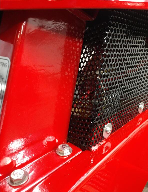

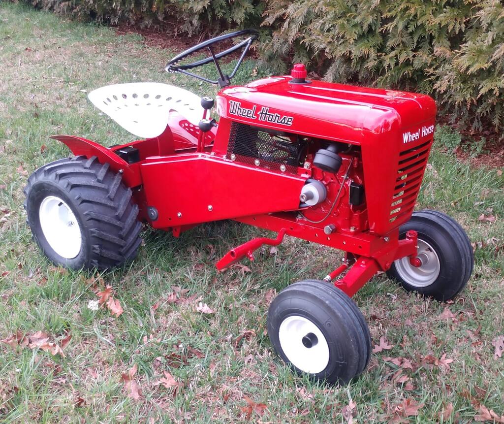

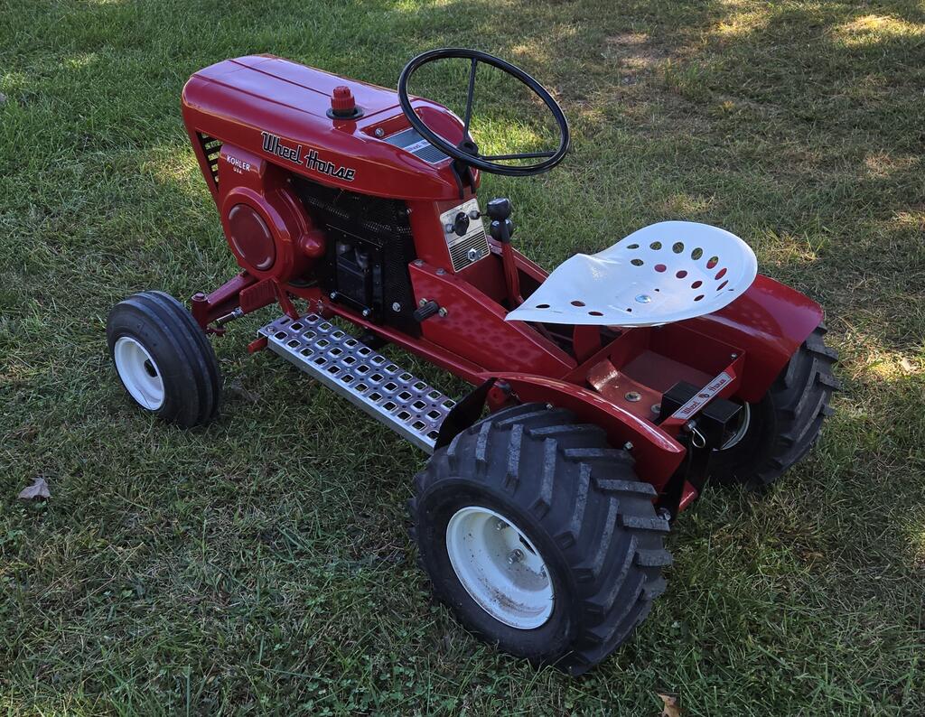

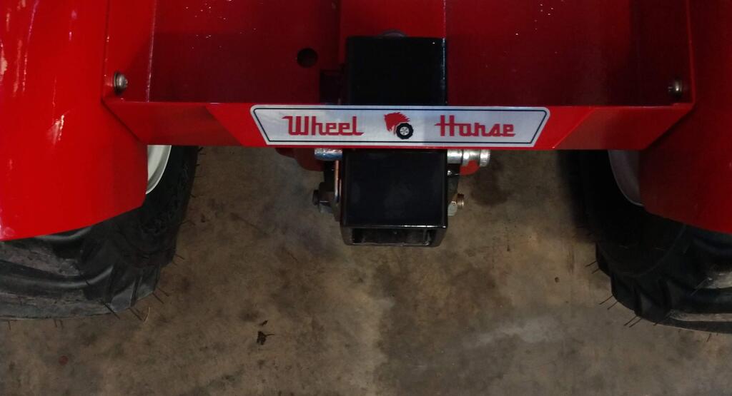

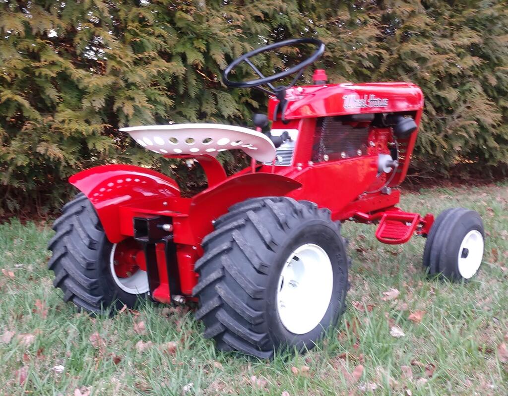

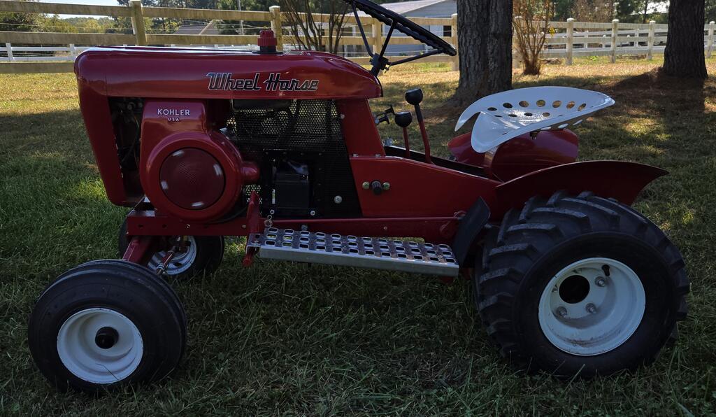

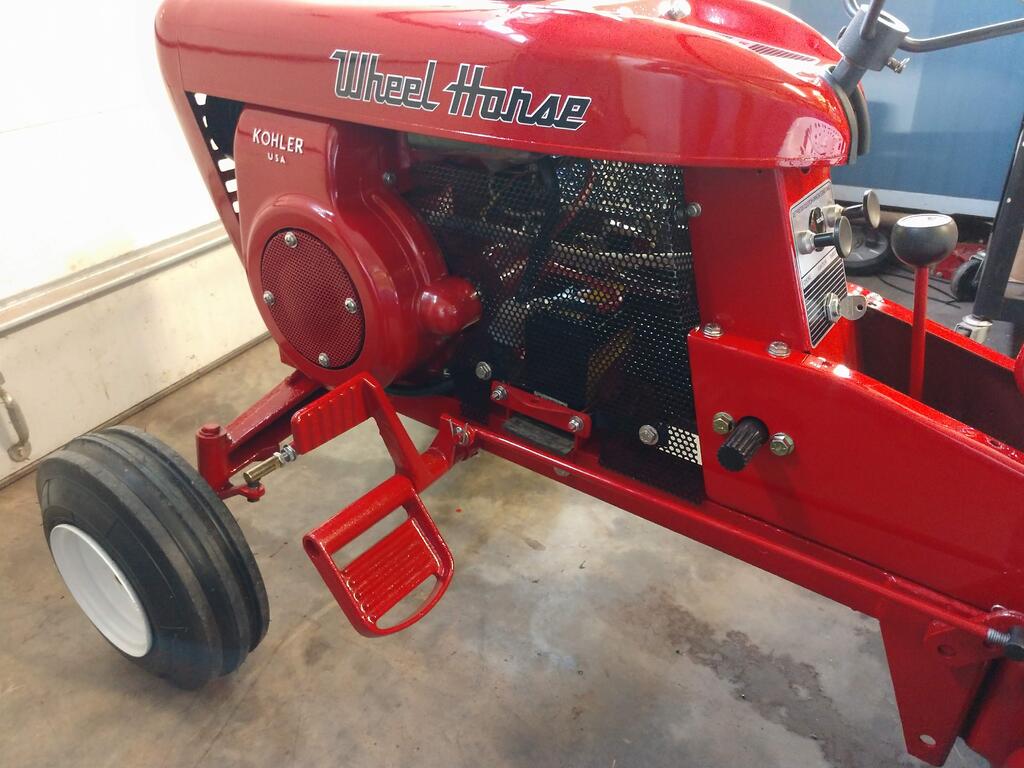

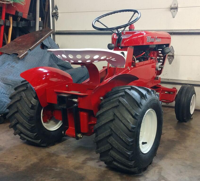

kpinnc 17,580 #1 Posted November 4, 2025 Built this for my son to play with. Made to look like a 1962- 1964 but actually a 1967 L157. The dash tower/ tool box was cut and welded up to match a set of Suburban fenders. Also added an 8 speed transmission and Kohler K181 because I'm allergic to Techumseh. Changed over to 6 inch front wheels and added running boards for safety. Also has a reciever hitch integrated into the toolbox. 4 15 Share this post Link to post Share on other sites
