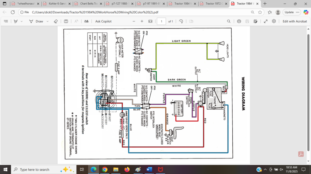

Wiring diagram for the GT-1100 here. Click on the tractor in the link and then select the small wiring diagram for a larger one.

There is a 15 amp fuse and the Amp meter between the battery and your ignition switch. If the fuse Holder is in poor condition it would reduce the voltage reaching your ignition switch. Amp meters have been known to be a problem too.
