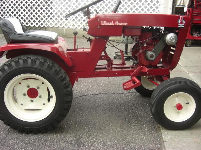

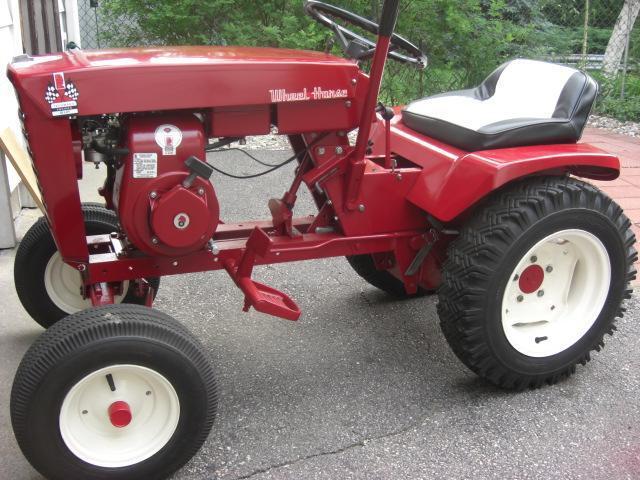

rjg854 12,917 #2 Posted November 1, 2025 All those are basically the same tractor as my 68 Commando 8, nothing rare about them. Just model changes yearly. 3 Share this post Link to post Share on other sites
