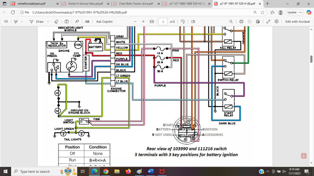

lynnmor 8,565 #4 Posted November 1, 2025 See page 8-5 in the Onan Service Manual. Share this post Link to post Share on other sites

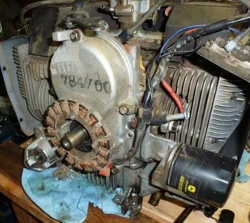

lynnmor 8,565 #21 Posted November 3, 2025 This photo shows the stator wires held in place with a clamp: 2 Share this post Link to post Share on other sites
