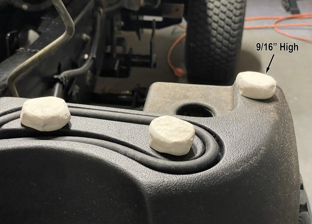

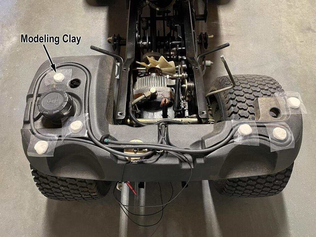

Blue Chips 706 #1 Posted October 30, 2025 (edited) On the 5xi-series tractors, the plastic fuel tank (which I assume is some kind of polyethylene) is secured at its top and sides by several irregularly-shaped pieces of foam rubber sandwiched between the tank and the rear fender. The old foam rubber on my GT18 had deteriorated to what was essentially powder, which allowed the tank to flop around, and it's probably not in any better shape on my 522xi, which is the same vintage (2001). I haven't yet been able to find any OEM or specific aftermarket replacements for the foam pieces, but if anyone knows of any, let me know. In the meantime, I'm going to experiment a bit and try fabricating some replacements. I didn't know how thick the original foam was, since there wasn't any intact foam to measure, so I thought I would start by determining what the space is between the fender and the tank. To measure the space, I stuck little mounds of modeling clay at several locations on the tank, placed a little piece of polyethylene over each one to keep it from sticking to the fender, laid the fender in place with the mounting holes aligned with the captive nuts in the frame, and pushed straight down on the fender until it contacted the frame. When I lifted off the fender, the height of each mound of clay was mashed down to match the space. All of the mounds measured 9/16" or very close to it. The foam rubber will need to be a little thicker than the space, so that it compresses just enough against the tank to hold it securely. I'm going to have to guess as to what thickness and compressibility would work best, based on a combination of intuition, logic, and black magic. It's possible that I might have to try a few different foam rubber combinations before I find one that will hold the tank securely without stressing anything. To begin my first experiment, I just ordered some 3/4" foam made of a blend of Buna-N, neoprene, and vinyl. It's listed as having good oil resistance, and it's considered ultra soft (rated at 4 psi to compress it 25%). This is a closed-cell foam, but the original foam might have been open cell (I think there are some pros and cons to each). I will need to be careful to place the foam pieces so that they allow drainage and not trap water anywhere. The foam should arrive in a day or two, and I'll post an update on how it goes. Edited October 31, 2025 by Blue Chips 5 Share this post Link to post Share on other sites

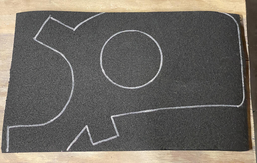

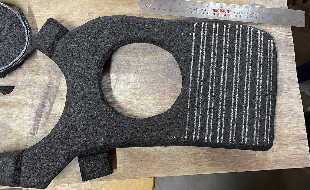

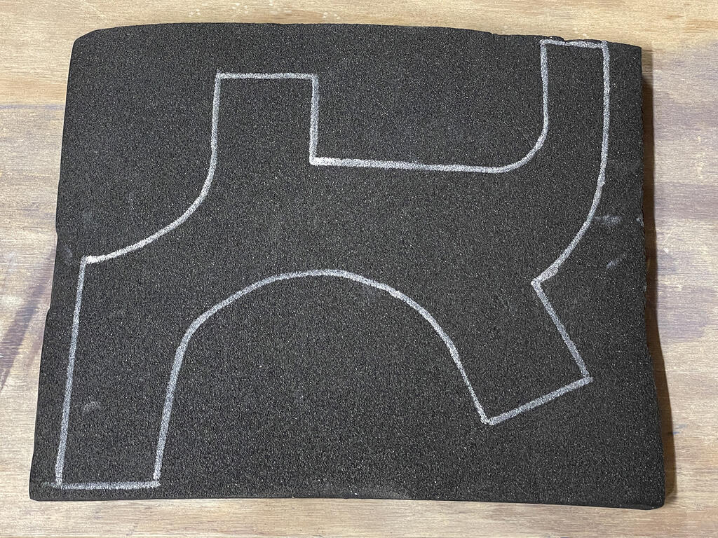

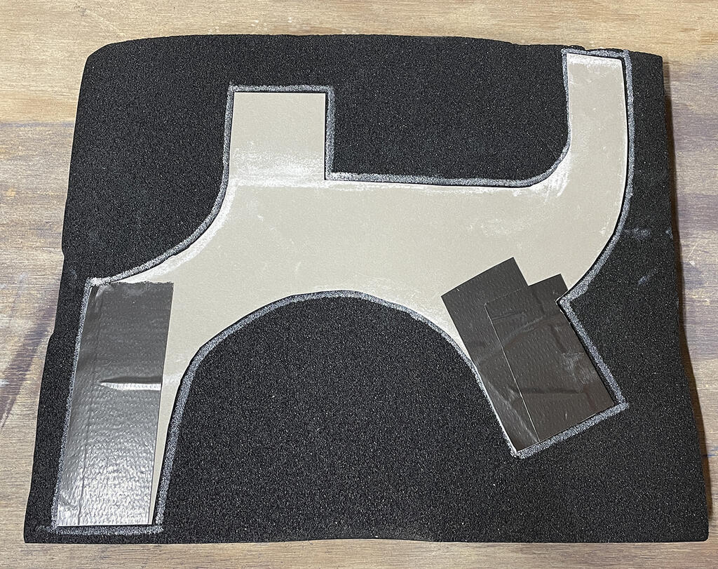

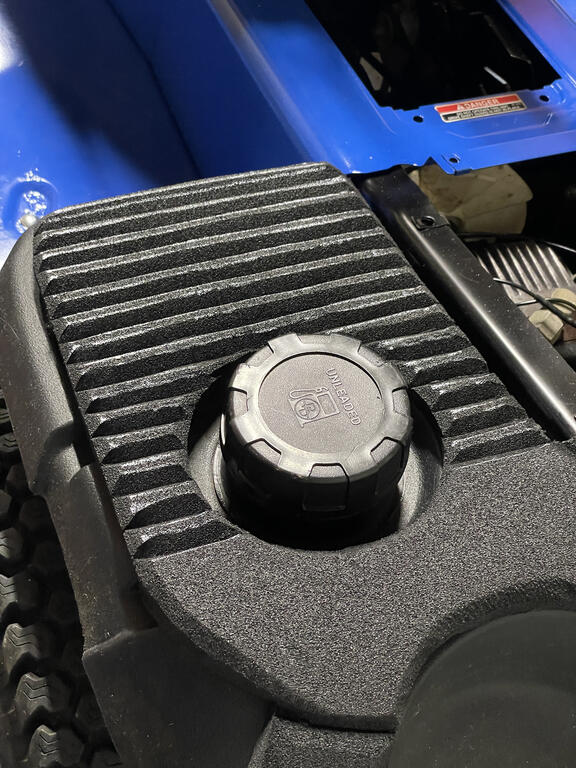

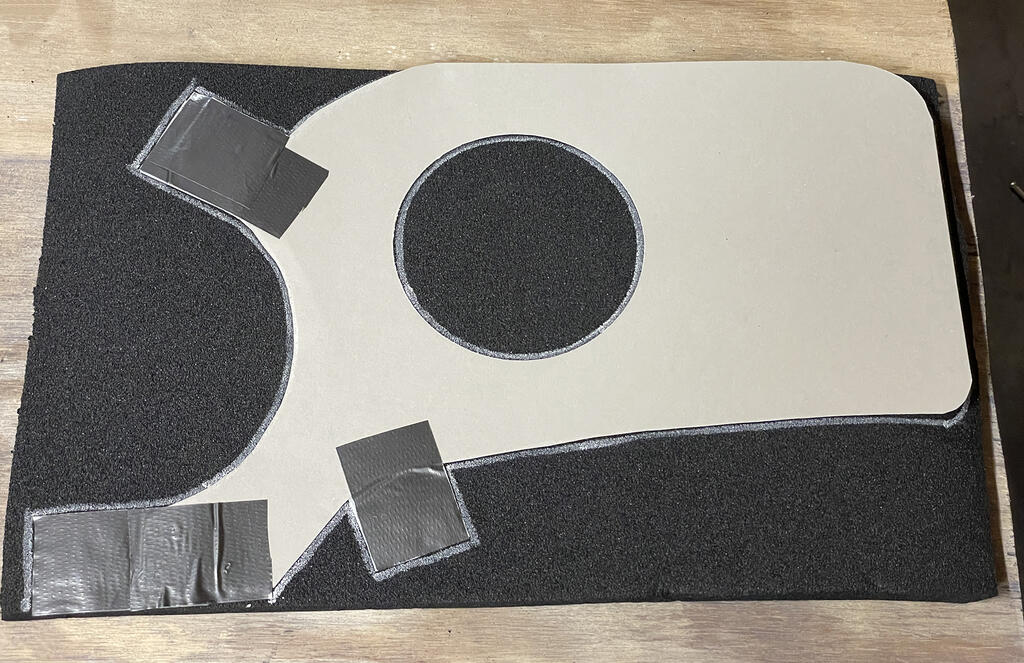

Blue Chips 706 #8 Posted November 4, 2025 I received the foam rubber that I ordered and started making the replacement foam fuel tank pads. Based on the tell-tale adhesive residue from the original foam pads, I made some paper templates that I think are a pretty close match to the original pad shapes. I then traced the patterns onto the new foam, cut out the pieces, and chamfered the edges with an angle grinder. Here are a couple of the patterns: I did a 'dry run' by setting the fender in place over the foam and fuel tank without gluing down the foam, and then pressing down on the fender to see where any adjustments in the foam might be needed. I think the replacement foam might be a little firmer than the original foam, and there was one area that didn't compress as easily as I thought it should, so I marked cut lines on that area and cut grooves into the foam to make it easier to compress. I cut all of the pads and grooves freehand, but any unevenness will be completely out of sight, hidden between the fender and the fuel tank. I didn't have anything to go by other than my gut feeling, but I 'think' that worked pretty well. I tried another dry run, and when I pushed down on the fender, it seemed to me that the tank was held firmly and fairly evenly without putting too much pressure on it. The next step is to adhere the foam pieces to the tank and do the final assembly. I'm just waiting for an order of special double-sided tape that is supposed to adhere well to low-surface-energy (LSE) materials. https://www.3m.com/3M/en_US/p/d/b5005036159/ I haven't used this particular tape before. We'll see how it goes... 2 Share this post Link to post Share on other sites
kpinnc 17,292 #9 Posted November 4, 2025 15 minutes ago, Blue Chips said: I cut all of the pads and grooves freehand, but any unevenness will be completely out of sight, hidden between the fender and the fuel tank. Freehand or not, that looks awesome! 1 1 Share this post Link to post Share on other sites
ebinmaine 77,547 #10 Posted November 4, 2025 10 minutes ago, kpinnc said: Freehand or not, that looks awesome! Nice 1 Share this post Link to post Share on other sites
