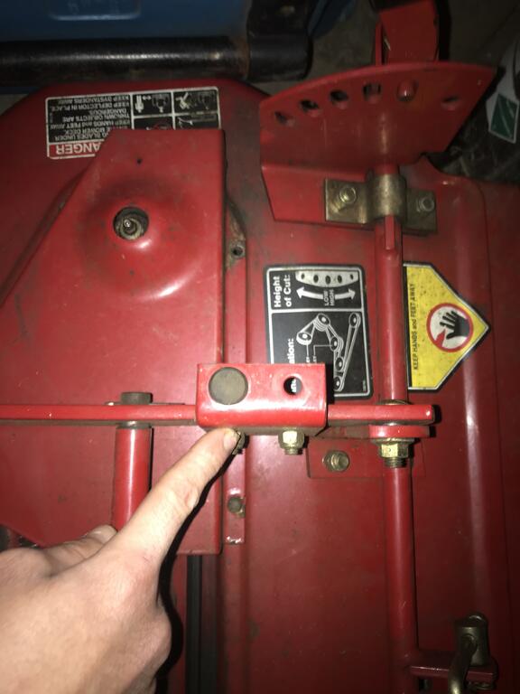

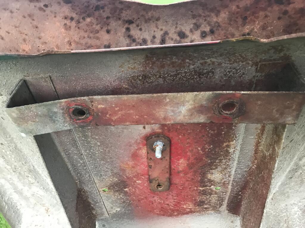

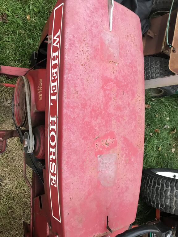

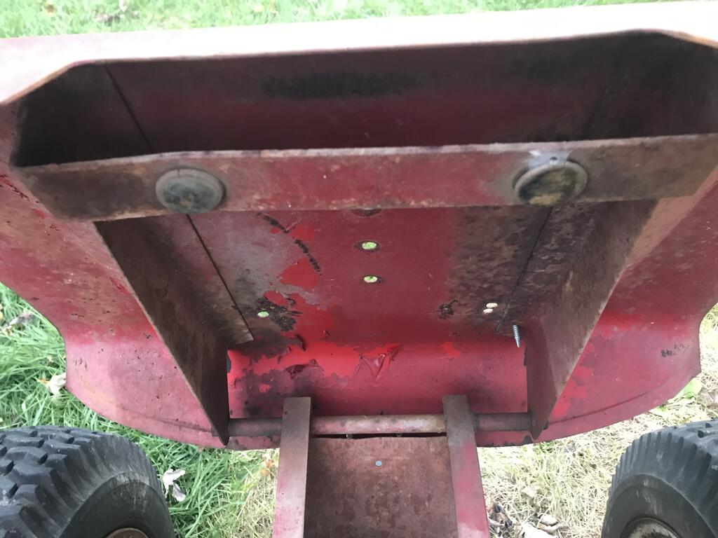

horseman with no horse 67 #1 Posted October 29, 2025 the rubber bumpers on all of my horses are worn or missing. to the point where belts are starting to scrape the seat pans and the pans themselves are rattly. also the little rubber dampeners on the hood for my c120 are missing. on top of that, ive noticed my paint fading and accumulating rust on my 855 hood . does anyone know where i can get the rubbers for both the hood and seat pans? are they the same as the decks? my deck needs the rubbers to help set the deck height. and any ideas to clean and polish the paint? i also have another issue with my c120 hood, the hood latch rod has pulled through the hood and often makes the hood pop open while mowing (very annoying and somewhat dangerous) i cant tell if theres supposed to be a rubber border on the lip of the hood to help it mate to the dash, and if so whats is part number? are my dash slots wore? i cant tell. Share this post Link to post Share on other sites

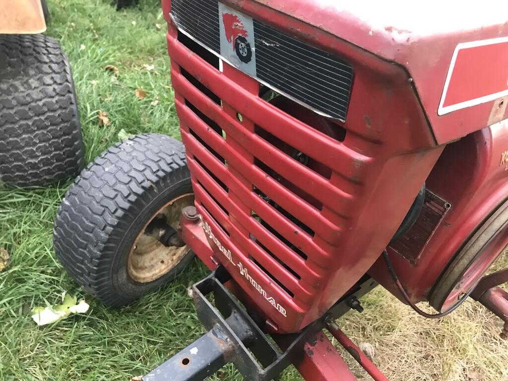

horseman with no horse 67 #4 Posted October 29, 2025 you can see the front of the hood vs the top. Share this post Link to post Share on other sites

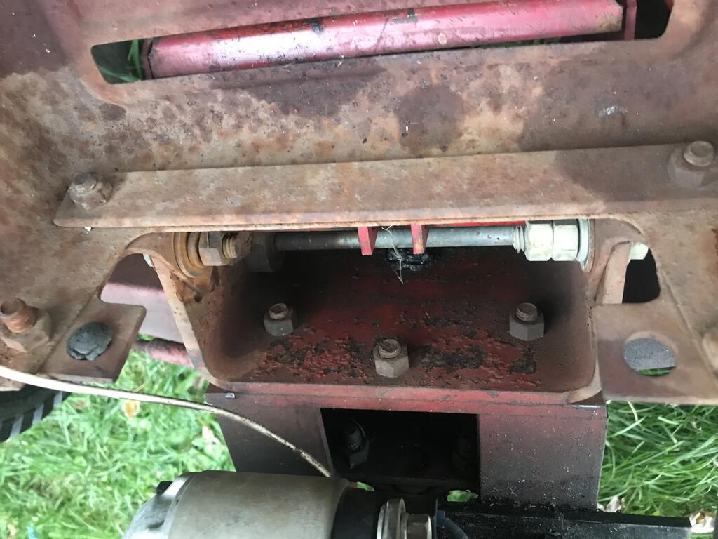

horseman with no horse 67 #5 Posted October 29, 2025 the hood latch & dash in question Share this post Link to post Share on other sites

Brockport Bill 2,259 #10 Posted October 30, 2025 the rubber "button" bumpers for the 36 rd mower lift carriage were available recently - i bought them 1-2- yrs ago -- the buffer border spacer along the top edge of back of hoodstands that the hood goes against has also been available online -- but you can also use the door edge material that is used as car door edge guards - --I have found KB as well as AZ both often have the various unusual items that are not generally found elsewhere - both vendors reliable and fair prices and always helpful 1 Share this post Link to post Share on other sites

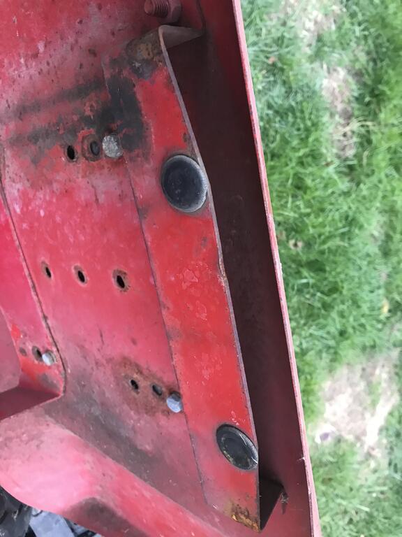

horseman with no horse 67 #13 Posted October 30, 2025 looks like the ones for the seat pan are the same. i guess the only thing left i would want to find is the hood trim. i cant seem to find it on A-Z although it might just be the way that im searching Share this post Link to post Share on other sites

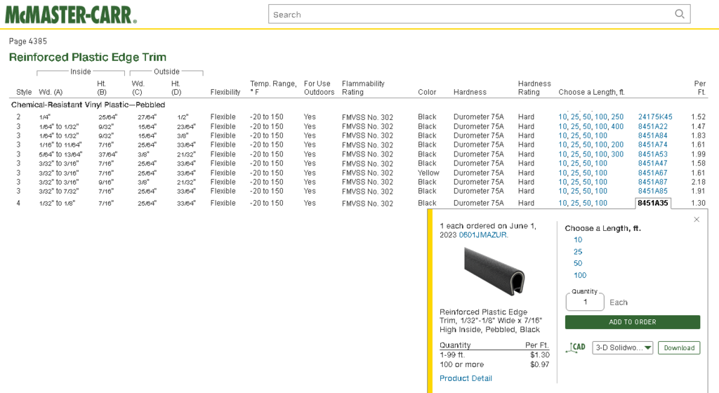

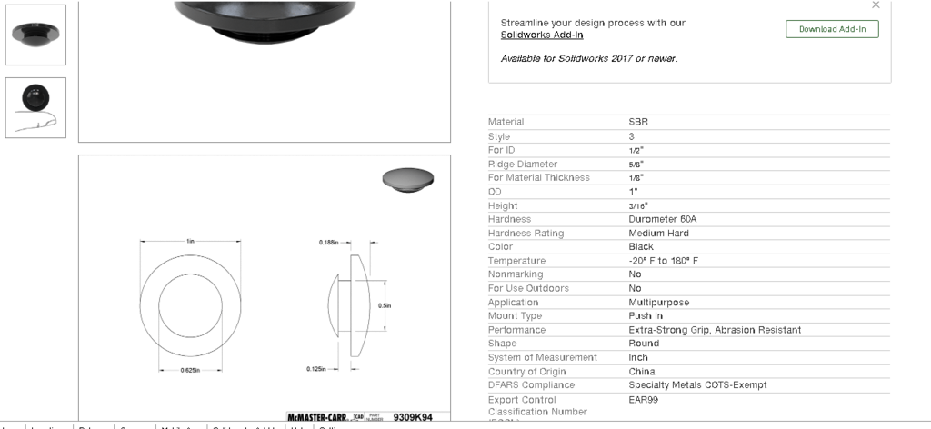

JoeM 9,710 #14 Posted October 30, 2025 not cheap but quick and fresh. you will have to double check the size of the rubber bumpers.there are many different ones on the site. these were used on my hood 3 1 Share this post Link to post Share on other sites
sqrlgtr 2,397 #15 Posted October 30, 2025 I just ordered and received 8 of the rubber buttons from Lincoln at A to Z tractor. If I remember right they are just a little over half price compared to Steiners price. 4 for 8.50. 1 1 2 Share this post Link to post Share on other sites
