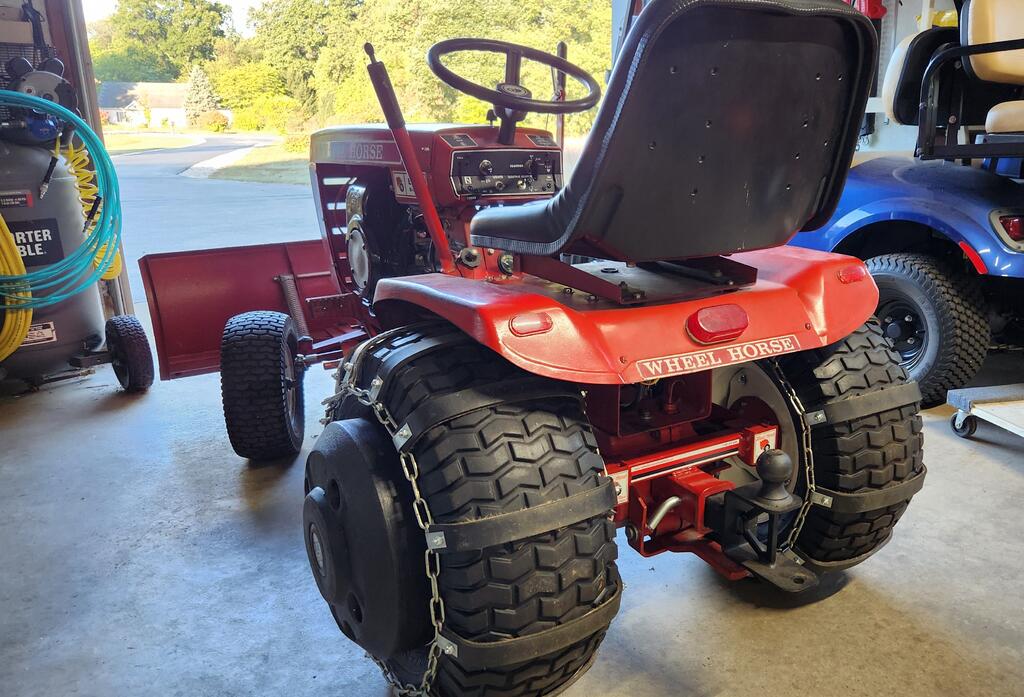

Racinbob 12,503 #4 Posted October 29, 2025 Once I get them fitted properly it makes reinstalling them the next season easier. I had to go a bit further this year. The 9.50's on my 2005 have their set fitted. But this is the first year for the 10.50's on the B-80. It had 8.50's on it and a set fitted properly. But those tires went on Dino because the bigger tires wouldn't clear a 42" mower deck. So I ordered up some more cross rubbers and added links as needed to convert the 8.50 chains to 10.50. It seems to have worked well. 3 2 Share this post Link to post Share on other sites

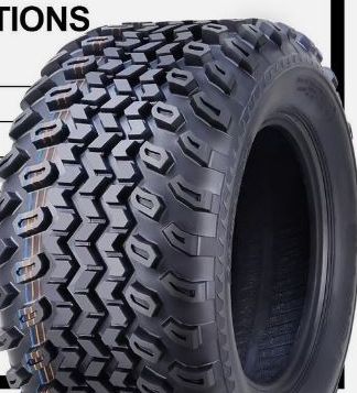

JoeM 9,390 #9 Posted October 30, 2025 I have not used chains since I went to these tires 3 Share this post Link to post Share on other sites

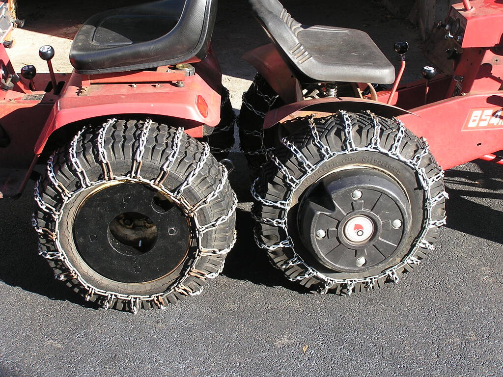

nylyon-(Admin) 8,638 #10 Posted October 30, 2025 These chains are a very tight fit without using any straps, like the others have said, let all the air out of the tire, work it around, it took vice grips to get the chain finally fastened. Inflated the tire and these are super tight now. 1 1 Share this post Link to post Share on other sites
