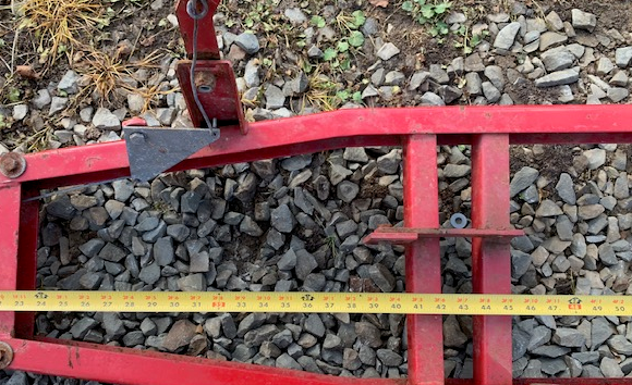

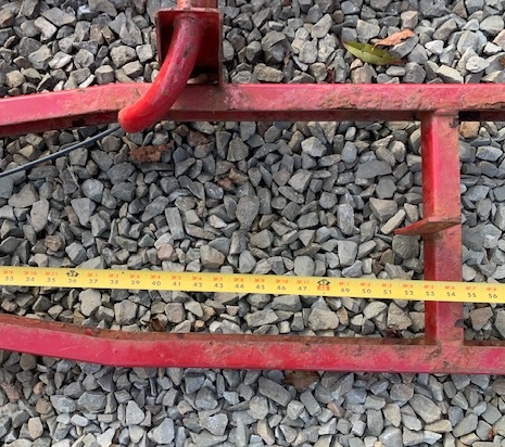

JoeM 10,317 #3 Posted October 29, 2025 5 hours ago, David414 said: A different handle, different lift mechanism, etc? I have went the other direction using a 520 plow on an xi. This is what I came up with going in your direction. Hope this helps. If you were close I would trade you. As odd as this may seem, the lift connection on an xi is about 5 1/2" closer to the rear axle bracket mounting pin. You will have to come up something for this to work. Also, there is some uncertainty with the blade pivot handle assy. It will be moved rearward too not sure if there is a clearance issue? As far as the tube clearing the foot pan. See pics. Due to the plow frame being longer a stabilizer might be necessary in the front at the axle area? If measuring from the plow pivot bolt toward the rear of the plow. 520 with extension measures 68" to the rear axle pin and 44 1/2" to the lift link connector. (23 1/2" from the rear axle bracket pin to the lift connector) (the extension adds 4 1/2" to a standard long frame plow) 520 W/extension pivot and lift link measured from the front plow pivot bolt XI is 70 1/2" to the rear axle pin and 52 1/2" to the lift connector. (18" from the rear axle bracket pin to the lift connector) XI pivot and lift link measured from the front plow pivot bolt. 1 Share this post Link to post Share on other sites
David414 323 #4 Posted October 29, 2025 10 hours ago, JoeM said: I have went the other direction using a 520 plow on an xi. This is what I came up with going in your direction. Hope this helps. If you were close I would trade you. As odd as this may seem, the lift connection on an xi is about 5 1/2" closer to the rear axle bracket mounting pin. You will have to come up something for this to work. Also, there is some uncertainty with the blade pivot handle assy. It will be moved rearward too not sure if there is a clearance issue? As far as the tube clearing the foot pan. See pics. Due to the plow frame being longer a stabilizer might be necessary in the front at the axle area? If measuring from the plow pivot bolt toward the rear of the plow. 520 with extension measures 68" to the rear axle pin and 44 1/2" to the lift link connector. (23 1/2" from the rear axle bracket pin to the lift connector) (the extension adds 4 1/2" to a standard long frame plow) 520 W/extension pivot and lift link measured from the front plow pivot bolt XI is 70 1/2" to the rear axle pin and 52 1/2" to the lift connector. (18" from the rear axle bracket pin to the lift connector) XI pivot and lift link measured from the front plow pivot bolt. Joe, thank you. Very helpful information. Share this post Link to post Share on other sites
