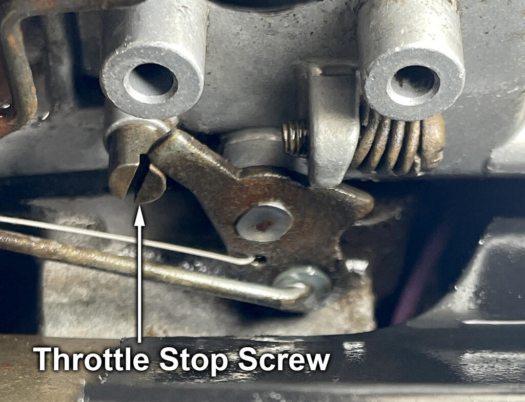

The only difference that I've been able to find (so far) between the CH18 used in a 2001 518xi and the CH20 used in a 2001 520xi is that the CH18S has a throttle stop screw on the carburetor that limits how far the throttle plate can open. The throttle stop screw is shown in a parts diagram for the CH18, but not in a parts diagram for the CH20.
Here's a photo of the throttle stop screw on my New Holland GT18 (which I believe has the same engine as a 518xi):
ch-18-throttle-stop-screw-smaller-image.thumb.jpg.c87b56bc9ccf5ebeae9536c1049036be.jpg

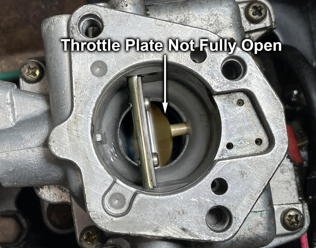

With the throttle stop screw in place, the throttle can't open all the way, perhaps only about 2/3 to 3/4 open, as shown below.
throttle-plate-not-fully-open-smaller-image.thumb.jpg.37fae04b62974abc27c455436b8008ae.jpg

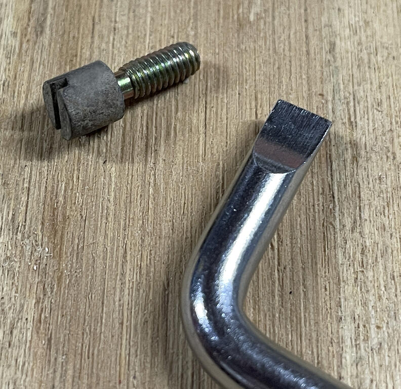

As an experiment, I have removed the throttle stop screw to allow the throttle to open all the way. I was able to remove it without pulling the carb by using a right-angle screwdriver:
throttle-stop-screw-and-right-angle-screwdriver-smaller-image.jpg.b054207ef9304b1269eabb0097b58e96.jpg
After removing the throttle stop screw, I readjusted the governor. However, I haven't finished reassembling the tractor yet, so I haven't given it a real-world test yet.

The throttle shaft stop screw isn't a high rpm limit. It's only a flow limiter.
On an unloaded engine you can still over rev with the screw in place given correct conditions.
The reason for the governor adjustment following removal of the screw is to realign the end movement of the governor with the - now more freely moving - throttle shaft.

I adjusted the governor per the instructions in the Service Manual, following the procedure for carburetor-equipped engines. Someone had messed with the governor before, as it had a different (wrong) screw where the governor arm clamps to the governor shaft, and they may have been overtightened it, since I had to file the clamp just slightly to make sure there was still a thin open gap at the end of the clamp when tightened against the shaft.
I still need to try it under typical loading conditions to make sure the sensitivity is adjusted correctly to prevent surging, and then re-check the RPM if I made any further adjustments.

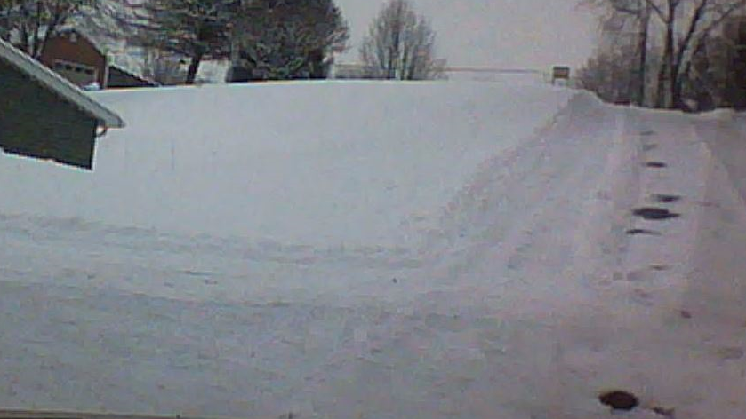

I have a steep hill behind my place and wide open mowing up it separates the men from the boys. I think it is about 9 degree.
I have seen a noticeable difference on the machines using the smart spark, they are strong and loose the least rpm.
A hill like that might be a good test, carried out with and without the throttle stop screw, and in both high and low range. I don't know if I'll get around to attempting a scientific or semi-scientific test, at least not until I have a few other projects out of the way.
