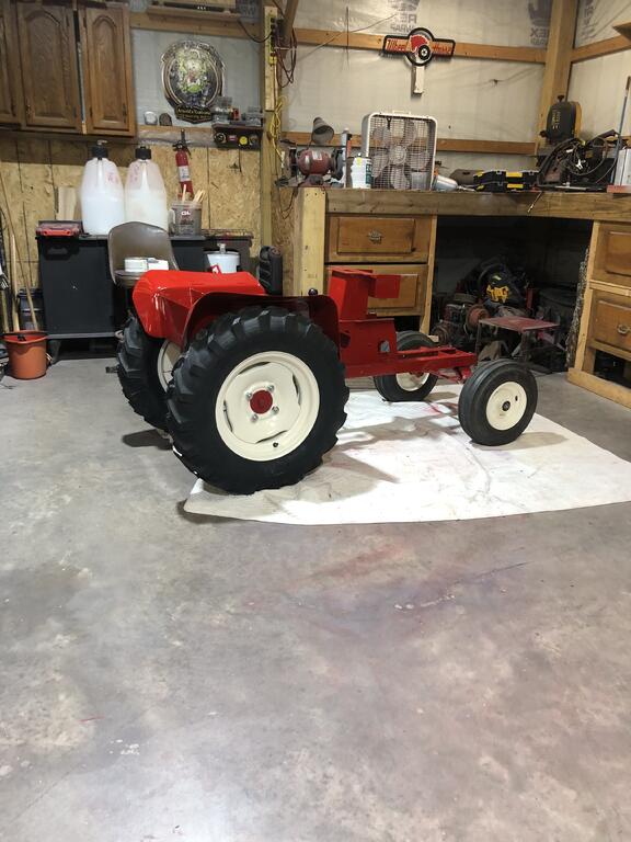

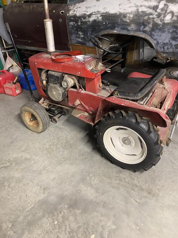

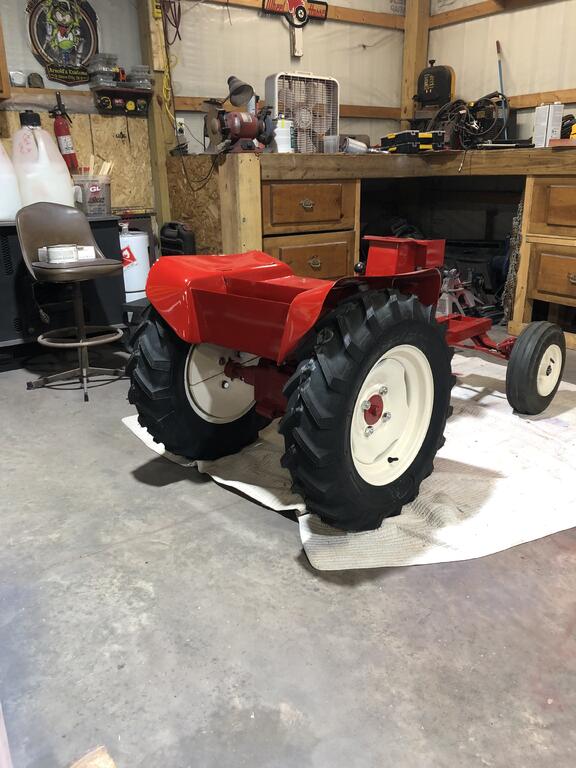

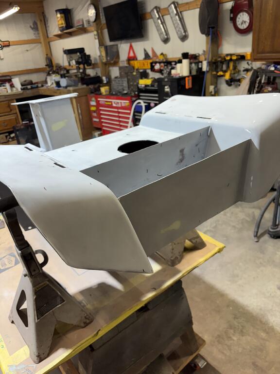

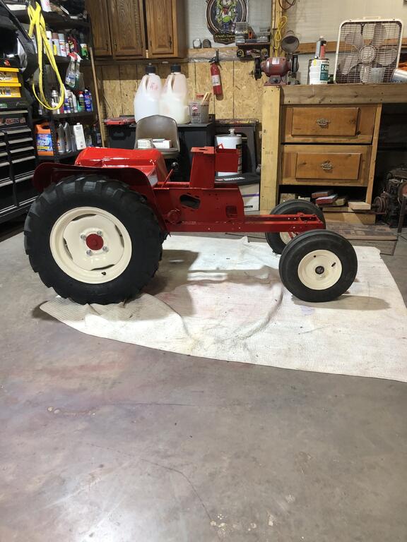

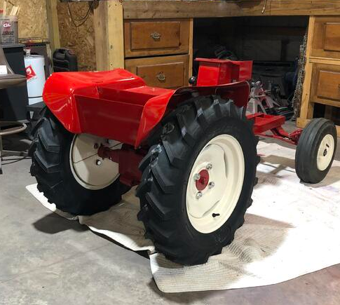

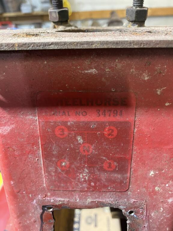

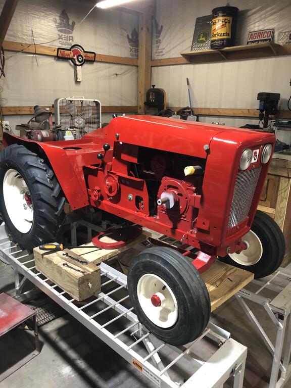

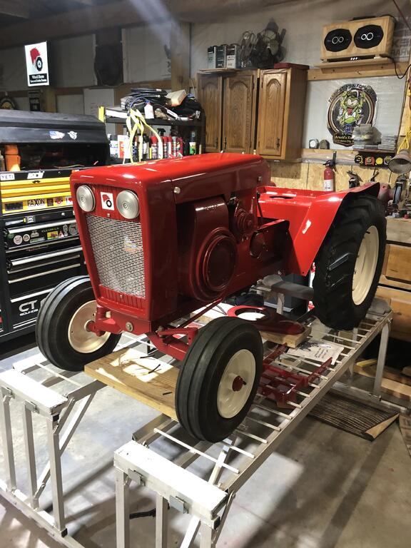

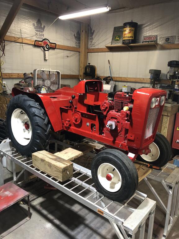

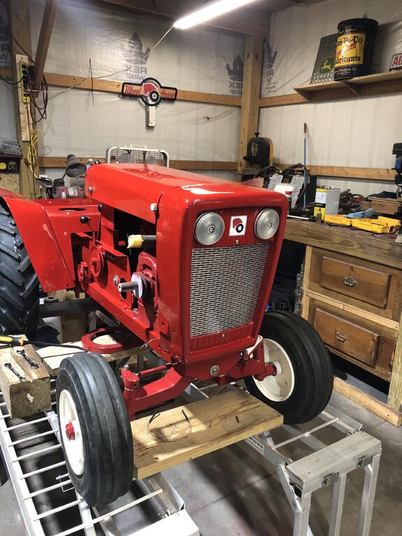

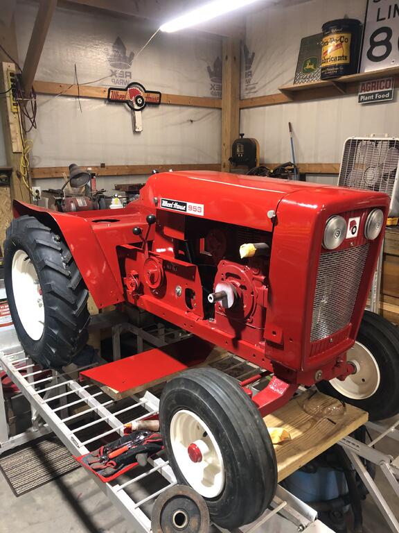

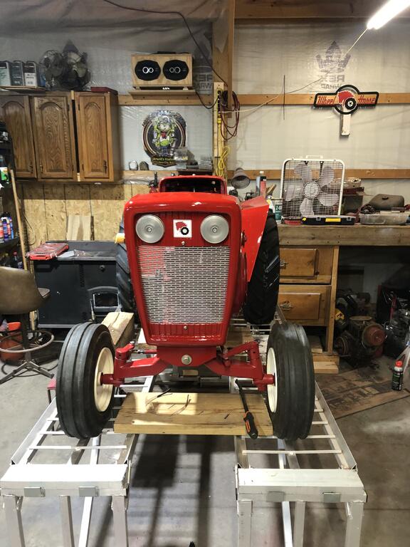

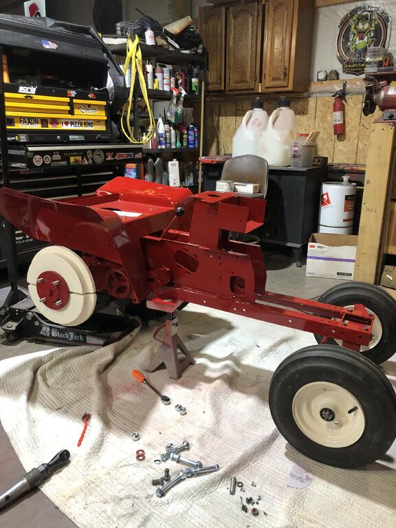

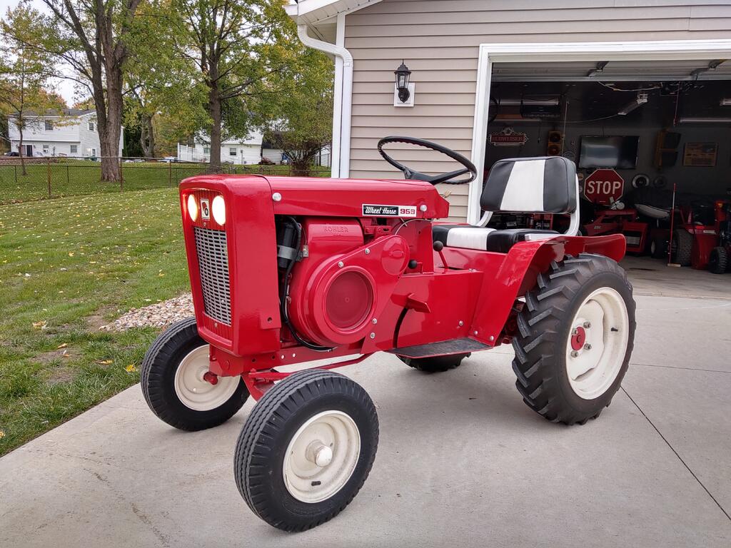

Tonytoro416 1,272 #1 Posted Monday at 04:37 PM Last of my grandfathers tractors to restore. Procrastinated on this although have been gathering parts for several years. I knew the tractor was modified but to what extent I had no clue. Ross steering boxed had been a problem for years luckily it was still there. Fuel tank and battery swapped positions and rock shaft and hydraulic lift was stripped long ago. Someone added a longer steering column and smaller steering wheel. Motor was swapped with a Briggs at some point. None of these original parts remained. Belt guards where thin tin type material. Toolbox rear sections was long gone replaced with plywood. Of course seat was missing along with frame so I began THE GOAL: for it to be close to factory as I could get it and function rebuilt Ross steering box and replaced column or tube with correct length one and remade toolbox to the best of my abilities 4 15 Share this post Link to post Share on other sites
ebinmaine 74,391 #2 Posted Monday at 04:39 PM Super cool... Share this post Link to post Share on other sites

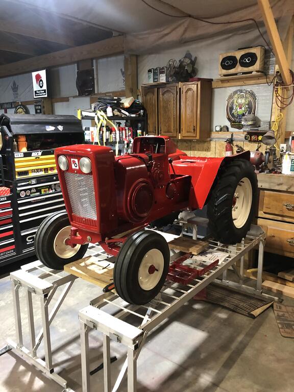

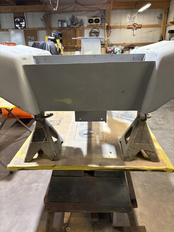

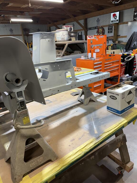

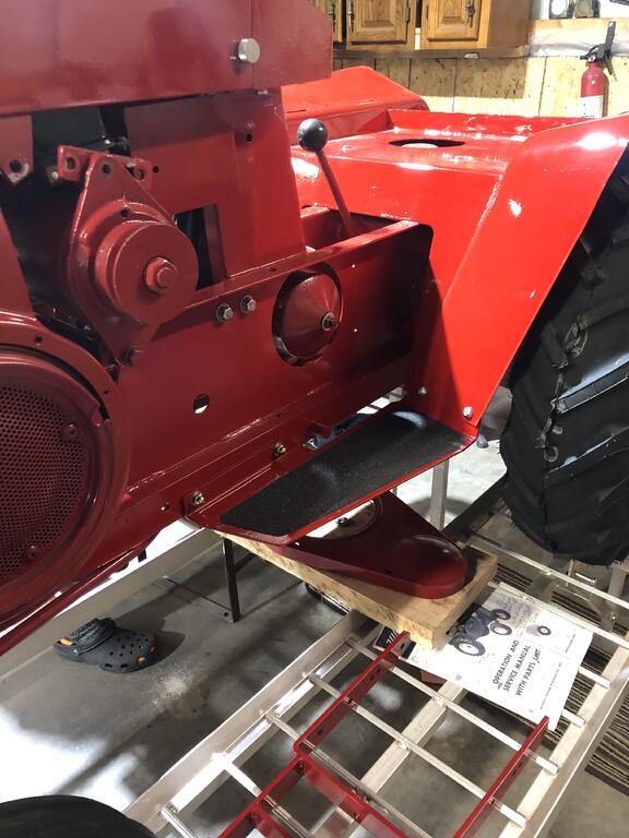

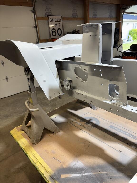

Tonytoro416 1,272 #3 Posted Monday at 04:44 PM (edited) Battery box fabbed although with countless other holes and things welded up front axle pin was excessively worn. Luckily axle itself was ok. The pin and frame not so much. I machined a bushing with a through hole and used a 1/2” grade 8 bolt . The front axle and steering are now whisper smooth and tougher than it ever was Edited Monday at 04:48 PM by Tonytoro416 2 20 Share this post Link to post Share on other sites

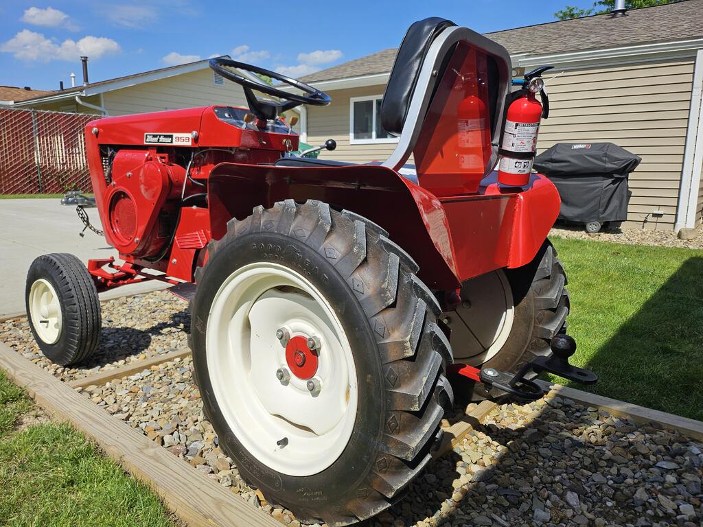

JoeM 8,789 #5 Posted Monday at 04:52 PM (edited) Awesome Work! I like attention to details. Making the weights match the wheels. Edited Monday at 04:53 PM by JoeM 4 1 Share this post Link to post Share on other sites
ML3 1,902 #6 Posted Monday at 05:40 PM 46 minutes ago, JoeM said: Awesome Work! I like attention to details. Making the weights match the wheels. 1 Share this post Link to post Share on other sites
ML3 1,902 #7 Posted Monday at 05:43 PM I like the 953s. Mine is an early model w/ross steering. s/n 62-613. My rear wheel weights are painted white also. 3 10 Share this post Link to post Share on other sites

953 nut 61,915 #11 Posted Monday at 11:09 PM Tony, that is an impressive transformation, your grandfather would be so proud to see his 953 looking better than new. 1 2 2 Share this post Link to post Share on other sites

Tonytoro416 1,272 #13 Posted yesterday at 12:49 AM 1 hour ago, 953 nut said: Tony, that is an impressive transformation, your grandfather would be so proud to see his 953 looking better than new. Thank you sir. That means a lot 1 1 Share this post Link to post Share on other sites

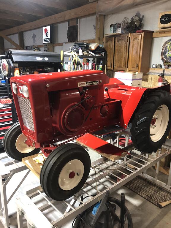

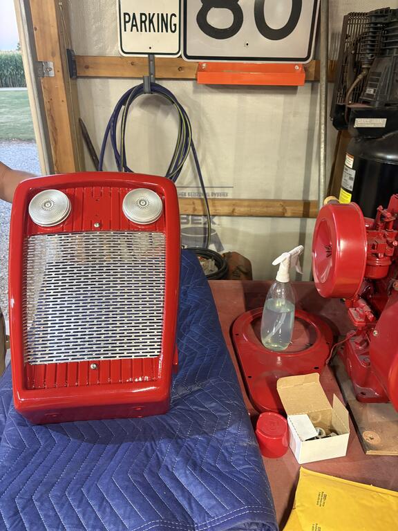

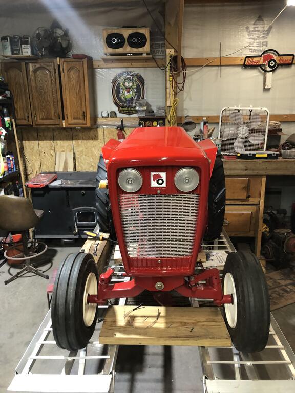

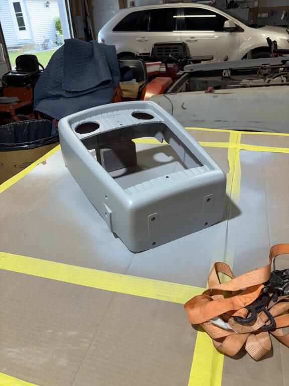

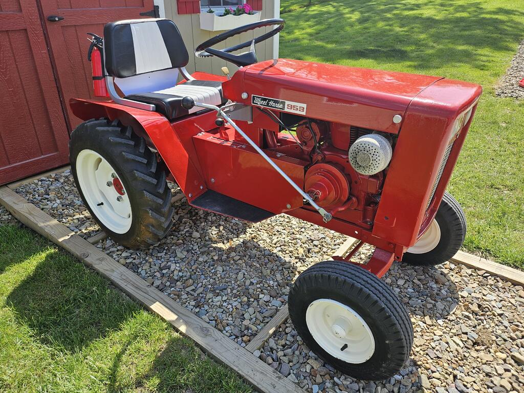

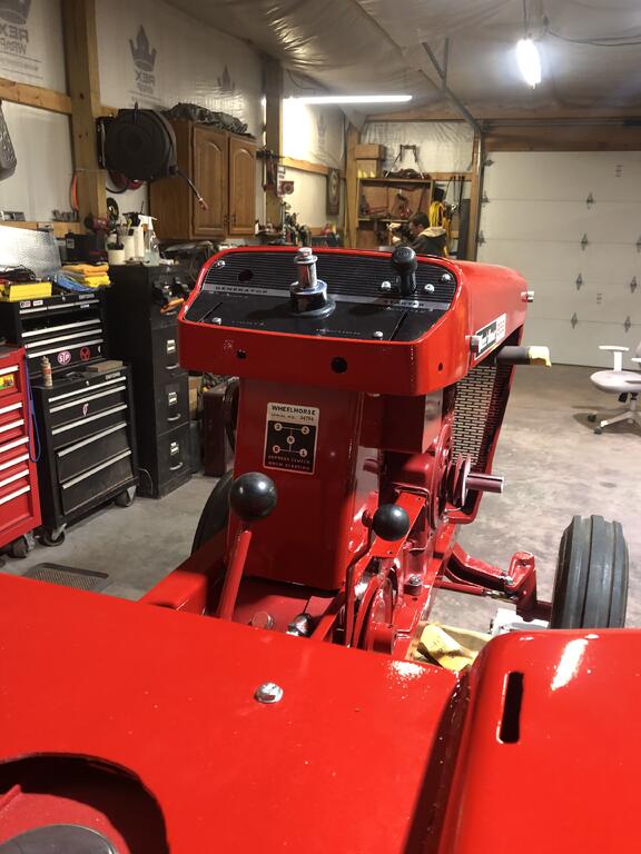

Tonytoro416 1,272 #19 Posted 4 hours ago Not a lot of progress but decals on. And some other odds and ends things. Mostly buttoning up and fitment addressing. Kind of stepped back to see what else I need part wise and tried to get some of that on its way 5 Share this post Link to post Share on other sites
