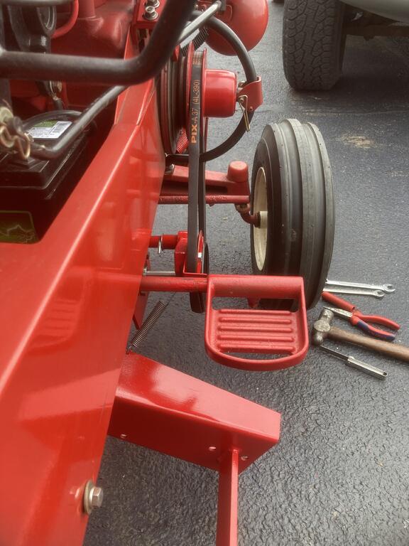

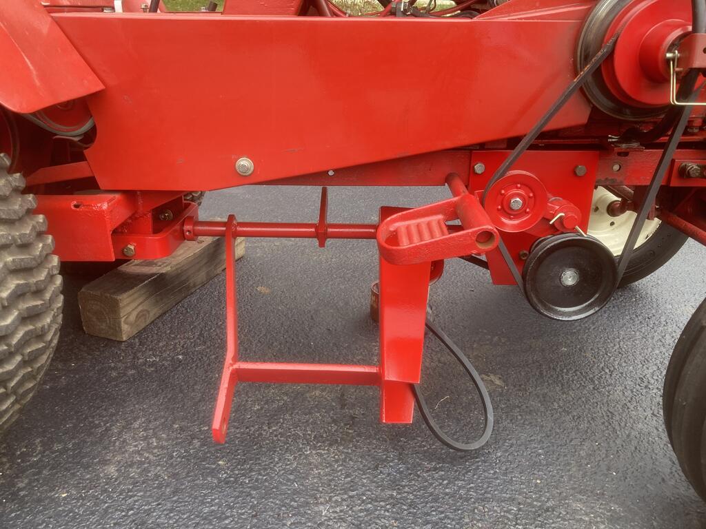

"Manic-Mechanic" 1,485 #1 Posted October 26, 2025 (edited) I have finally did the rough in on the metal & pulleys Brackets welded up and idler set up! Next is test run the pulley and bracket assembly The idler is half of a broken 18 Auto brake pedal! Edited October 26, 2025 by "Manic-Mechanic" 4 1 1 Share this post Link to post Share on other sites

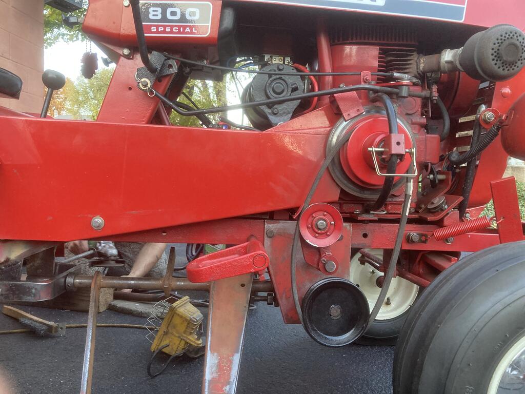

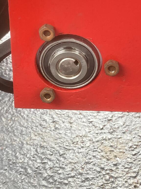

"Manic-Mechanic" 1,485 #7 Posted November 3, 2025 I set up the assembly with things loose check for alignment issues, seems good. Used a 1/2-39 belt, could go to standard 38, (store was out), none too shabby. Alignment issues dead on, shaft is 11” This should work Shaft is set just flush. Time for some new carriage bolts, 4,5/16-3/4 and two 5/16-1 4 Share this post Link to post Share on other sites
"Manic-Mechanic" 1,485 #8 Posted November 3, 2025 Adjusting the clutch brake is always fun, not too tight, not too loose! 1 Share this post Link to post Share on other sites

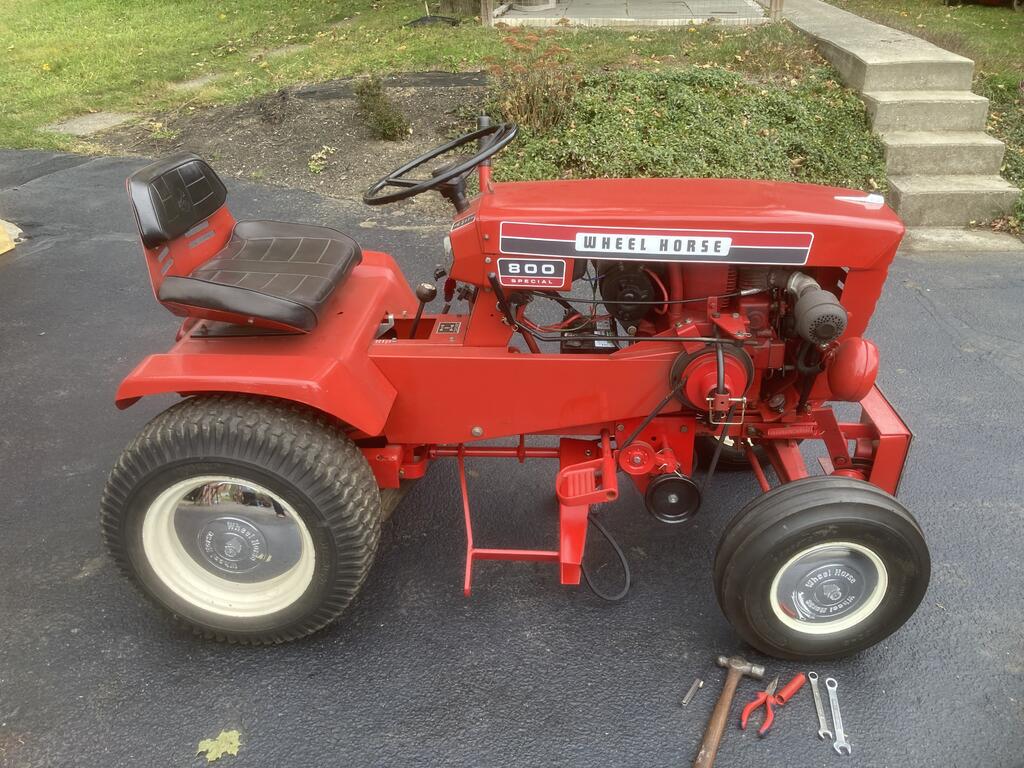

kpinnc 18,851 #9 Posted November 4, 2025 6 hours ago, "Manic-Mechanic" said: I set up the assembly with things loose check for alignment issues, seems good. I've always wanted a sickle bar. What a handy thing to have to cut around ditch banks and fences! Beautiful tractor! I look forward to seeing the sickle all mounted up. 2 1 Share this post Link to post Share on other sites
"Manic-Mechanic" 1,485 #10 Posted November 4, 2025 Just now, kpinnc said: I've always wanted a sickle bar. What a handy thing to have to cut around ditch banks and fences! Beautiful tractor! I look forward to seeing the sickle all mounted up. That’s my old “Frankenstein”, modified 800 special-retro Share this post Link to post Share on other sites
kpinnc 18,851 #11 Posted November 4, 2025 2 minutes ago, "Manic-Mechanic" said: That’s my old “Frankenstein”, modified 800 special-retro My wife says "mutts" are the best. I agreed with her of course. 2 Share this post Link to post Share on other sites
"Manic-Mechanic" 1,485 #12 Posted November 4, 2025 21 hours ago, kpinnc said: My wife says "mutts" are the best. I agreed with her of course. She is correct! Share this post Link to post Share on other sites

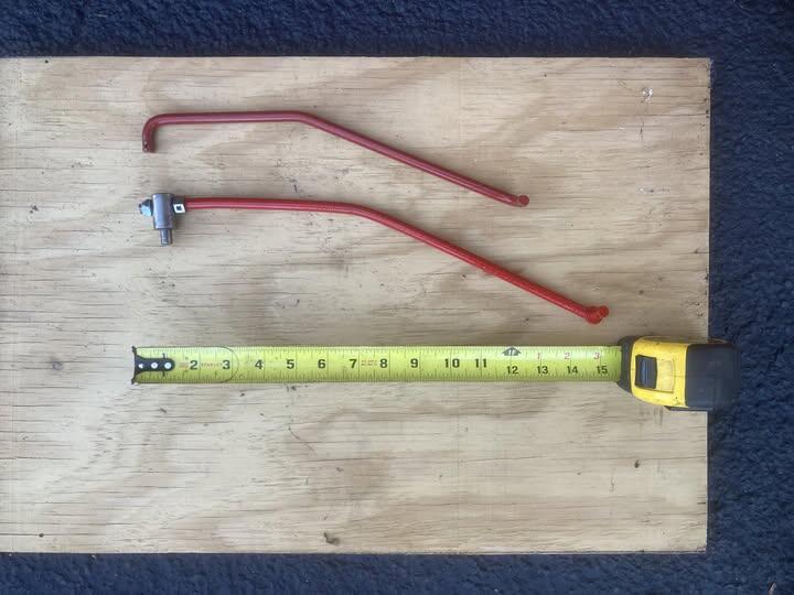

"Manic-Mechanic" 1,485 #13 Posted November 4, 2025 (edited) I have the lift rod and travel hook & bracket. So far, the lift rod is too short, so I fit my own rod with a trunnion Edited November 4, 2025 by "Manic-Mechanic" constant glitches in text 1 Share this post Link to post Share on other sites

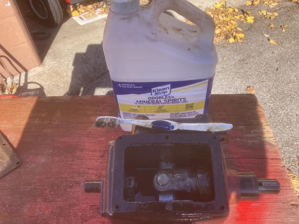

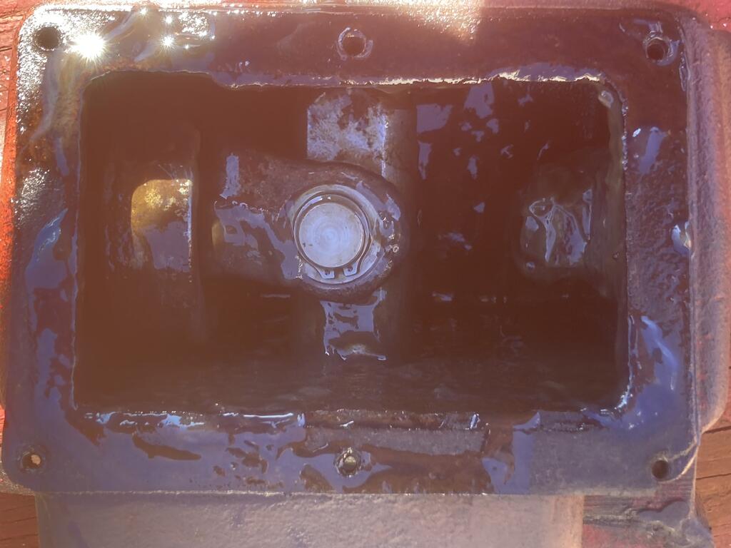

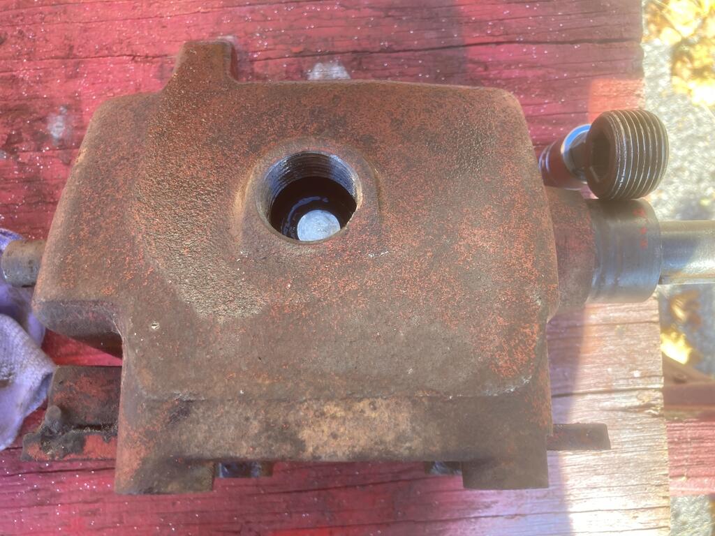

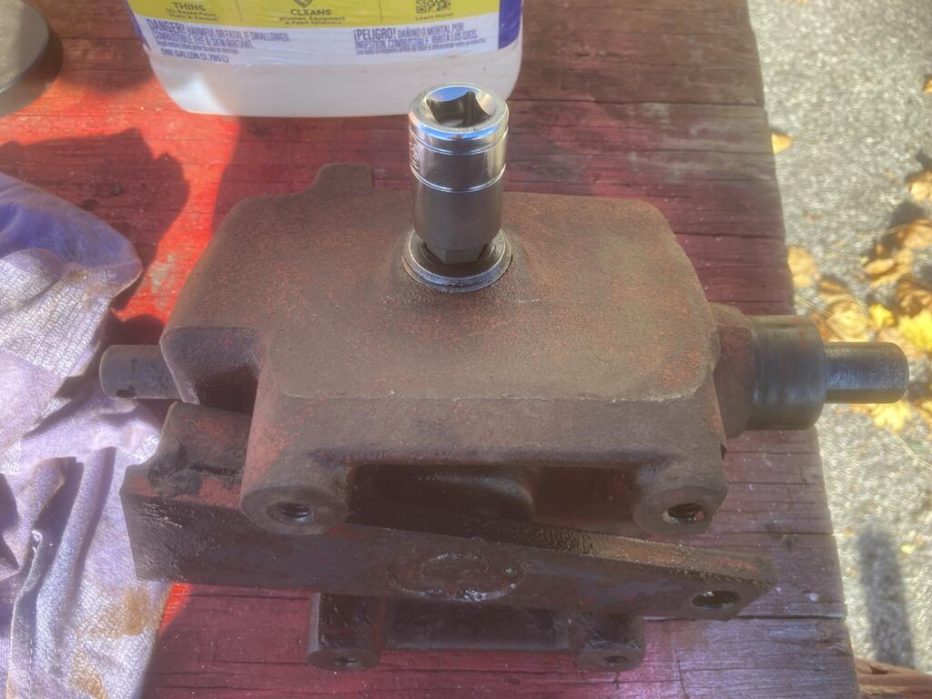

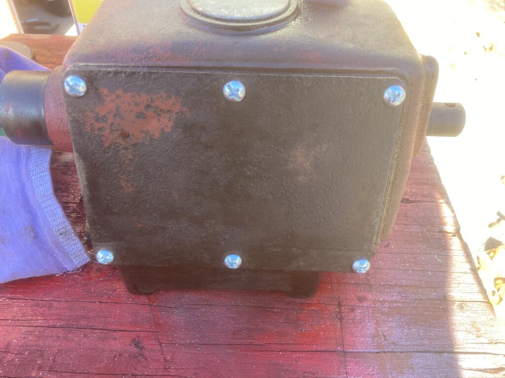

"Manic-Mechanic" 1,485 #14 Posted November 10, 2025 I have finally removed the plug and opened the wobble box! Something Green between grease and oil! A nice mineral oil wash The rusty plug from Hell! Cleaned up the plug & threads Fit my 10-24’s and shook the grease , debris loose. No leaks! After a thorough examination of internals very happy with the condition and may not need a rebuild 1 1 Share this post Link to post Share on other sites

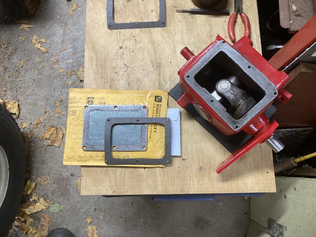

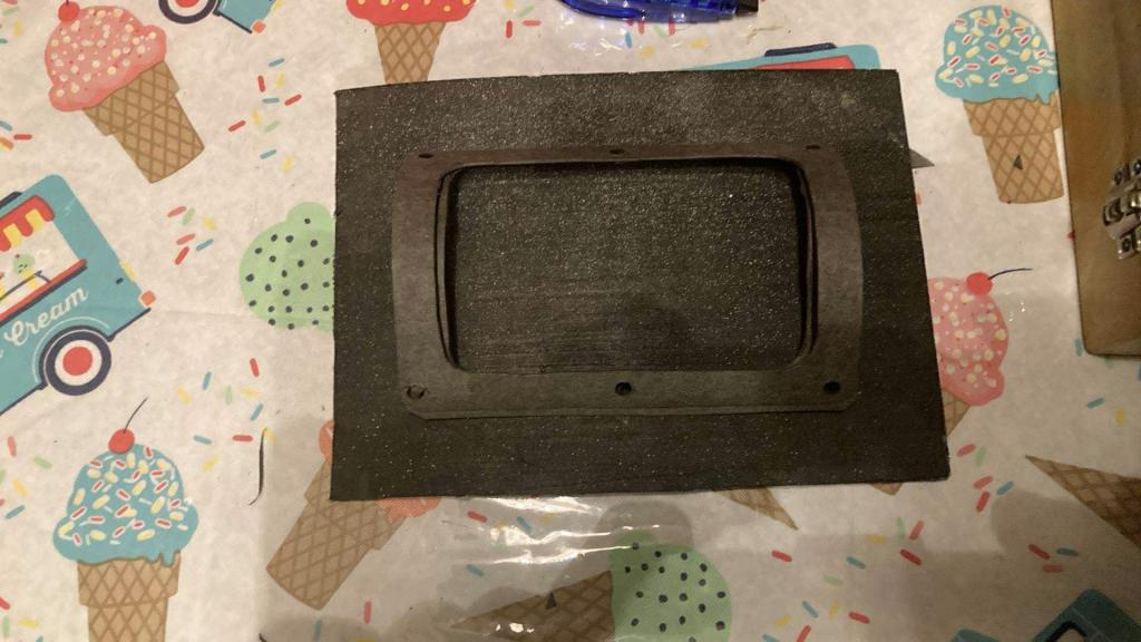

"Manic-Mechanic" 1,485 #16 Posted November 19, 2025 (edited) Wobble box gaskets Edited November 19, 2025 by "Manic-Mechanic" 1 Share this post Link to post Share on other sites

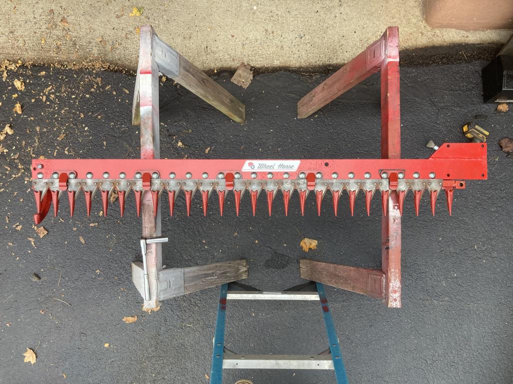

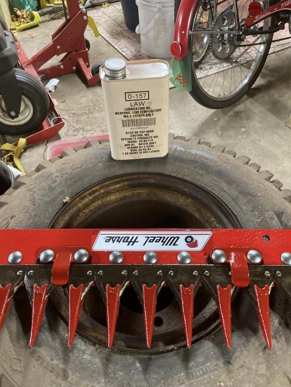

"Manic-Mechanic" 1,485 #17 Posted November 19, 2025 (edited) Getting the sickle bar tuned… Edited November 25, 2025 by "Manic-Mechanic" 1 Share this post Link to post Share on other sites
peter lena 9,991 #18 Posted November 19, 2025 @ Manic Mechanic lookin good , looks like you are on track , first photo , see the corner of frame hitch pin clip ? match that up with the removable clip on pto lever end , swing arm ? clip using a medium tension extension spring , will take the buzz out of function , what are you going to use ib the wobble box for lube ? always wanted to do one of those , also have just the surroundings to practice on , pete 1 Share this post Link to post Share on other sites
"Manic-Mechanic" 1,485 #19 Posted November 19, 2025 7 minutes ago, peter lena said: @ Manic Mechanic lookin good , looks like you are on track , first photo , see the corner of frame hitch pin clip ? match that up with the removable clip on pto lever end , swing arm ? clip using a medium tension extension spring , will take the buzz out of function , what are you going to use ib the wobble box for lube ? always wanted to do one of those , also have just the surroundings to practice on , pete Not sure where you’re heading with the clip & spring, maybe enlighten me on that one. 30wt oil will be my lube as per manual, hopefully she won’t leak! Share this post Link to post Share on other sites
peter lena 9,991 #20 Posted November 19, 2025 @Manicmacanic usually a vibrating / noisy set up , found a spring tension , lets it work without the bounce , guess 30 wt is the call , thought it would be more enhanced / rating . pete 1 Share this post Link to post Share on other sites
"Manic-Mechanic" 1,485 #21 Posted November 19, 2025 (edited) 23 minutes ago, peter lena said: @Manicmacanic usually a vibrating / noisy set up , found a spring tension , lets it work without the bounce , guess 30 wt is the call , thought it would be more enhanced / rating . pete Some have run thicker/heavier lube types due to leakage, however if it leaks needs rebuilt. I had it soaking internally with mineral oil to clean it out and no leaks with that. Although not a perfect science I will fill the box 30wt and let it set before attaching it to the assembly. (Would make it easier to have it full prior) Where was this spring to attach again, off the bar to where exactly and has this been done Edited November 19, 2025 by "Manic-Mechanic" 1 Share this post Link to post Share on other sites

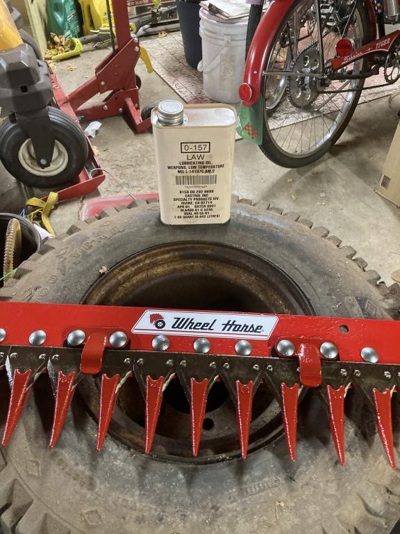

"Manic-Mechanic" 1,485 #22 Posted November 20, 2025 (edited) I have the wobble box ready to fill and the bar lubed with 0-157. The 0-157 is outstanding! Pete… Edited November 25, 2025 by "Manic-Mechanic" 1 Share this post Link to post Share on other sites

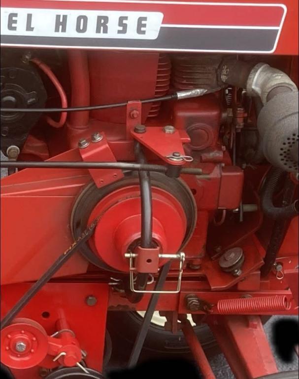

peter lena 9,991 #23 Posted November 20, 2025 @Manicmacanic on the pto lever outer swing arm , spring hitch clip , that allows you to access it ., its forward end , is in line to LOWER TRACTOR FRAME , hitch pin clip ,end circle , connected those 2 points with an extension spring , medium tension . stops buzzing clip bouncing around . simple easy , only if you want to, have regularly gone over / eliminated repetitive issues . looking for a picture , pete 1 Share this post Link to post Share on other sites

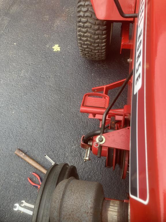

"Manic-Mechanic" 1,485 #24 Posted November 20, 2025 (edited) 25 minutes ago, peter lena said: @Manicmacanic on the pto lever outer swing arm , spring hitch clip , that allows you to access it ., its forward end , is in line to LOWER TRACTOR FRAME , hitch pin clip ,end circle , connected those 2 points with an extension spring , medium tension . stops buzzing clip bouncing around . simple easy , only if you want to, have regularly gone over / eliminated repetitive issues . looking for a picture , pete The “hitch clip” off outer PTO Arm? The only PTO outer arm I know of is off the column to the cone pulley assembly. I’m willing to make an attempt but still not getting it, my minds eye is blurry! Here’s PTO with spring clip Edited November 20, 2025 by "Manic-Mechanic" Share this post Link to post Share on other sites
"Manic-Mechanic" 1,485 #25 Posted November 20, 2025 (edited) Say Pete, do you use a sealant or shellac on a paper gasket at all? I used a super thin rub of Ultra Black RTV (My Indian Head was totally dried up!) Edited November 20, 2025 by "Manic-Mechanic" 1 Share this post Link to post Share on other sites
