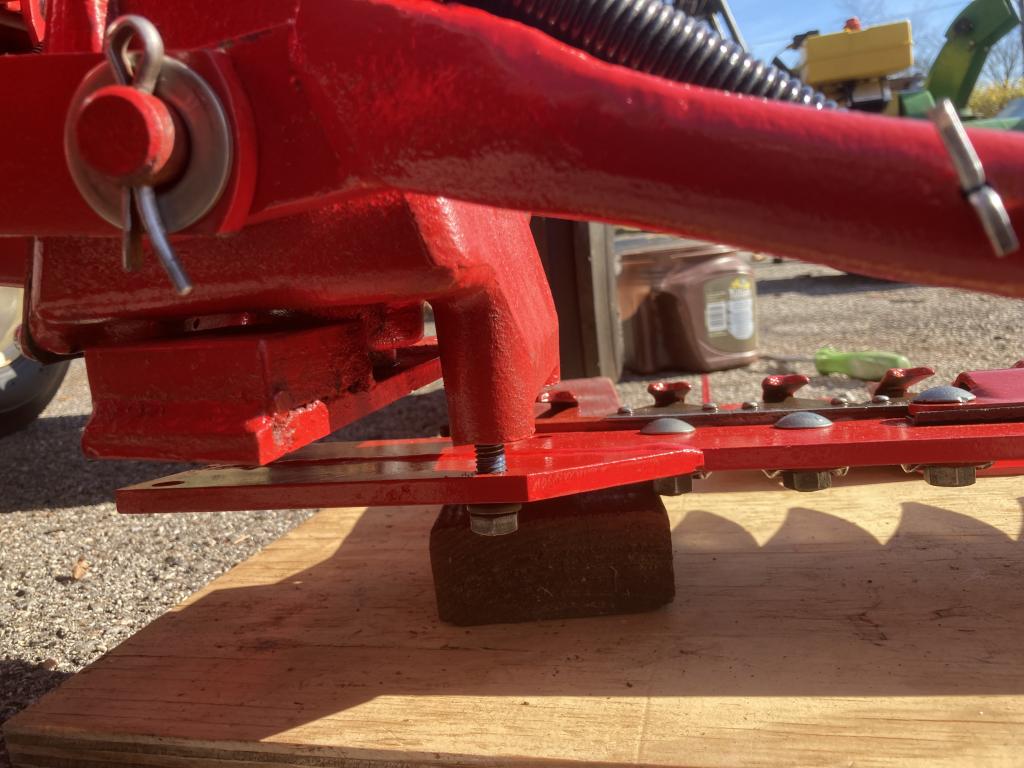

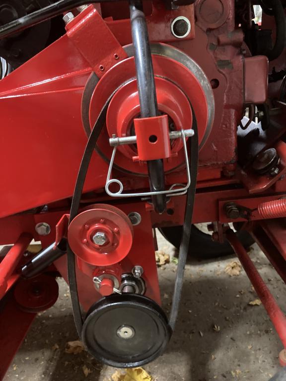

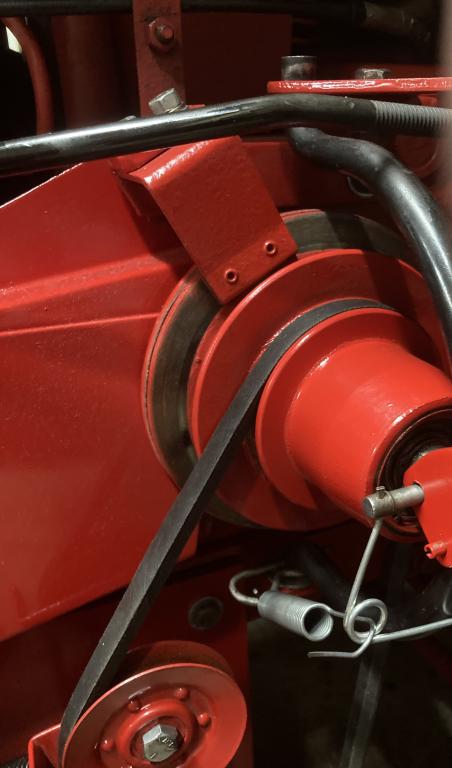

peter lena 9,785 #26 Posted November 20, 2025 @Manicmacanic found it ! https://www.google.com/search?q=snap+pin+coil+pin&rlz=1C1CHBF_enUS866US866&oq=snap+pin+coil+pin+&gs_lcrp=EgZjaHJvbWUyBggAEEUYOTIGCAEQRRg90gEJMzMzNjZqMGo0qAIAsAIA&sourceid=chrome&ie=UTF-8#oshopproduct=pid:14476869342826026615,oid:14476869342826026615,iid:15958334489552840822,pvt:hg,pvo:3&oshop=apv&pvs=0 called snap pin coil tension pin , have it on my 3 horses , lets you easily connect to frame mounted hitch pin clip , rounded end . like a medium tension hook ended pull spring to stop related linkage noise , your first photo shoes the original clip , this type with small corner tension circle , is a perfect spring pull tension point . all my pto, s are quiet running , no buzzing . couple bucks . you might turn it and frame hitch pin clip , around so it can work inside of the belt drive . just an idea , pete 1 Share this post Link to post Share on other sites

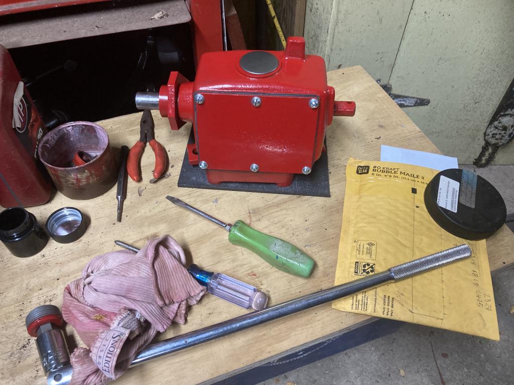

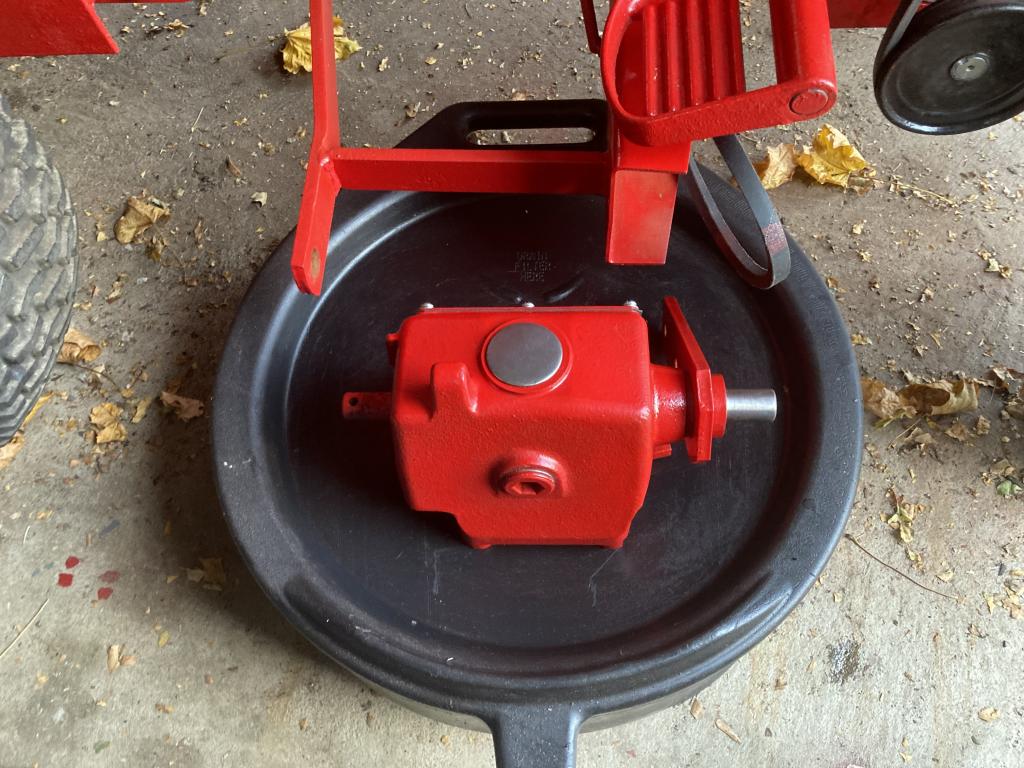

"Manic-Mechanic" 1,485 #28 Posted November 21, 2025 (edited) Here you go, this style clip! wobble box ready for oil (take note of the anti-seize on the plug) Edited November 21, 2025 by "Manic-Mechanic" Share this post Link to post Share on other sites

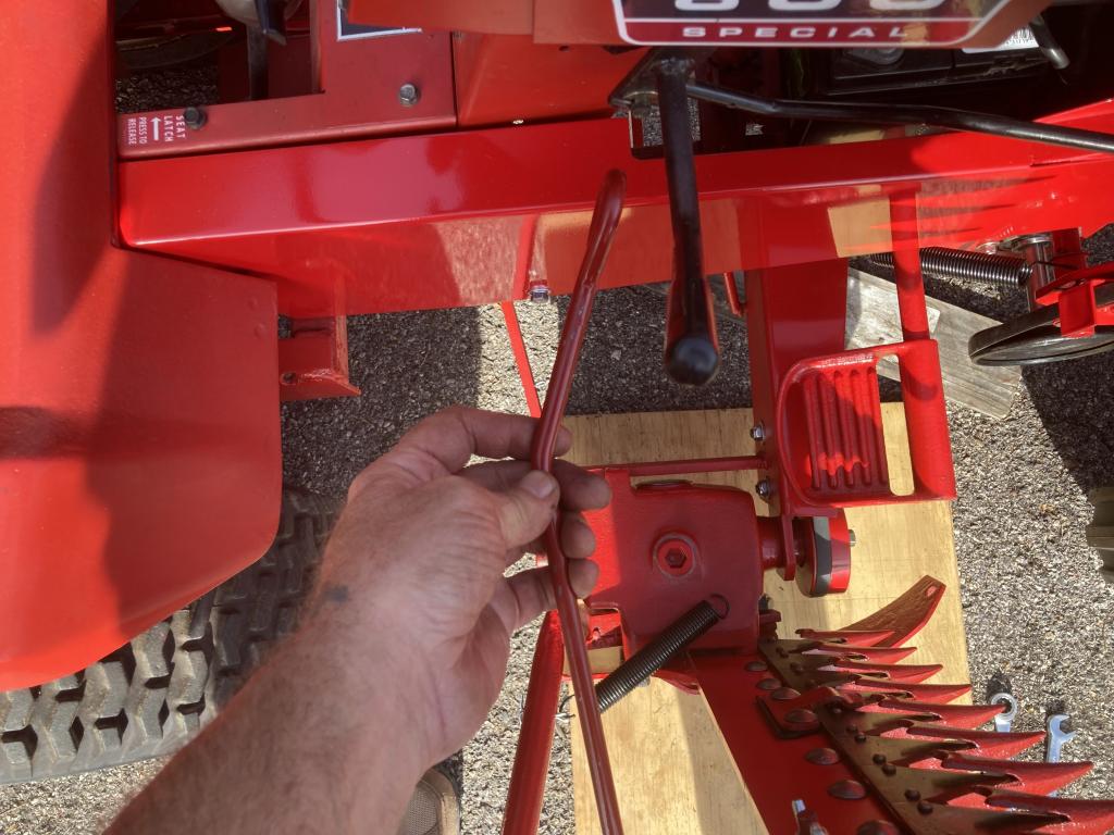

peter lena 9,785 #30 Posted November 21, 2025 @Manicmacanic glairing to me ,regularly look at ease of functional operation , EVERYWHARE , BASICALLY HOW CAN I , IMPROVE THIS ? your related FRAME MOUNT , to swing arm is called a hitch pin clip , simply changed direction of pin circle mount s to allow an extension spring for a noise stopping / clearance verified , connection . done a lot of this simple type of problem eliminating , circle to circle spring tension stops the buzzing hardware noise . regularly do this type of trials .also related to this, is pulley lubrication issues , INCREMENTAL bearing hang ups , regularly starts a BELT BOUNCE . thats a whole different issue . thats what led me to a grease , clean / change out , in every related bearing , on decks , have this in play for years , no noise or vibration , or bearing failures , also have smooth / quiet pto lever engagement , never burned out a clutch disc . working on a tire chain idea now , pete 1 Share this post Link to post Share on other sites
"Manic-Mechanic" 1,485 #31 Posted November 21, 2025 2 hours ago, Pullstart said: I do that often.. at least on one side. Some people use chapstick, to give that wax ring style seal, but not stick together. That’s a hot rodder carburetor trick some old guy at work (my boss) taught me! Yeah, that’s great for stuff you must open up more than once, I certainly hope this won’t be the case! 1 Share this post Link to post Share on other sites
"Manic-Mechanic" 1,485 #32 Posted November 21, 2025 38 minutes ago, peter lena said: @Manicmacanic glairing to me ,regularly look at ease of functional operation , EVERYWHARE , BASICALLY HOW CAN I , IMPROVE THIS ? your related FRAME MOUNT , to swing arm is called a hitch pin clip , simply changed direction of pin circle mount s to allow an extension spring for a noise stopping / clearance verified , connection . done a lot of this simple type of problem eliminating , circle to circle spring tension stops the buzzing hardware noise . regularly do this type of trials .also related to this, is pulley lubrication issues , INCREMENTAL bearing hang ups , regularly starts a BELT BOUNCE . thats a whole different issue . thats what led me to a grease , clean / change out , in every related bearing , on decks , have this in play for years , no noise or vibration , or bearing failures , also have smooth / quiet pto lever engagement , never burned out a clutch disc . working on a tire chain idea now , pete You know that is a simple thing, now that I get where you’re going with the spring, long as it doesn’t interfere. Another challenge will be the sickle bar and related vibrations 1 Share this post Link to post Share on other sites
peter lena 9,785 #33 Posted November 21, 2025 @Manicmacanic often refer to using a roller stool , so i can look at / watch what's going on , ironically many corrections / eliminations , are a small adjustment away . did a lot of that on my first plow frame , heim joint conversion / steering quadrant detailing , squeeze lever function was the main issue in swing ease , original bolt nut connections , were restricting , initial swing . cure for , bolt / nut setting / function ? simple SHOULDER BOLT , ensuring solid / smooth swing , flat washers let you get a perfect smooth / easy swing , having a helper to engage anything , lets you WATCH WHAT IS SCREWING UP . roller stool , lets you comfortably , look at every phase . try out a shoulder bolt , with flat washers , regular nut ? dial in a perfect lubricated swing , tension , movement , then remove regular nut and replace it with an ELASTIC LOCK NUT , to hold that setting , easy , pete Share this post Link to post Share on other sites

"Manic-Mechanic" 1,485 #35 Posted November 21, 2025 (edited) Here I have the box with about 22oz of 30wt to watch for drips awhile Edited November 21, 2025 by "Manic-Mechanic" Share this post Link to post Share on other sites
"Manic-Mechanic" 1,485 #36 Posted November 22, 2025 Test Run prior to attachment 1 Share this post Link to post Share on other sites

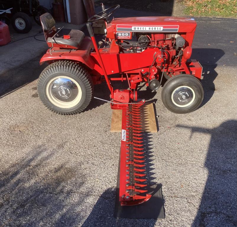

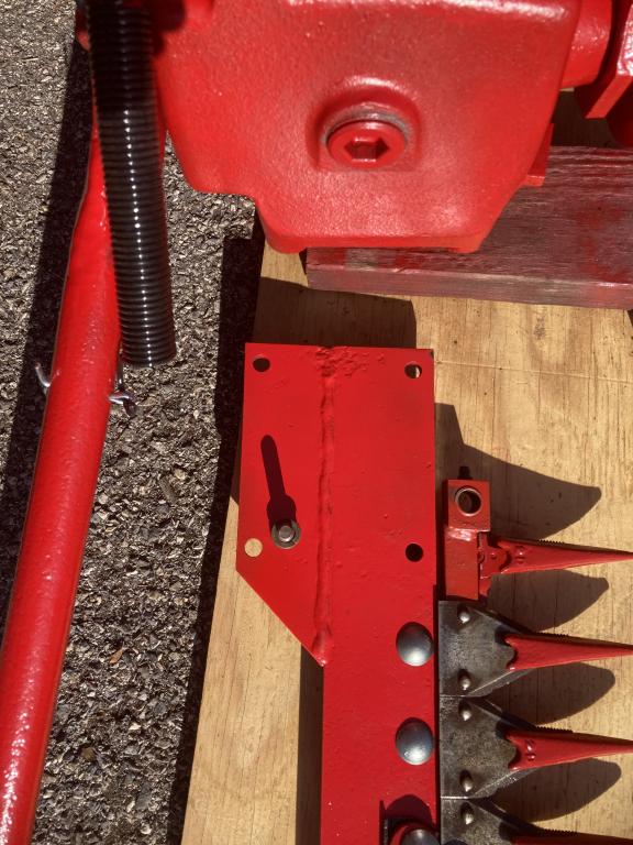

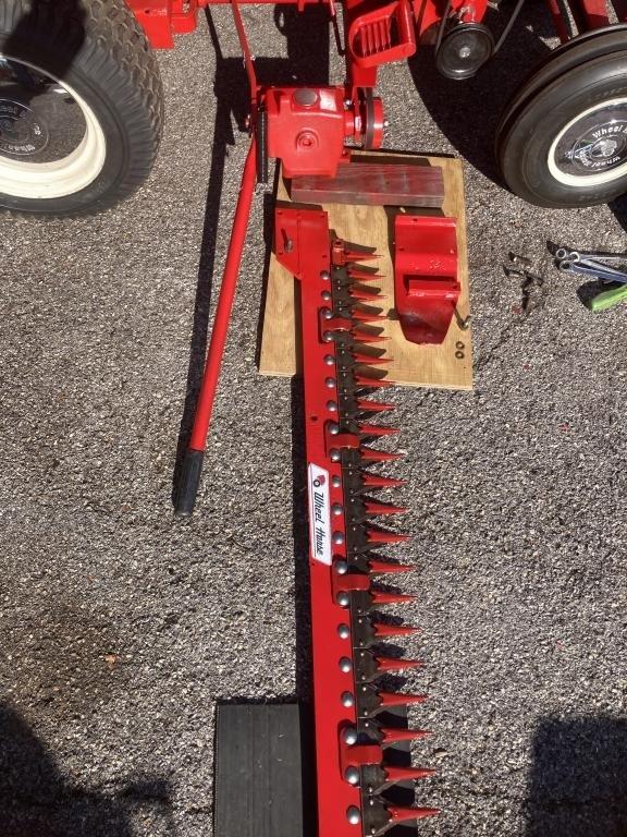

"Manic-Mechanic" 1,485 #37 Posted November 24, 2025 (edited) Here is the sequence for mounting the bar All laid out Preparing to install the hidden bolt, using Blue locktite Inserting the adjacent bolt temporarily to get aligned, leveled enough to get a few threads in on the hidden bolt. Once those are fitted the hidden bolt is tightened and temporary removed. Shoe weldment gets attached and tightened Attached the section bar and make sure everything is aligned and the pin “good & tight!” Waiting on a 5” longer travel hook as this is an unorthodox install! Edited November 25, 2025 by "Manic-Mechanic" Share this post Link to post Share on other sites

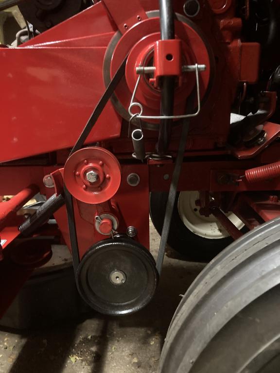

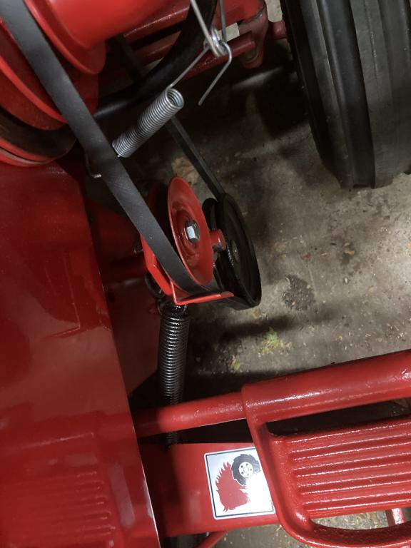

peter lena 9,785 #38 Posted November 25, 2025 @Manicmacanic like the ease of function , very good job on that , that belt bounce is telling you of a related issue , an idler pulley pushing / pulled from the front side , with a spring mount set up would really ENHANCE that function . did that to all my mower decks on the back side of belt return , that also helps any related bearing that is incrementally hit with a bounce . only a suggestion , NOTHING SARCASTIC about it . or intended . would have to see related areas for bolt on / weld set up . that would be a flat idler pulley to push against the belt . paint it red , only you would know , pete 1 Share this post Link to post Share on other sites
"Manic-Mechanic" 1,485 #39 Posted November 25, 2025 1 minute ago, peter lena said: @Manicmacanic like the ease of function , very good job on that , that belt bounce is telling you of a related issue , an idler pulley pushing / pulled from the front side , with a spring mount set up would really ENHANCE that function . did that to all my mower decks on the back side of belt return , that also helps any related bearing that is incrementally hit with a bounce . only a suggestion , NOTHING SARCASTIC about it . or intended . would have to see related areas for bolt on / weld set up . that would be a flat idler pulley to push against the belt . paint it red , only you would know , pete The sickle was not lowered all the way down, once lowered the belt tightens off a spring on the existing idler. However, should such a bounce be irritating, I have a nice flat idler just waiting to roll! 1 Share this post Link to post Share on other sites
peter lena 9,785 #40 Posted November 25, 2025 @Manicmacanic like the ease of function , very good job on that , that belt bounce is telling you of a related issue , an idler pulley pushing / pulled from the front side , with a spring mount set up would really ENHANCE that function . did that to all my mower decks on the back side of belt return , that also helps any related bearing that is incrementally hit with a bounce . only a suggestion , NOTHING SARCASTIC about it . or intended . would have to see related areas for bolt on / weld set up . that would be a flat idler pulley to push against the belt . paint it red , only you would know , pete Share this post Link to post Share on other sites
peter lena 9,785 #41 Posted November 25, 2025 @Manicmacanic good for you ! was just looking at related parts https://www.google.com/search?q=%2C+idler+pulley+bolt+on+spindle&rlz=1C1CHBF_enUS866US866&oq=%2C+idler+pulley++bolt+on+spindle&gs_lcrp=EgZjaHJv , glad for your plANNED FIX , PETE 1 Share this post Link to post Share on other sites
"Manic-Mechanic" 1,485 #42 Posted November 25, 2025 21 minutes ago, peter lena said: @Manicmacanic good for you ! was just looking at related parts https://www.google.com/search?q=%2C+idler+pulley+bolt+on+spindle&rlz=1C1CHBF_enUS866US866&oq=%2C+idler+pulley++bolt+on+spindle&gs_lcrp=EgZjaHJv , glad for your plANNED FIX , PETE That’s fine, but a flat pulley would be best. I can take a second video and set it low, watch for the bounce and plan accordingly 1 Share this post Link to post Share on other sites
peter lena 9,785 #43 Posted November 25, 2025 @Manicmacanic you just said it , this is something I regularly do on a repetitive issue , might be a related part , or lever / linkage set up . do a lot of roller stool watching on problems . your first shot of ease of pto lever engagement , pulled me right in , thats how my levers work , might even be an angular bolt on pulley mount , for bolt mount near by , figure what you need for pulley mount , has to be adjustable for tension . or spring control , when you start thinking like this , opportunities suddenly appear . glad for you . pete Share this post Link to post Share on other sites
"Manic-Mechanic" 1,485 #44 Posted November 25, 2025 56 minutes ago, peter lena said: @Manicmacanic you just said it , this is something I regularly do on a repetitive issue , might be a related part , or lever / linkage set up . do a lot of roller stool watching on problems . your first shot of ease of pto lever engagement , pulled me right in , thats how my levers work , might even be an angular bolt on pulley mount , for bolt mount near by , figure what you need for pulley mount , has to be adjustable for tension . or spring control , when you start thinking like this , opportunities suddenly appear . glad for you . pete Yes, it’s a continuous process isn’t it… I did re-examine the idler tension spring, it was insufficient! See the replacement is good & tight! The added light duty spring clip to clip The over-all result is excellent! 1 Share this post Link to post Share on other sites
peter lena 9,785 #45 Posted November 25, 2025 @Manicmacanic your pictures say it all ! the added spring to the pto swing mount , hitch pin clip . and a lot of this is simple , its the look at of what's going on , and making little changes to failures . the other thing i did was , remove the pto brake pad , did that after my lucas re greasing , that entire pto set up spins smoothly / and silently . also removed drag to the cone area . cleaned out the cone inner needle bearing , lucas green grease 550 deg flash point , this one of the gold mine areas , I often refer to for improvement , been bombproof for me , thanks for trying this out , pete 1 Share this post Link to post Share on other sites
"Manic-Mechanic" 1,485 #46 Posted November 25, 2025 16 minutes ago, peter lena said: @Manicmacanic your pictures say it all ! the added spring to the pto swing mount , hitch pin clip . and a lot of this is simple , its the look at of what's going on , and making little changes to failures . the other thing i did was , remove the pto brake pad , did that after my lucas re greasing , that entire pto set up spins smoothly / and silently . also removed drag to the cone area . cleaned out the cone inner needle bearing , lucas green grease 550 deg flash point , this one of the gold mine areas , I often refer to for improvement , been bombproof for me , thanks for trying this out , pete I did use a high heat, super dark grease and did clean, repack the needle bearing. Also take notice that cone clutch is the earlier model with a later stub shaft. After the initial test to the assembly, I removed the cone pulley and wiped away any residual grease, definitely don’t want that on the clutch! See the brake shoe is set lower, beneath the brkt. The shoe is set way out and I buffed the paint off the pulley edge so no drag at all. We’ll see how well it performs next video… 1 Share this post Link to post Share on other sites
