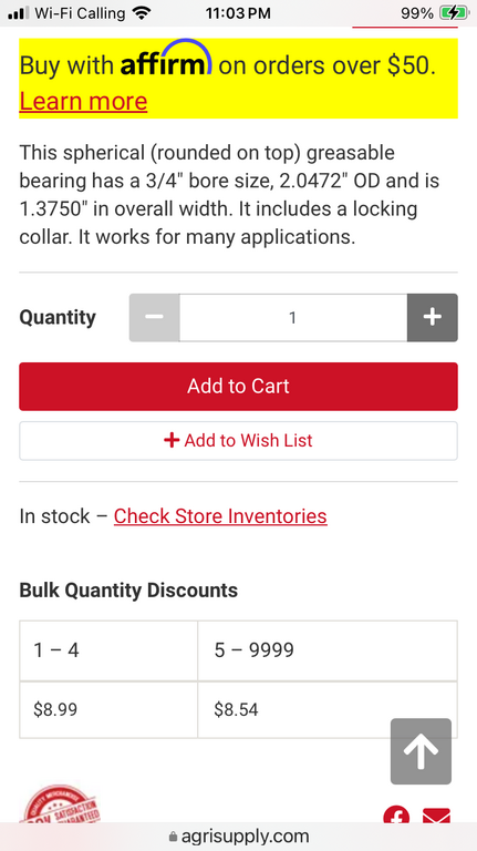

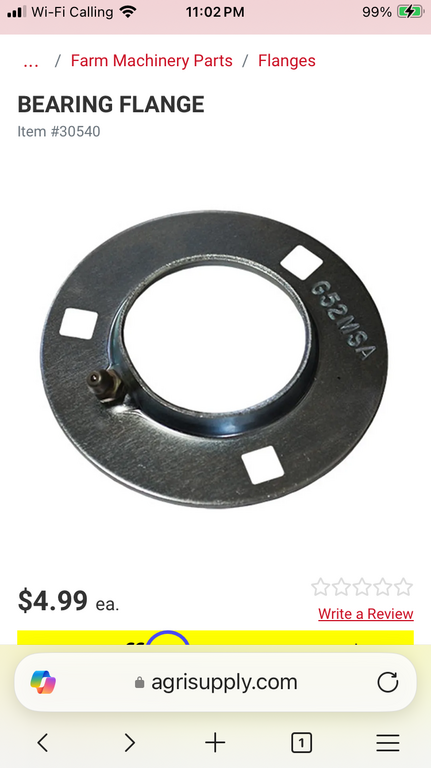

Here is some enlightening news.
grease-able spherical bearing in 3/4 bore and 52mm od.
3 hole 52mm flange with grease fitting

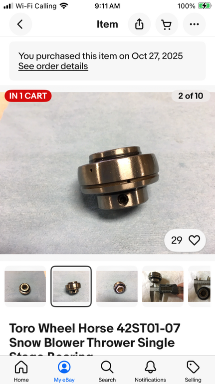

There’s some with set screws on eBay for 32.99 ea. I may try cancel part of my order and get these.
6-32, only very thin material!

Thought about what ri702bill said and I did get the better bearings ordered, not wanting any issues out of the ordinary!:eusa-think:
