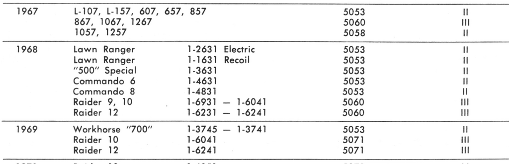

Handy Don 17,400 #55 Posted May 5 (edited) 1 hour ago, 702854boy said: Wouldn't the 1067 and 1267 have had a 6 speed? Yes 1 hour ago, kpinnc said: And Raiders up to 14hp. Nope. Only to 12 with Unidrive My 1973 Bronco (hydrostatic) still had the 10 pinion differential originally. 6-speeds had LSD, but not all LSDs were in 6-speeds I thought the 1973-1974 period was when the heavy differentials were introduced? Not clear to me. By “heavy” do you mean 8-pinion (vs. 10-pinion in the LSD)? Maybe my question should be what exactly is a 6 speed vs an 8 speed? I know the brake drum orientation changed at some point but did the differential change coincide with this? 6-speed has 1-2-3-R, Hi-Lo, brake drum close to rear axle & clockwise rotation (forward), and LSD. 8-speed (apparently from 1970) moved the brake drum and dropped the LSD (and added dipstick?) And I also thought all trannies with high/low had 5/8 input shafts? I think you are correct here. Length, though, I’m not sure. Apologies. Here’s the info from the Unidrive Repair Manual. “III” indicates 6-speed version (5060 and 5071); “II” indicate 3-speed (5053 & 5058) The Raider 10 & 12 did use 6-speed in ’68 & ‘69 No 6-speeds after 1969 Clearly my memory has gotten fuzzy on the input shaft lengths and diameters. Edited May 5 by Handy Don 1 Share this post Link to post Share on other sites

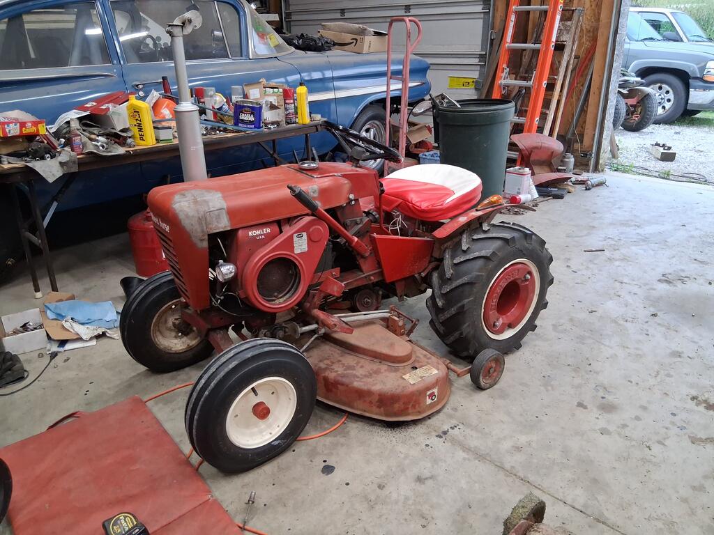

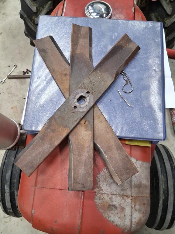

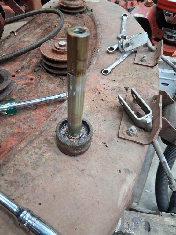

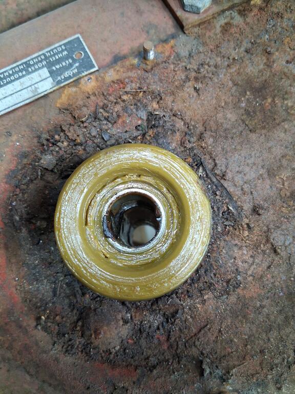

702854boy 1,132 #67 Posted August 2 Spent the last few days making my tractor more Wisconsin. Now I need to get it some cheese curds. I put the wheelweights I bought from @WHX?? at the show on and went through the RM-425 deck I got from @Achto and put it on too. This deck was the nicest deck I've ever gone though so far. None of the bearings were seized and all of the grease looked good but I still cleaned it up and put some fresh Lucas green in it. The nla double-d blades looked like they had either never been sharpened or sharpened very little. 1 6 Share this post Link to post Share on other sites
